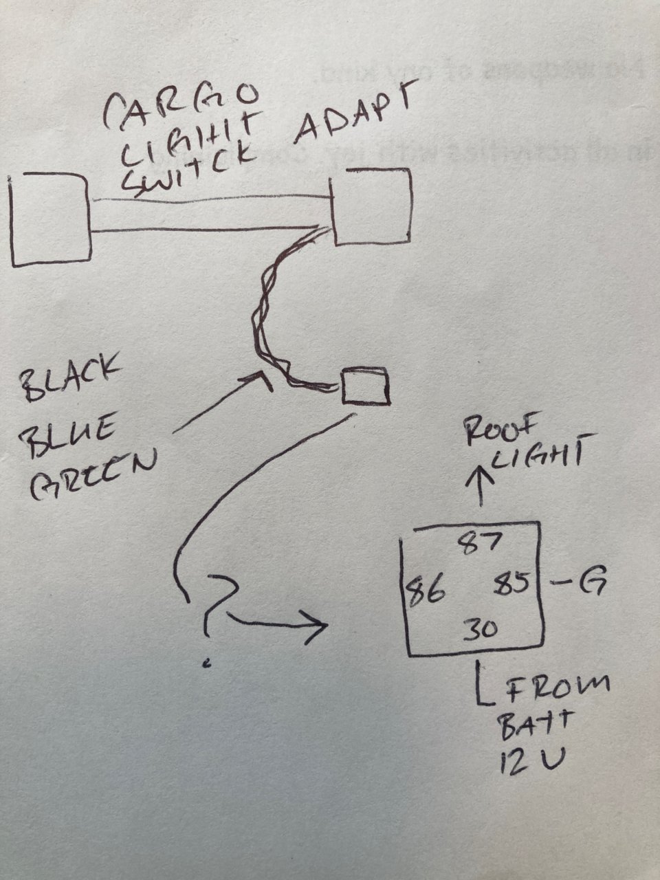

    I understood the cargo to be ground switched not power switched? But I may be wrong on that? So it'd go to 85 and 86 would tie to 30.

    ok that does help. I see the little relay that comes with his adaptor to have the cargo switch and also the CH4x4 switch converts the switching.
    I guess a prewired harness would have been easier... but when you have a bunch of spare wire and some relays.... tried to save some cash lol

    I've been told a bunch, caribe would give you the deets, I think/thought purple was the one to use? Don't think you need another switch, just power and then ground for the lights somewhere. Could use the trailer brake controller for clean fused power at that spot, the tacoma brake controller pigtails are cheap.
