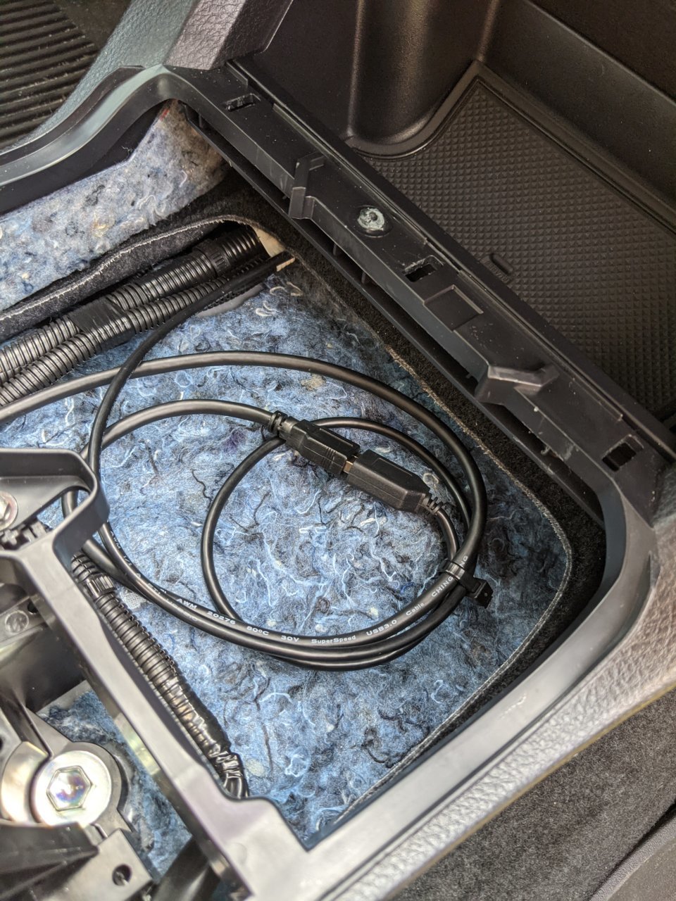

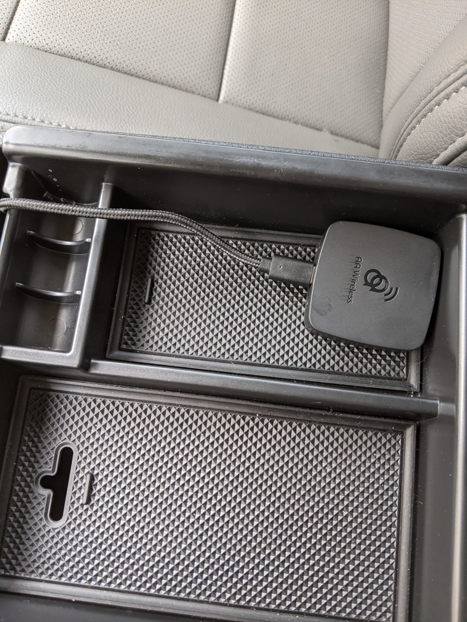

    I already ordered a usb extension cable and plan on relocating my 'media' usb Port from the dash to the centerconsole where the AAWireless device will stay connected.

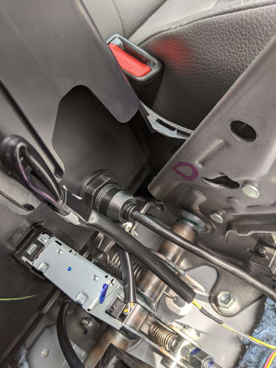

    Still waiting on mine. I got the parts to re-route into the glove box. I should have 2 free switch blanks for seat warmers next year.

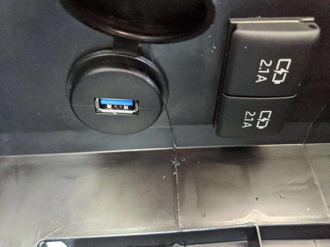

    Are you using a usb extender and just pushing the current plug behind the dash, or did you buy the new radio cable from aliexpress?
    I have both options, but the media port switch is a non standard size so I think I'm going to just use the new radio cable and leave the existing usb port in the dash since nothing else fits there.

    I got a cable from aliexpress. I haven't made sure it fits yet. I got a new switch panel from Meso and also removed the cigarette lighter.

    I also rerouted the Audio Input USB to my Center Console. Really liking the whole setup so far.

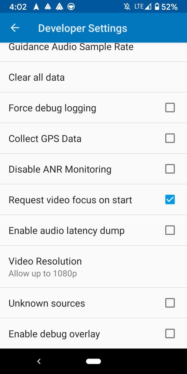

    Where do you set AA to autolaunch? The first time I setup and connected AAWireless it did automatically start up AA on the radio, but since then it doesn't. If I'm in the Menu I see the Projection button turn to Android Auto like it does when you plug it in, but doesn't autolaunch either when I plug in direct or through AAW. Right now as I said I like to just use BT normally, so I kind of prefer it that way, but if I want to change that in the future would be good to know where the setting is. Not even sure if it is on the radio or phone!

    It's in the developer settings for Android Auto on your phones app.
