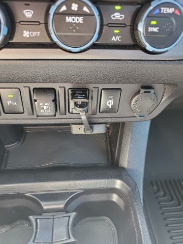

    How are you guys mounting this? I had it originally like the below picture the problem is that it kept falling off in the Winter (-20F temps) when I was using some 3m tape and then I replaced that with some velcro I had laying around and that fell off in the summer (95F+). So need something that holds up to cold and heat - I flippin hate this state.

    I rerouted my media port to my center console. See post #34.

    Just buy some of that heavy duty double sided tape from gorilla glue. The stuff is insanely sticky. Make sure do use an alcohol wipe before applying it
