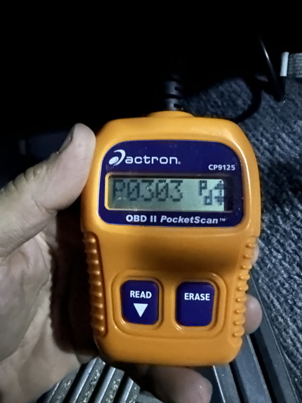

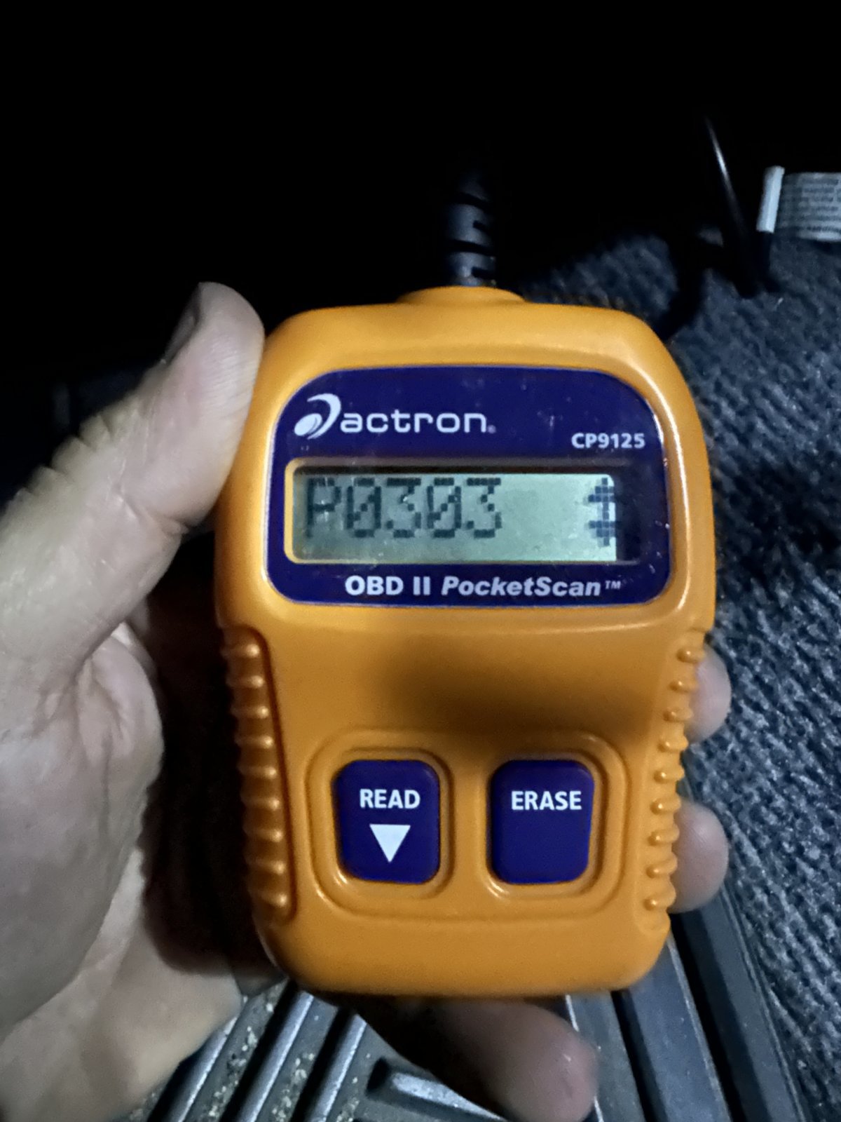

  19. Dec 8, 2023 at 7:25 PM
    #19
    98_3RZ_NIC
    98_3RZ_NIC [OP] Well-Known Member
    Jan 17, 2021
    #353073
    1,686
    1998 white extended cab
    Bilstein 5100’s with ome 881 coils on lowest setting, JBA upper control arms, LCE header, 31x10.5x15 falken wildpeaks.
    okay sounds good. This is what I got when I plugged in.
  20. Dec 9, 2023 at 5:53 AM
    #20
    joba27n
    joba27n YotaWerx Authorized tuner
    May 27, 2021
    #366948
    1,138
    Nolan
    Alberta
    2021 Gray TRD Sport Tacoma MT
    YotaWerx Stage 1, Bumper light bar, Hood wrap, Roadmaster Active Suspension, Durobumps.
    Cylinder 3 misfire, could be alot of things but given the circumstance of lot compression on 3 it's most likely a mechanical engine fault
