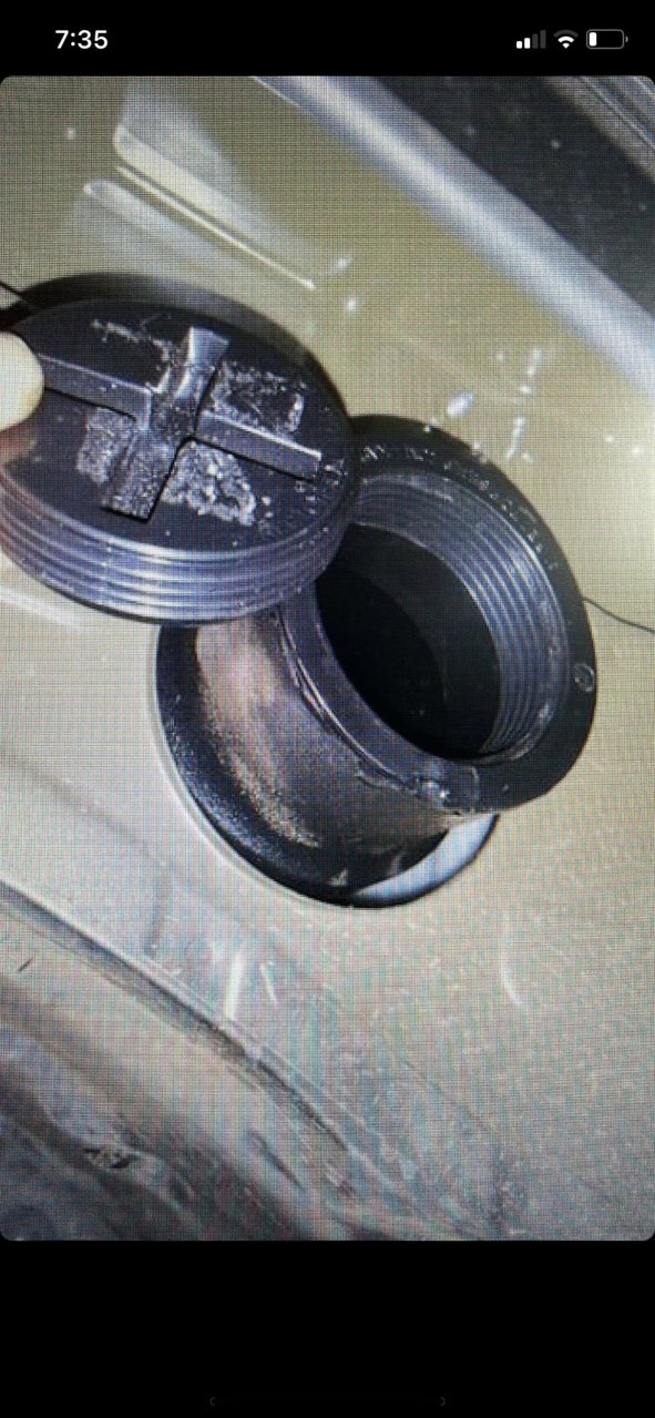

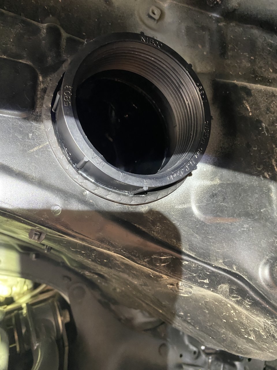

    Ok so I attached a picture. I’m having trouble finding this part Home Depot has similar but not exact. If someone can help point me in the right direction. I’m trying to do this so I can screw in that center cap when off-roading and or going through water.
    Thanks TacomaWorld

    Perhaps this:
    upload_2022-8-26_21-52-46.jpg?

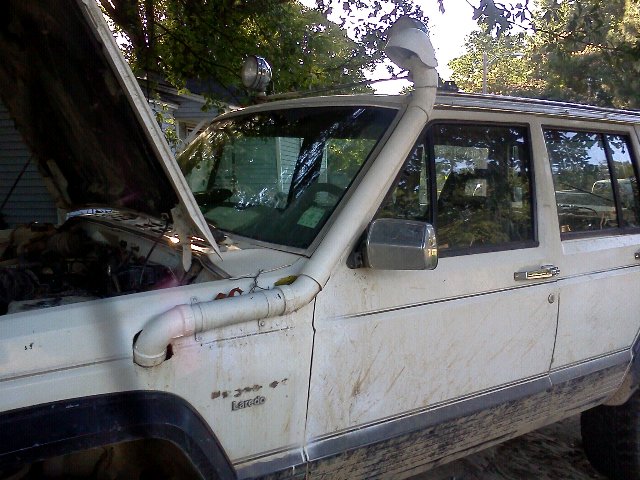

    If you want to make it a DIY project, you’ll need a dorkel to go through water.3BBE95F1-34AF-410E-8011-EFE2ADC9422E.jpg

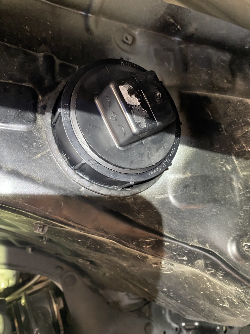

    Completed

    No issues I’m always monitoring coolant temp also. I will be plugging that part of the intake when following multiple people and eating dust and or in wet conditions stream crossings etc. look into the injen air intake(it sucks air from behind the radiator as well as the normal oem location) . Super useful mod if you get rid of your fender liners
    Coolant thermostat opens 187-194°F
    Normal coolant temperature 167 to 212°F
    Max coolant temp is 284°F

    My solution was a snorkel with a precleaner.
