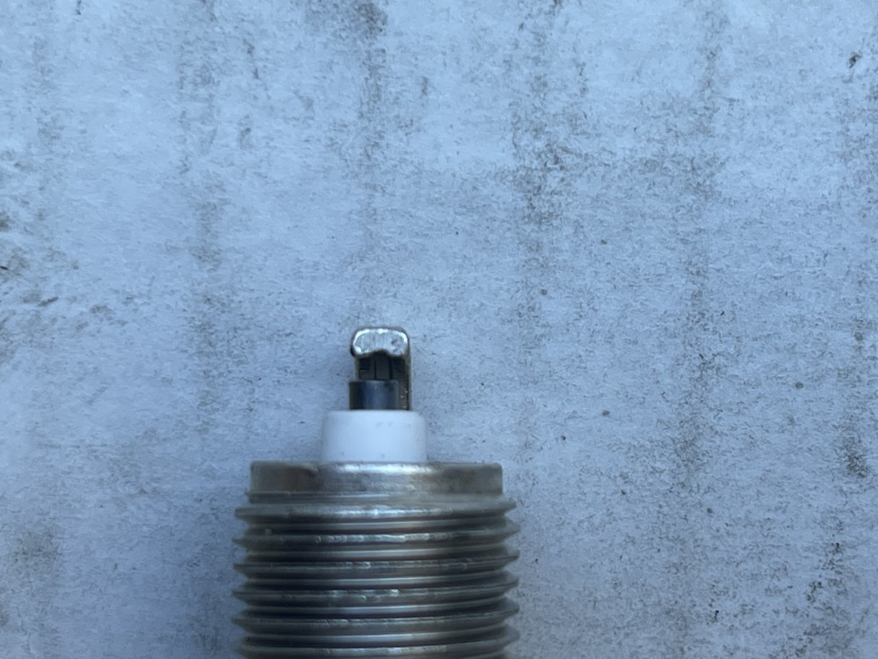

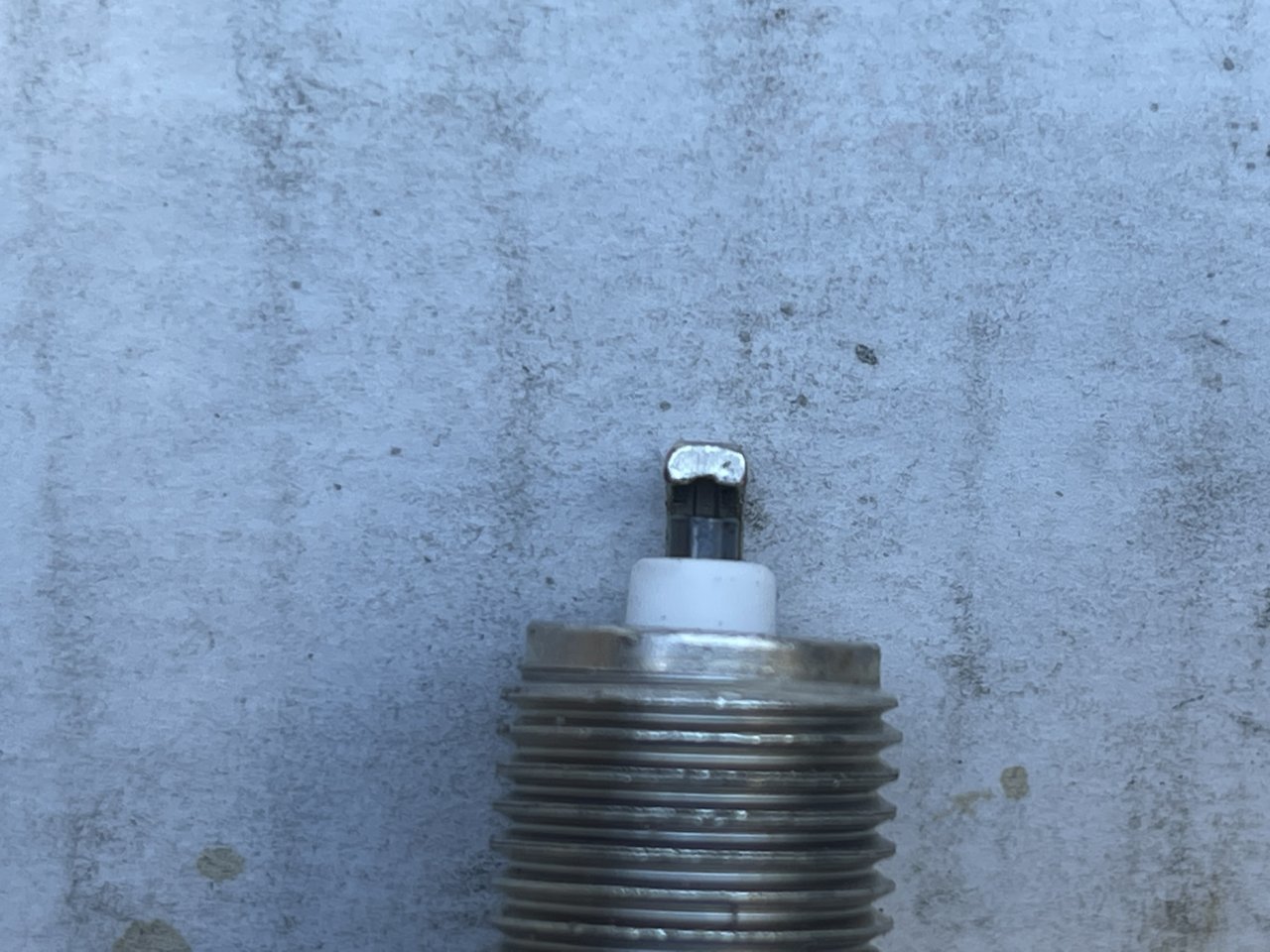

    Do the plugs yourself, simple except for one, driver side rear. Confirm the gaps are correct on the new ones 039-044. I like to get the hook perfectly centered also.

    Added a couple pictures. One showing fresh out of the box new and off center. Then after getting it centered and gapped.
