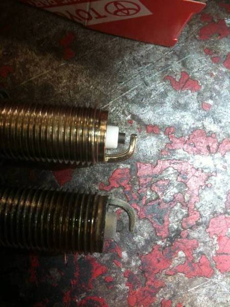

    I change mine every 30K. Just did them on my 4Runner on Saturday. Put the factory Denso's back in, got all 6 of them from the dealer for $22 (employee discount).
    Had NGK's in them from the last tune up I did at 60K.
    Here's how they looked.
