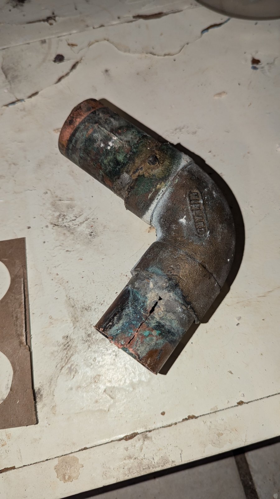

    You should leave the section of pipe you cut out inside the wall, so that the next guy will understand "why". I don't know if it's possible, but maybe the original fitting was a bad casting? Maybe an air pocket in that spot (if such a thing can happen)??

    I believe you are correct. Probably quite thin there to start.

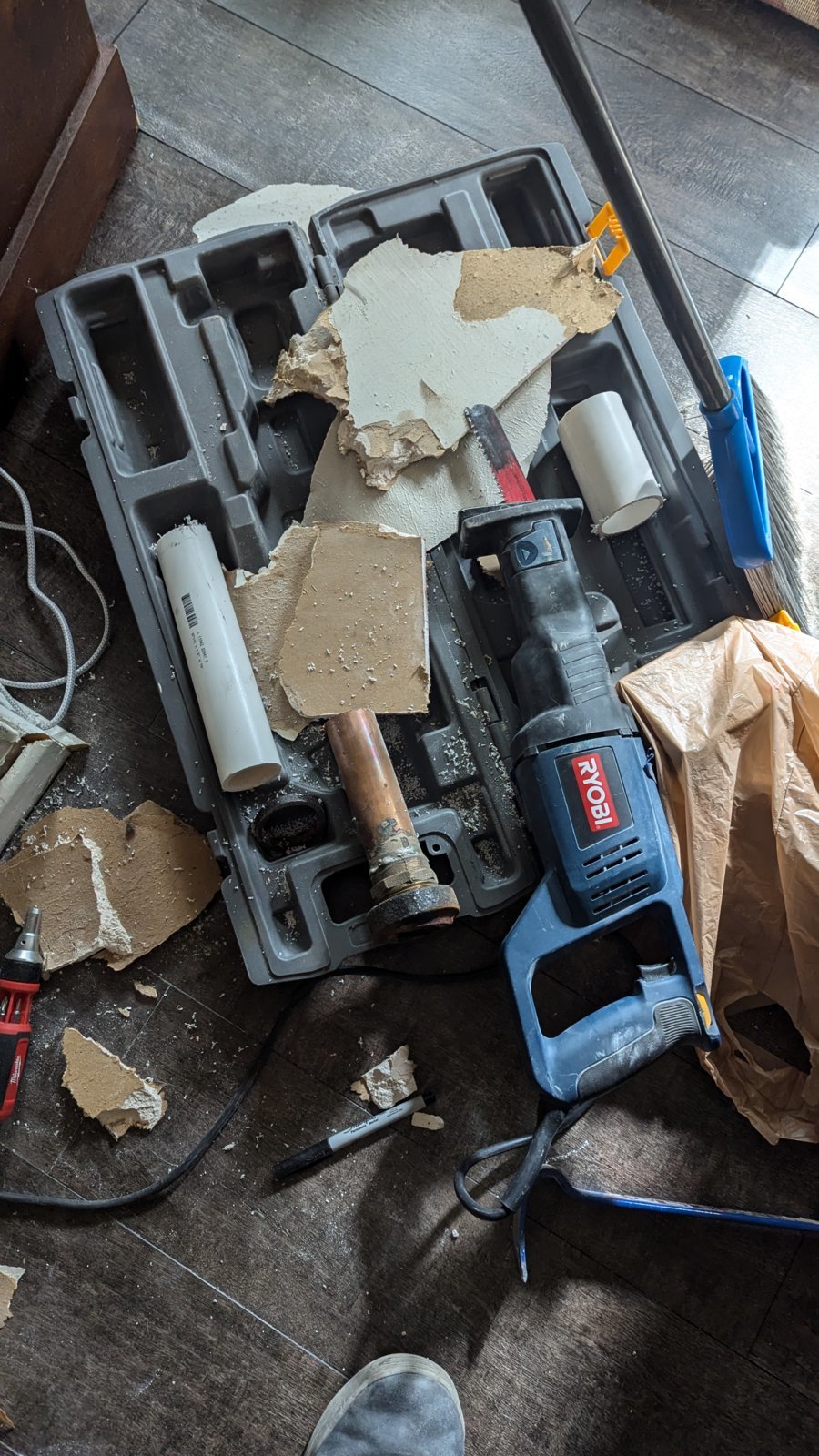

    @Rock Lobster ... How did you end up cutting the pipe? Did you buy (or rent) the expensive tool? Or did you find another way? It appears that your cuts are pretty clean, so I'm thinking you probably used the special tool?

    Nope. Just my big ugly discount saw, a new carbide blade, and a tall pour to steady the hand. :cookiemonster:

    If it was my place, I would take a close look at the copper. Whomever sweated them didn’t know what they were doing. And is the leak(trail of green/blue corrosion) from a joint or in the middle of the pipe?

    IMHO, it looks like a power drain router cable cut that channel. It appears somebody really went to town and spent some quality time to get that amount of material removed! :D :D :D

    Wow... you did a good job! Must have been the "tall pour"... :cheers:

    those carbide blades are no joke. diablo also makes a cast iron carbide blade that cuts a little longer than that, but not much better.

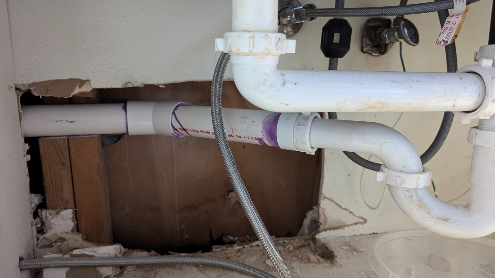

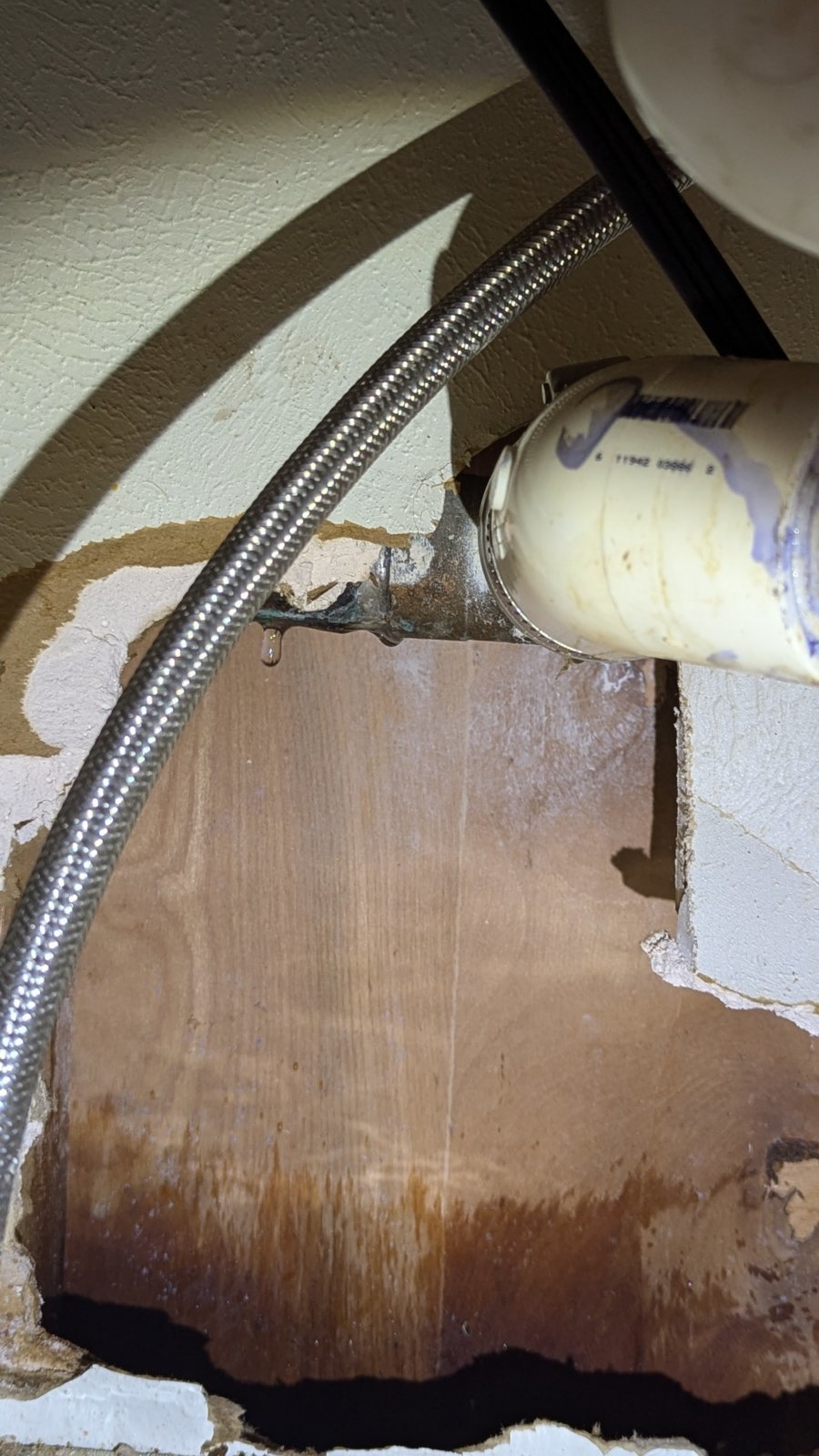

    The drama continues. The wife reports that a part of the living room is continuing to be squishy.
    "Damnit woman! Stop noticing things!" I holler.
    Back to troubleshooting phase. Another leak appears.
    The holy fuck? Someone in this house needs a reminder to not put chainsaws down the disposal. :confused::confused::confused:
    This is stupid anyway. Who in the hell has a copper drain pipe?
    "Save that. Imma goin to make a wind chime." - wife.
    Screw that inch and a quarter copper. I'm shoving the longest 1.5 down the wall that I can fit, and I don't care if it begs me to back out. The more it resists, the harder I hit it with the mallet.
    Oh yeah, take that good slathering of dope, it'll make the insertion easier.
    I really didn't like where this union ended up, but this literally was the longest I could possibly make that pipe without taking out the cabinets (note the scrape marks on the far wall), and the 2" isn't clearing another compromised stud.
    Well shit. I guess drywall repair starts tomorrow instead. :oops:
    wilcam47 and MGMDesertTaco like this.

    that almost looks like it froze and burst. but doesn't make sense as a drain line-- drains are never full enough for the water to freeze and expand enough
    my first thought at seeing the uprights coming out of the ground that have multiple couplings in them is the same thing. looks like a patch job. either the sink was moved around, or there was a freeze and break. but both pipes being cut roughly in the same spots would indicate a more likely chance that it was a previous remodel.
    copper drain pipes can be commonplace, depending on the local codes. the richer side of the city with the retired bankers and previous hedge fund managers, those cities require cast or copper for all drain lines, and will fail pvc anywhere in the system...

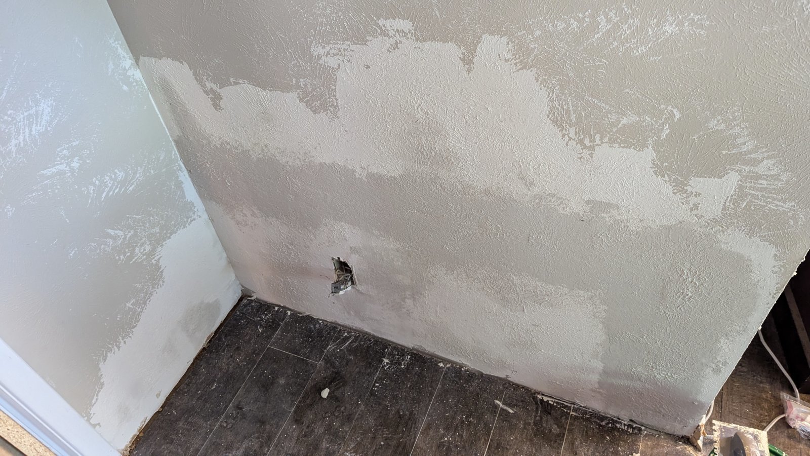

    After 20 years of very obvious blemishes, I finally stumbled across the perfect ingredient for seamlessly blending wall texture.
    The secret is four beers. No more, no less. :drunk::homer::homer:
