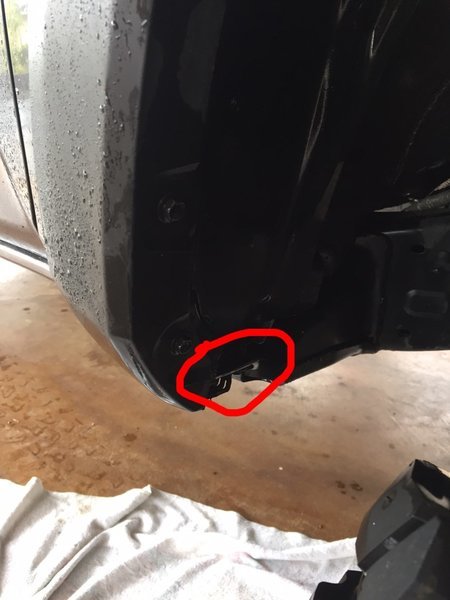

    Nice man, quick question. Im working on trimming in the rear of the front fenderwheel and trying to figure out the best way to go about it. I noticed you cut some of the plastic in the fenderwell. What about the metal below the pinch weld that was under the plastic? I couldnt tell from pics

    If I have time I'll get you a pic but I removed the wheels, took a 10lb sledge hammer and pounded it in so it sits flat now. Some people cut the pinch weld but end up getting leaks so I wouldn't recommend it. Be ready for a work out though, shit wasn't easy.

    Ok mahalo man. What about the metal that is perpendicular to the pinch weld below it. Its where the black fender attaches to at the bottom

    Chop that shit. Cut the entire corner including bottom bolt. It won't affect anything.

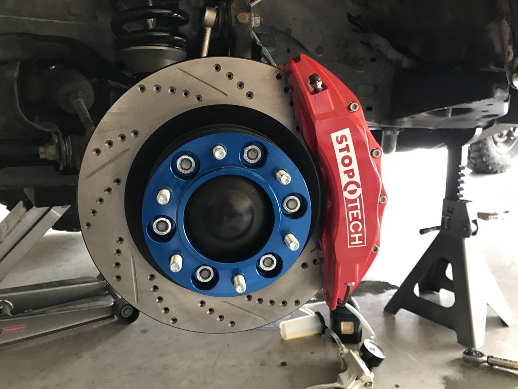

    Finally got a chance to work on my truck a bit. Added some goods.
    StopTech BBK Kit w/Spidertrax 1.25" spacers
    4C460AF1-C0C6-4992-AA40-893F48D81D6E_zps_88bac5ab9f4aed5780b82052ee143a6a5c85e3bd.jpg
    92FA5362-6EF2-4E9D-9680-7A1468DA9CC0_zps_a0b8451a0c2290b651592a0b1c57360095ac2629.jpg

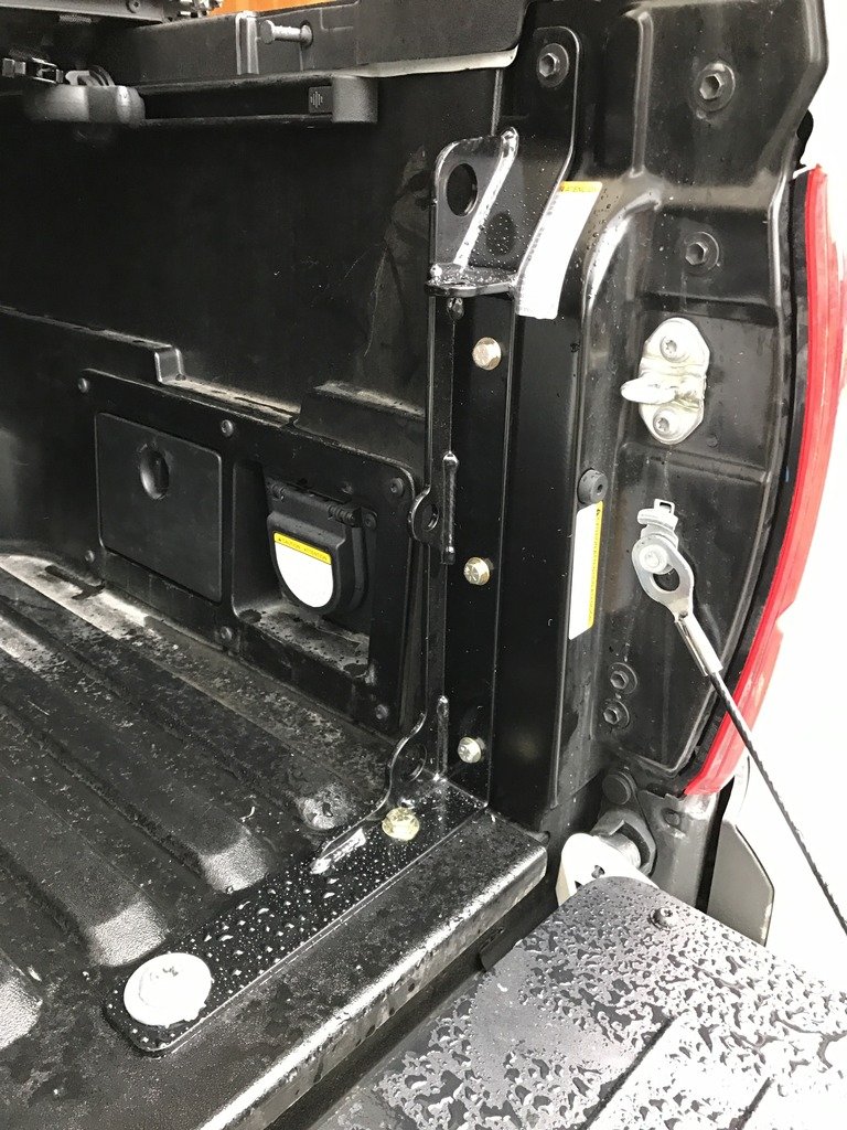

    Total Chaos bed stiffeners
    11809777-BA04-4C8D-AC3C-B5CEF6B6DBAE_zps_f68ef62fa52f8797d00169c169592cfe7b7a767c.jpg

    I had Wilwoods on my car most people don't realize the stopping power of a good brake kit .

    Definitely a nice upgrade.
