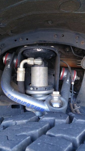

    0202161553.jpg I got same set up Im running 295/70R/17 we had to crank down on the Coilovers to get them in there. The ride is stiff but it is level and like you said it lifted the rear up a lot more than planned.

    That's way too much. Maximum recommended by Fox I believe is 1.75" or 2" of preload or you'll cause binding of the coils. You'll probably need to upgrade to a longer spring to decrease the preload.

    I was thinking it was a little to much so my Mechanic went a little to far to try and level trk. When my new hub bearings get in guess we will be lowering it down a bit.
