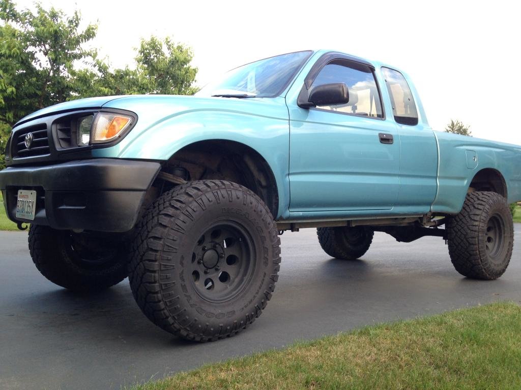

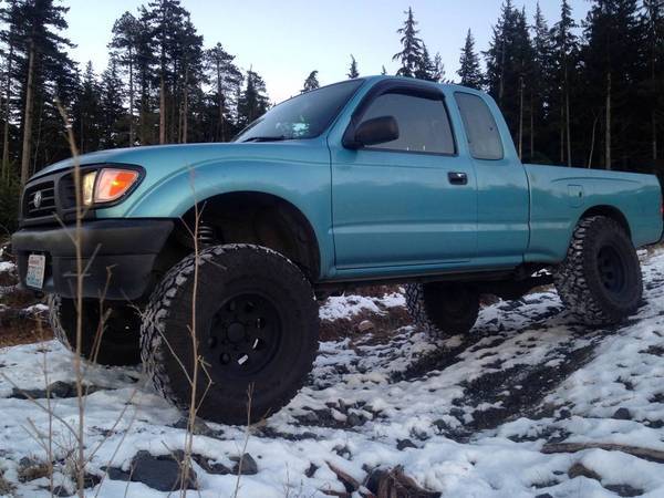

    Hey all.

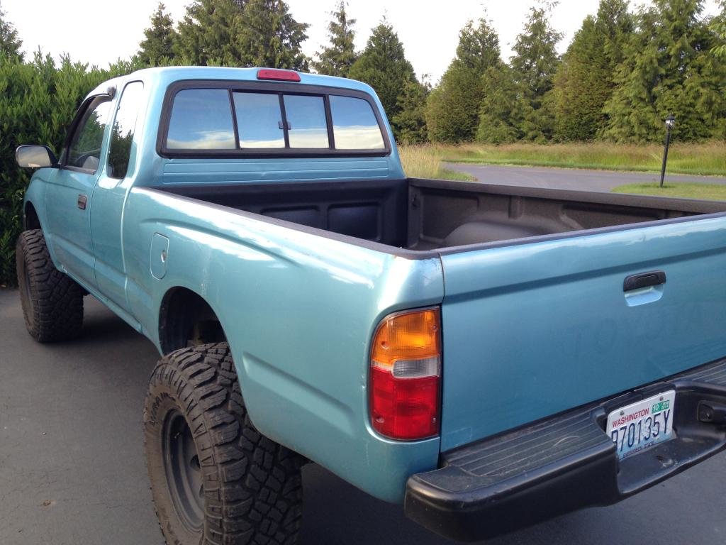

    Here it is right after i bought it, bone stock.

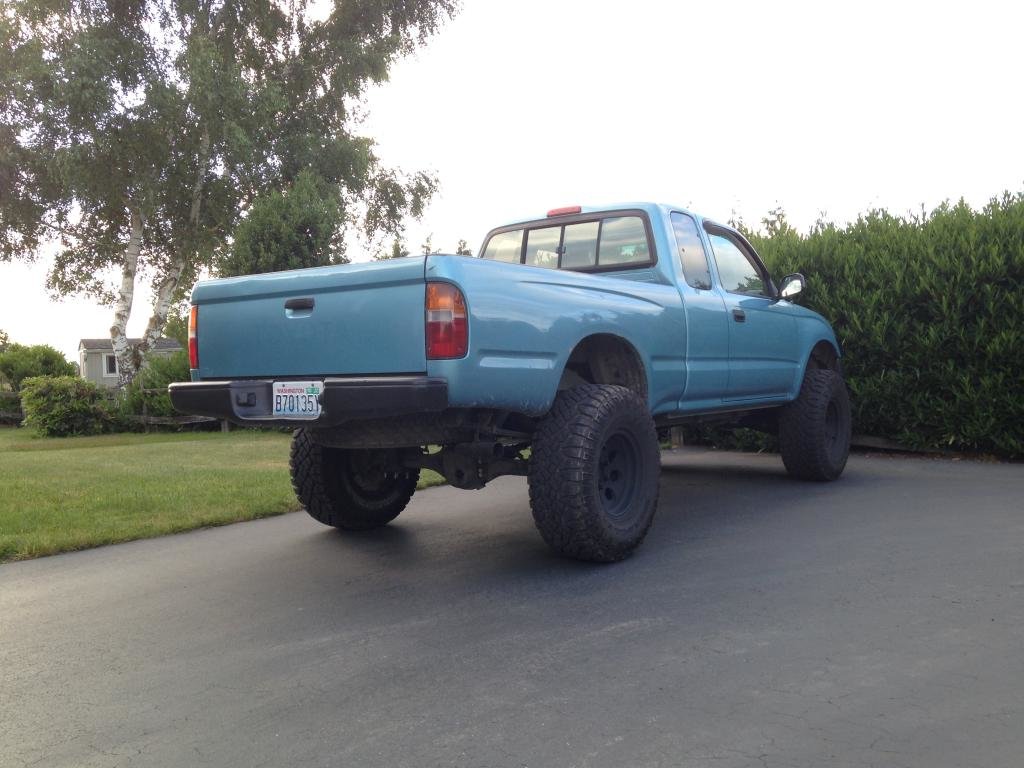

    I decided to go with a Tough Country 3'' lift/leveling kit.

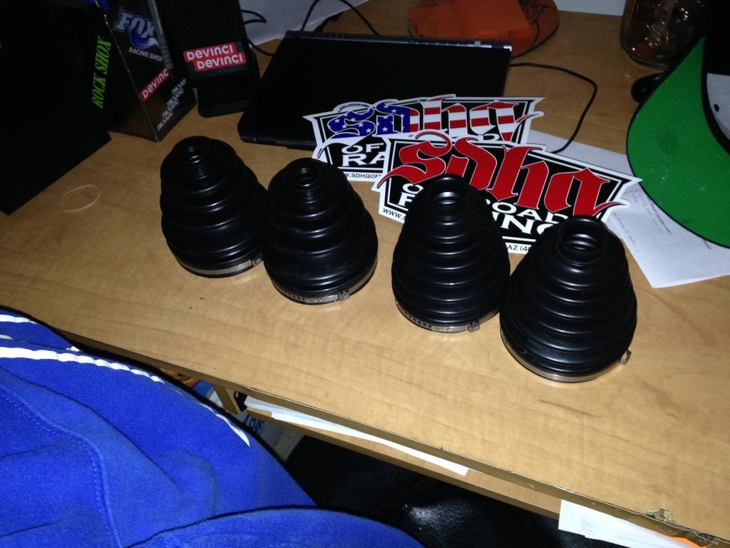

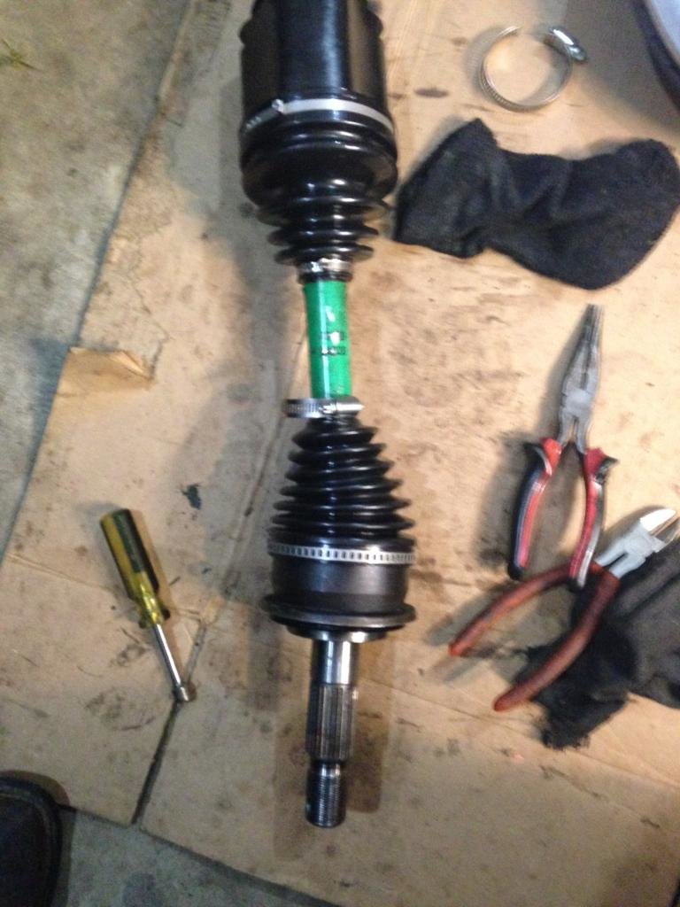

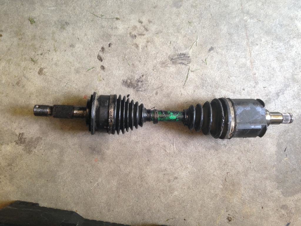

    After the lift, I noticed that the CV boots blew out, so After a bit of research, I got some bates 930 style Porcshe boots from SHDQ. The kit was 60$ and included the inner and outer boots. I used a tube of generic CV grease, and a half tube of some hi-temp grease i had laying around.
    7439D122-24A0-4EE5-AECF-B19D7876447E_zps_4683d40f0d366b378990f14a32117eb8549ccaf5.jpg
    D78D6E85-968F-4420-BC45-EC97C133BF97_zps_22c46e8ff3e8c80aeb67b0a235d92da2c1f6725c.jpg
    before
    209EC9A3-CD93-4CC7-B49E-E28682BA5111_zps_193385b4d4d963fe17008c29608234fa232c4fc9.jpg
    after
    F2125DAB-20A3-40CB-A7DA-2D3CA866DF07_zps_95475a7e2de6e15c9986e7bf0a3ec5ded9029828.jpg
    also replaced leaky inner axle seal on pass. side.

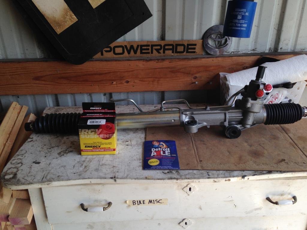

    Due to the lift a steeper angle was put on the outer tie rods which in turn put excessive strain on the inner tie rods/steering rack assembly causing the part to fail. I bought a new rack from Detroit Axle with a lifetime warranty for about $220 before the core refund of 25$ so not bad compared to the OEM rack. I went cheap because someday i may want to SAS so i did not see the point of a nice new Toyota rack that would slowly be destroyed like the last one. I also got new polyurethane front rack bushings from Summit for $15
    *UPDATE 3/26/2017 I have gone through one rack so far already but the part failed quickly due to the front struts being in their highest lift position possible (3"). Since I've lowered the struts to their lowest lift position the rack has been fine.

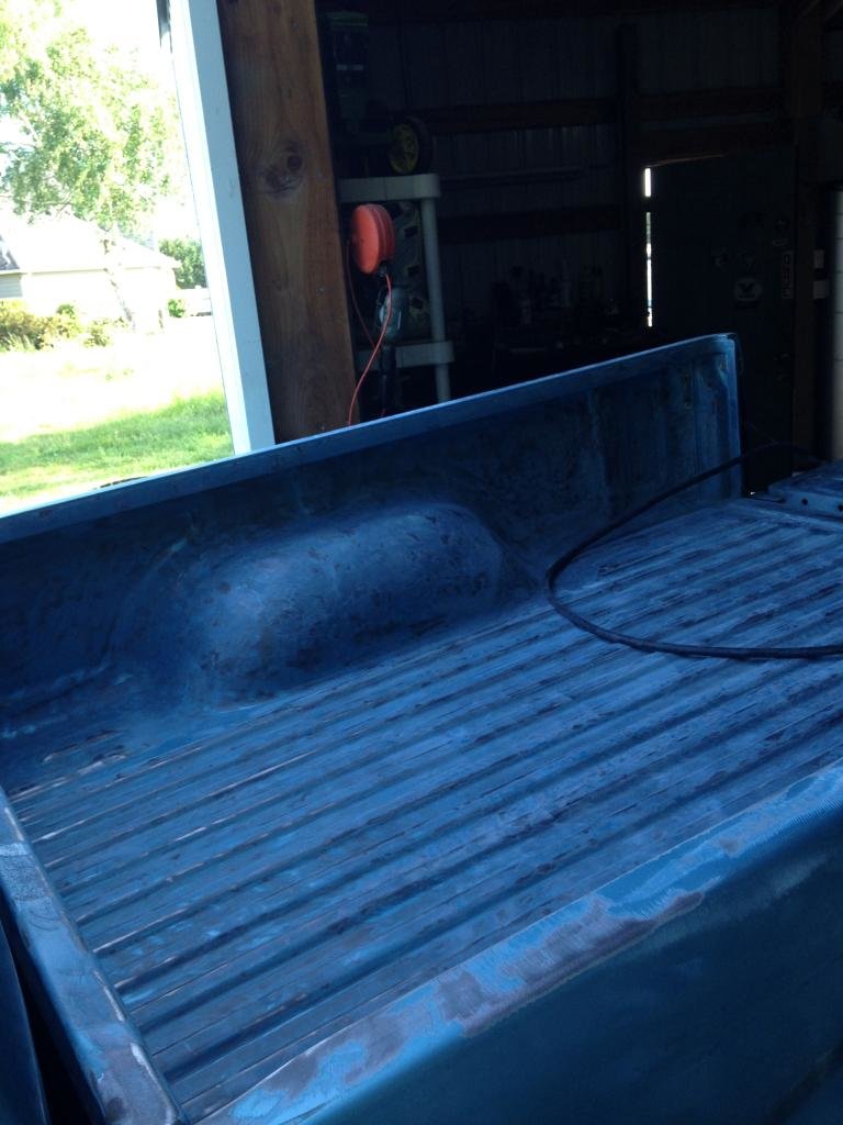

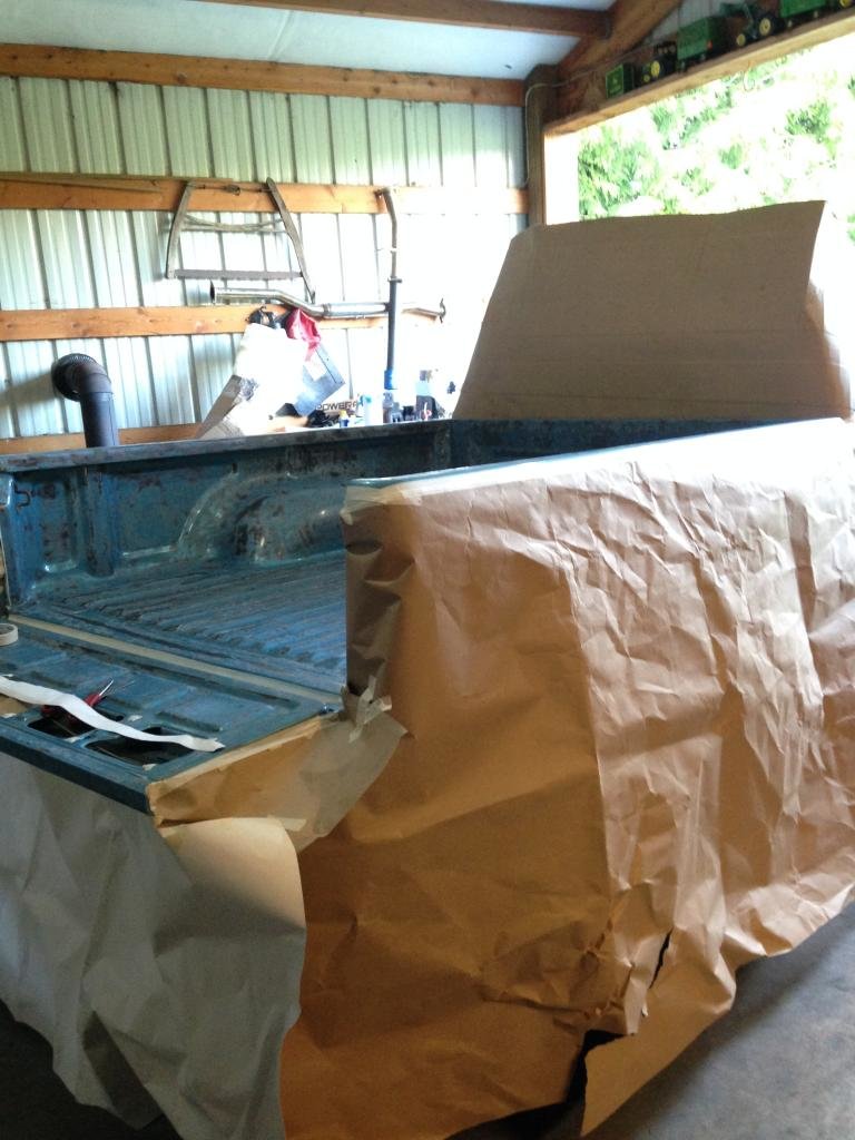

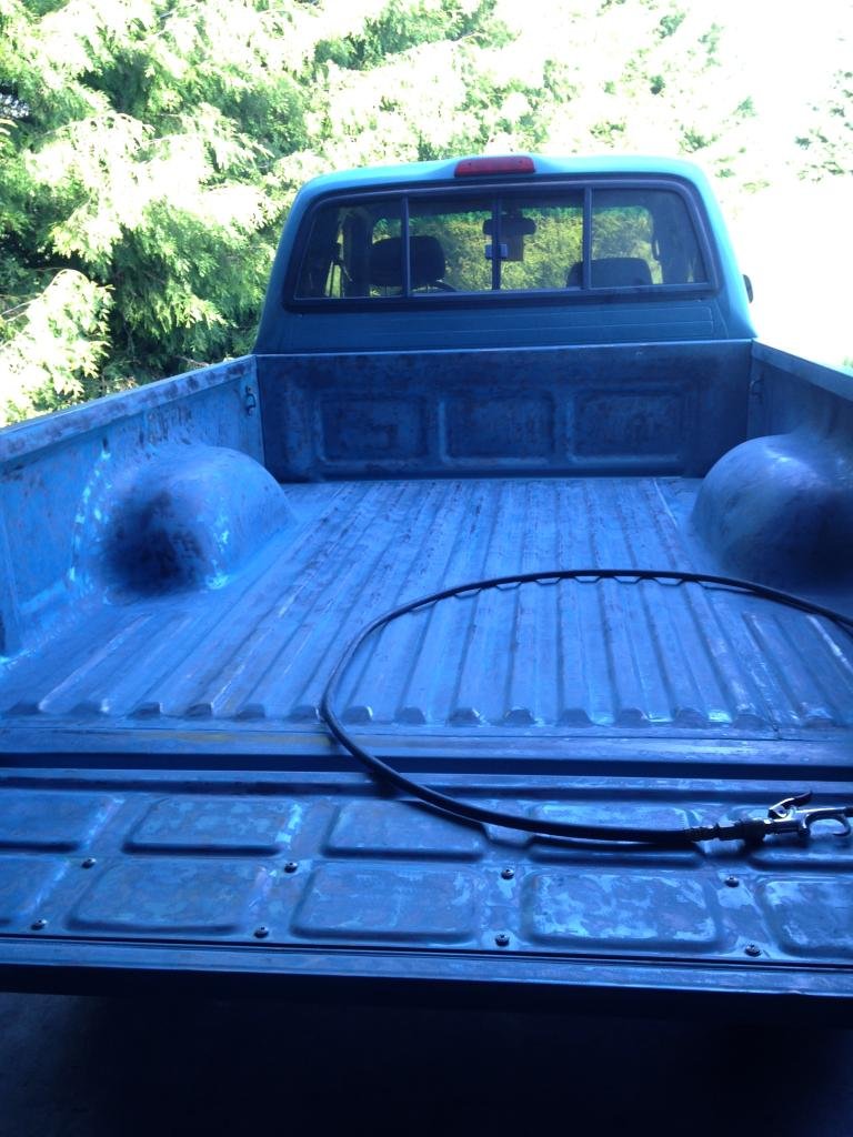

    I got a Raptor U-pol bedliner kit for $120 on ebay. Came with gun, 4 bottles of liner, and a can of hardener. I really tried to prep the bed well. I used an angle grinder with a braided wire wheel used to clean slag from welds. It made quick work of the paint/primer. I went over every inch of the bed. Then with paper towels and acetone, I wiped down every inch of the bed. The coats dried in about an hour, I used 4 bottles so it took approximately 4 hours to actually paint it. I wanted it as thick as possible (like a rhino line/line x) pretty happy with the result at almost a quarter the cost to have it professionally done.
    ***UPDATE***
    December 2014. tbh I'd recommend getting a Line-X. I am finding that it rubs away easily. I have hauled a GSX-R 600 a couple hundred miles, a large tool box, concrete forms, firewood/maul, furniture, metal stock among other random things sliding around in the bed. Its holding up alright but there is a reason the kit is a quarter cost of the generic thing. You get what you pay for i guess.

    Not perfect, but this is kind of a beater/wheeler truck anyways ;)

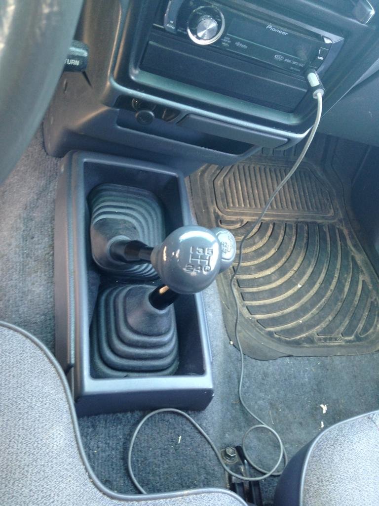

    I got this idea from SeattleCoug. I had an old wet suit laying around that i sacrificed
    8AB4A721-0372-483E-A538-60379378E221_zps_3cd7e104d4c63eede20a568d49d0a4f8b22425df.jpg
    looks so much better. I dont know why toyota put the leather boot over the rubber boot in 95. My 94 toyota pickup had just this rubber boot on it

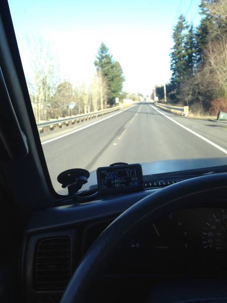

    I got some new head light housings on ebay. They came with some 6k bulbs, but I got a kit with a 6k HID conversion kit. I am running the bulbs it came with instead of the HIDs and they seem to work alright but once a bulb goes out I plan on throwing in the HIDs. I also installed some Amber LEDs for the side markers from VLEDs. I also got a 6k LED dome light for the cab.

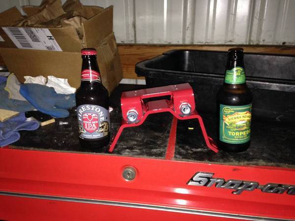

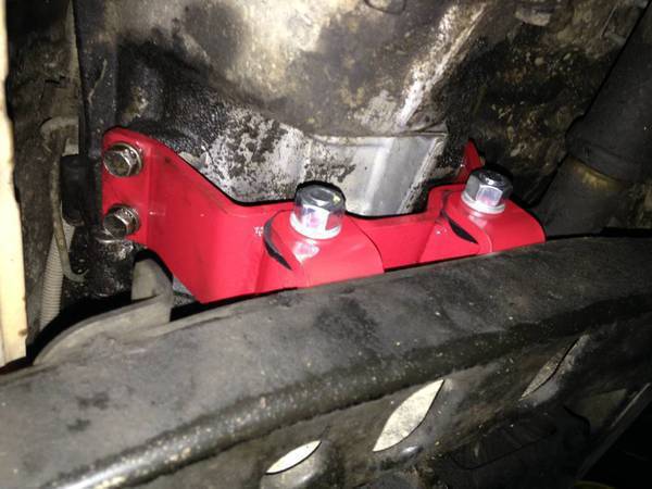

    I also installed 4x Innovations heavy duty R150f mount with polyurethane bushings. It caused a lot of vibrations at first but I figured there would be a break in period for the poly. After about a month the amount and intensity of the vibrations has gradually reduced. Its nice knowing the trans is bolted solid to the cross member. My old rubber mount was shot and moved around a lot when i pushed on it.[​IMG]
    I painted it red :cool:
    Yes i am aware of the oil on the trans. some of it was grease that was slung there from the driveshaft and the rest is from leaky gaskets and seals up front -__-

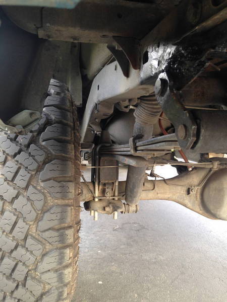

    In my never ending quest to rid the truck of the infamous rear end shimmy/wobble/bounce/wrap, I thought it would be a good idea to change out the slip yoke universal joint. Plus i recently developed some driveline vibrations. I paid $52 dollars after tax. I also (finally) installed my Toytec coils/Bilstein 5100's. The ride at slower speeds is very bouncy, and combined with my bad rear end, it makes for a rough ride. But they did ride nicely on the logging grades, which were pretty rough in some stretches of the road. I do see very small scratch marks on the coil from the knuckle hitting it. UCA's will be my next purchase. I also got my scan gauge (UltraGauge) all hooked up and situated. Still learning how to use it and set it up properly, but I'm already enjoying its many uses. I went for a drive today with a buddy to find some snow, and to test out the new components.
