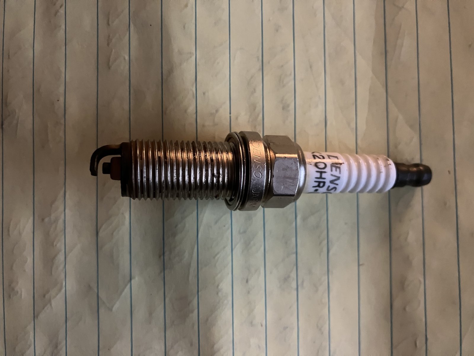

    They could be fakes but if they are they are good ones. Seems like I did get them on Amazon, which I will not do in the future. I am going to replace them all and hopefully won't have any further issues. This is the plug I replaced. IMG_0292(1).jpg

    152
    Charlie
    Dallas, Texas
    PreRunner
    I did go to my local Toyota dealer and picked up 6 new Denso's. When I pulled the first plug I compared the two side by side and could see variations in the printing on the plugs. It's darker on the dealer plug. Also on the dealer plug just above the threads, etched into the metal, is DENSO OG LD + + + + + + + + +. On the suspect plugs I pulled the etched metal reads DENSO JAPAN HN + + + + + + + +. The etching on the dealer plug is much deeper and easier to to read. Also noted is 9 + signs on the dealer plug and 8 + signs on the suspect plugs. So it looks like the plugs I pulled are fake. I can't figure out where I got them though. I went back through my purchase history on ebay and Amazon and can't find that I purchased them on either site. Lesson learned. I'm going to the dealer from here on out for plugs. BTW, the truck is running fine again.
