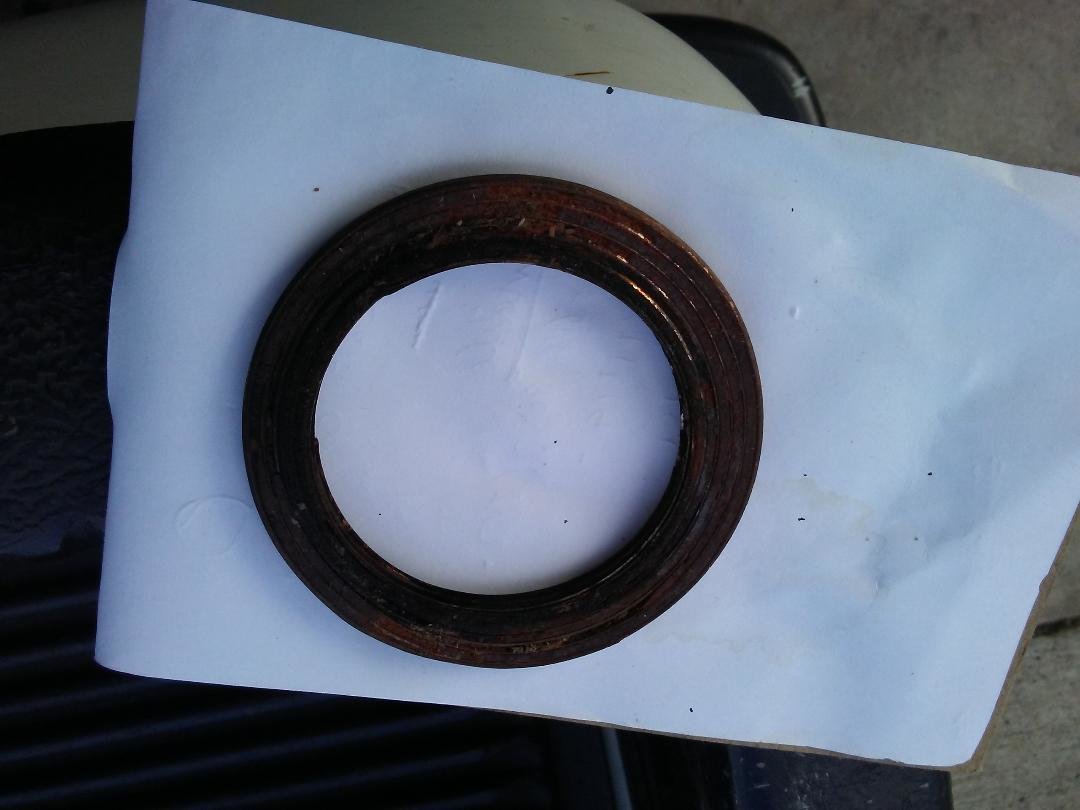

    Bad gaskets cause this code to trip often.
    One needs to make sure to get the correct gaskets I had parts stores get gaskets mixed up hanging them up.
    Wrong gasket fails in no time yet most think I just replaced the gasket that can`t be the problem.

    Yes true it took a while to find the correct gasket there are so many that claim to be the one. This is what the old one looked like. I am assuming it is original. Not bad for 20 years of living inside a muffler shaft...
