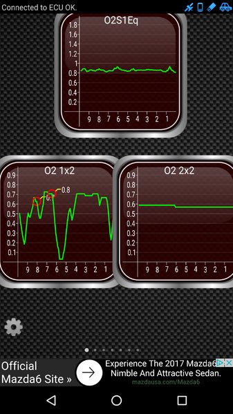

  17. Oct 2, 2016 at 8:12 AM
    #17
    Larzzzz
    Larzzzz Grande' Ricardo
    Aug 23, 2009
    #21609
    2,842
    Larry
    MA
    '06 dclb 350+ kmiles
    Aux back up lights, Bed lights, Re-located trailer plug, Good dooby, a.k.a. jumper cable mod, Heated seats, back up camera,
    I got this code...pissmeoff. Sunoco ultra and Chevron techron fuel system cleaner... I'm thinking I got a leaking injector based on the smoke I see when starting the motor cold. May swap O2 sensors around as torque is showing bank one, sensor 2 all over the place while B2S2 is pretty much a flat line

  20. Oct 2, 2016 at 8:35 AM
    #20
    Larzzzz
    Aug 23, 2009
    #21609
    2,842
    Larry
    MA
    It seems to run OK. I am not feeling a misfire or dead cylinder. Here are some screenshots from torqueScreenshot_20161002-113304.jpg Screenshot_20161002-113304.jpg
