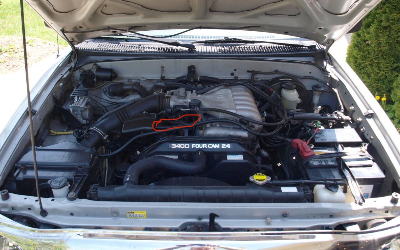

    Hello everyone. My 03 has thrown the infamous P0440. I found a broken vacuum line coming from the air hose (vacuum line is called air hose #3). Could this cause a P0440 to come up? Not seeing any obvious leaks in the EVAP system and thought I’d check here first before getting a smoke test done. Any insight would be great. Thanks in advance. Photo linked to hose I’m speaking of.

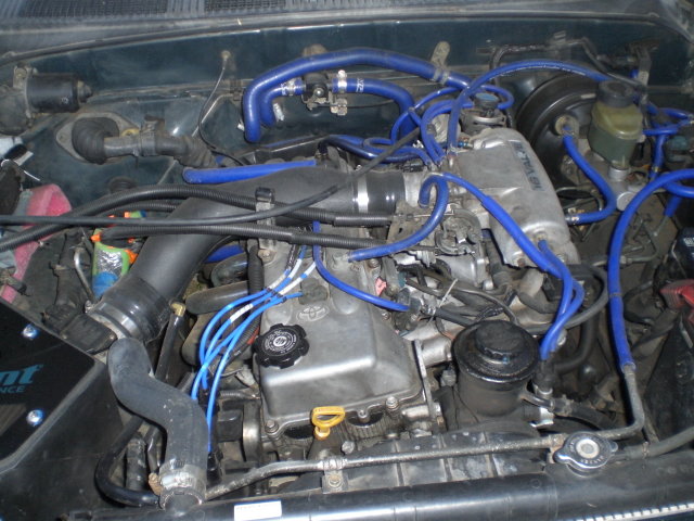

    is all your vacuum deleted?
  5. Dec 13, 2023 at 6:07 AM
    shoulderpads
    shoulderpads [OP] Active Member
    Dec 9, 2023
    #439195
    38
    Zac
    2003 Tacoma TRD Off-Road
    Wow.. I like that a lot. Where did you get those?
    98_3RZ_NIC likes this.

    As you can see the truck has become my hobby.....empty nest....no wife .... syndrome...
    Some evap codes you just cant get rid of.....I replaced every dang hose in the fuel and vac/ evap system......just for ocd old man disease....
    and then I was rewarded with the 440 code few months later....when there were zero codes before......go figure...
    I'd reset.....and got the 440 code over and over...
    over the year I reset half dozen times...only for it to come back at odd times when the fuel would slip past the 1/4 tank mark .....
    And then about a year later.....it just turn itself off.....and hasnt come back for almost a year now....
