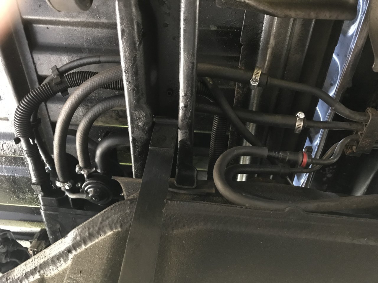

  6. Oct 24, 2021 at 11:44 AM
    #26
    Andy01DblCabTacoma
    Andy01DblCabTacoma Well-Known Member
    Mar 12, 2021
    #359086
    3,929
    Andy
    San Diego, CA
    01 Double Cab v6 4x4 TRD
    F: Kings SPC, R: 5100s+J59s. Custom armor.
    Did you check out that link @AmherstAndy posted? It details the process that shop used.. ultimately the lines were misrouted, and solved the issue.. So I'd for sure be checking under your rig for the same issue.
