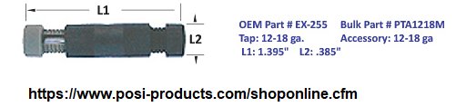

    Depends on the amps the added lamps require and the max the relay can handle.
    You can use these to add the positive wire of the ambers to the whites positive wire IF total amps to not exceed the fuse, wiring and relay. The switch part is fine.
