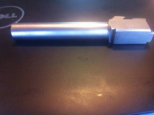

    Step Fo: Put a couple drops of Flitz on the barrel and start scrubbing with the green scotchbrite pads! (this picture was literally 2 minutes after I took the barrel out of the vinegar)
    The muzzle end of the barrel still has the factory finish, see how the chamber is shiny?!
    side note: the directions on the flitz bottle say not to let the compound dry. So, I would apply flitz, scrub a section, wipe clean, apply more flitz, scrub section with a clean portion of scrub pad, wipe clean, repeat.
    Step 5: Wash barrel again in soapy water.
    [​IMG]This was after 45 minutes of just polishing by hand and washing off with soap. All areas which would be seen while installed in the gun look great at this point, but I decided to go ahead and get all the tough spots (like under the locking lugs).
    Step 5a: (optional) use brasso and steel wool to really get a good "chrome" shine. also use dremel to polish feed ramp and little nooks and crannies. Wash in soapy water again and proceed to step 6.
    [​IMG]polished feed ramp

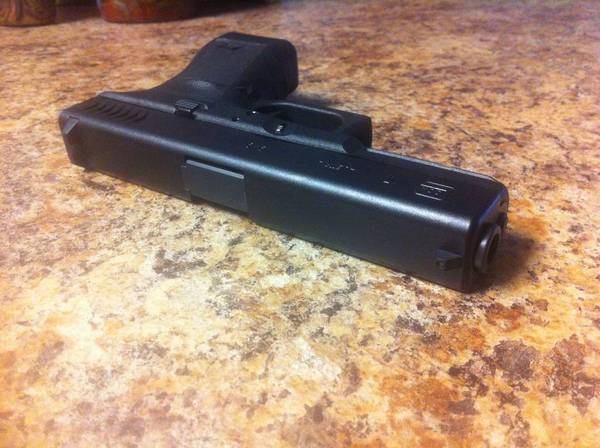

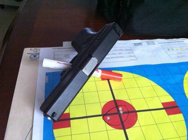

    finished product installed
