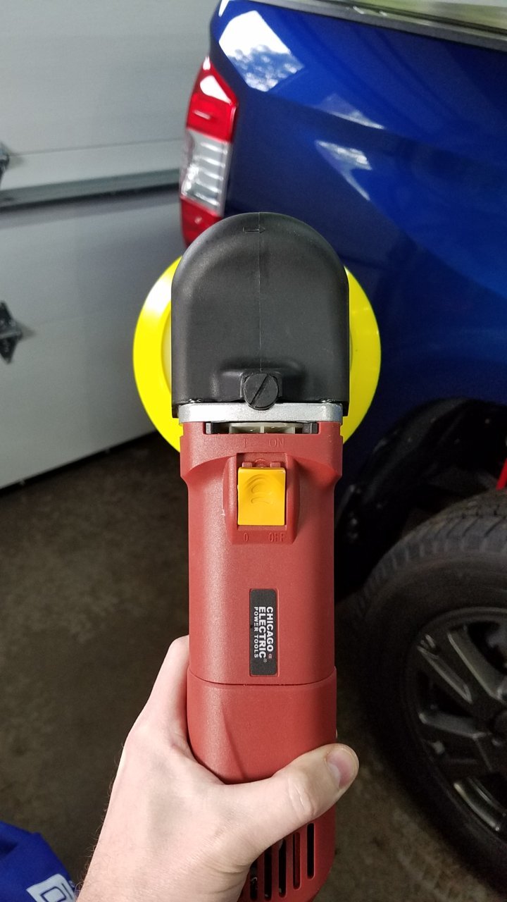

    Who wants to buy my HF DA? It's the Chicago electric brand I think, whatever the pre-Bauer brand is, ya know, the "good one" lol. With a 6" backing plate. Its like new in box. I did the grease mod, washer mod, and rotated the body to make it more user friendly.
    I considered keeping it to run a 3" backing plate on since the new G9 supposedly won't accept a 3" backer. But I doubt I'd actually use it much to make it worth it.
