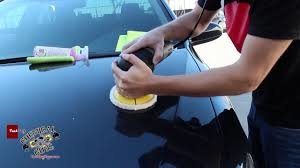

    How's the overhead grip of the G9? I like putting my hand on the head of the polisher while their's a handle on the Griots, Rupes.
    Like this.
    I guess it's just a matter of getting used to the polisher.
    Anything I get will be an improvement over the 1st gen 7424.
