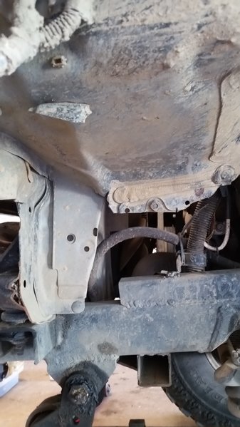

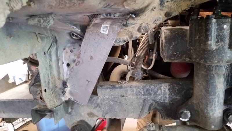

    Did some wrenching today, mostly tightened bolts up (u bolts were damn near hand tight) and fixed my collapsing fender. I hacked way too much out of the fender and my battery tray started to really collapse in on itself.
    Booger welded this piece of scrap i had laying around, hope it holds.
    Also remeasured my frame height after the springs got broken im sitting at 22 1/4.

    That thing is lowwww.
    No sense building anything else because it will get trashed too. Just back half it if the rust is taking over. Super easy to do plus a good excuse to go f150 tank at the same time. No one will judge you if you keep it stock length with the bed too
