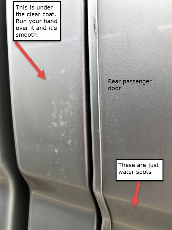

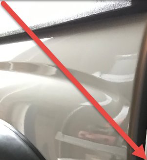

    PAINT / CLEAR COAT CORRECTION AND MANAGING EXPECTATIONS
    Wanted to share my experience with attempting to "correct" paint / clear coat damage. Again, I can't stress enough that everyone has a different approach to issues and this is just the approach I took.
    I think it's also important to manage your expectations...........meaning that you know it's not going to be perfect.
    A couple of years ago I noticed some small, white, cloudy spots right behind the passenger side door (toward bottom). I even posted on TW about it, and everyone was right!!!......clear coat damage. Again, I purchased the truck new, and no accidents. Also, it's such an odd spot for clear coat damage. I expected the hood or top of the truck.
    Took it to 3 different body shops and every single one of them quoted about $800 to correct. Why so much?????? because they said they would have to paint the entire rear panel and possibly over the top of the truck to match. I even explained that I didn't expect it to be perfect, I just wanted to slow the process down or at least just reapply clear coat on that area. They won't do that due to warranty, etc. They stated that I may have run over some sort of chemical in the road, etc., which weakened the clear coat.
    So I thought I would apply some 3M Clear Protective tape over the area. Mistake! That made it stick out worse because the protective tape is shiny clear and it made the spots under neath pop!!
    About a week later I tried removing as slow as humanly possible, and as you can see in the picture below it look like fido's rear afterwards.

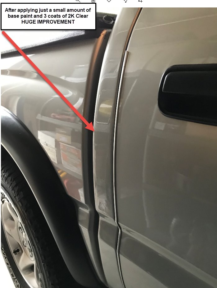

    So, I had to do something before this cancer spread. There were some areas of the base coat that didn't match due to fading. I tried just spritzing a small amount of Duplicolor Color Match, but it was no where close. @yarb71 and I have the same complaint. Way to shiny and to much metallic flake
    I then ordered a can of automotive base paint (spray can) from automotivetouchup.com (link below). This was a much better match. I wasn't expecting it to be perfect due to fading, so I just lightly spritzed the area.
    After about 30 minutes I then applied two light coats of USC SprayMax2K (link below). This is a 2 component clear coat. Lastly, I applied a heavy coat.
    Waited about 45 minutes and slowly peeled back the tape around the area, and let it dry for two days before removing the remaining tape/paper.
    For me, it turned out awesome! Is it perfect..no, but that's okay.
    As for prep..I removed any clear that I could but I did not do any sanding. I didn't want to damage the base paint. I also just used rubbing isopropyl alcohol 90% to wipe it down.
    I'll provide some additional pictures the next time I pull the truck out.

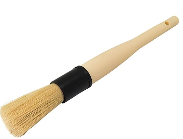

    Brahms I'm sure it would depend on what condition the motor is to start with. It's definitely not a one and done process. Meaning, I'm probably either under the hood or truck at a minimum of once every two weeks. But, as TW Member Slander stated, that's not for everyone, but it's good stress relief for me and I enjoy it.
    I detailed the engine on my friends '04 Tacoma 3.4l, and I just about wore out a engine brush like the one below to get the oil/grime out of the nooks of the motor. I was trying to be careful to not damage the brittle plastic under the throttle body and intake.
    Also helps if you do a lot of the work on the motor yourself. Even when I purchased this truck new, it would make me ill as a hornet the way the dealership would make a mess at changing the oil/filter. I understand on the 3.4l that it's usually messy getting the oil filter off, but damn, at least wipe the old oil off the motor, etc. That's why after about the 2nd time, I started doing it myself. With the skid plates off, you can access most everything under the truck.

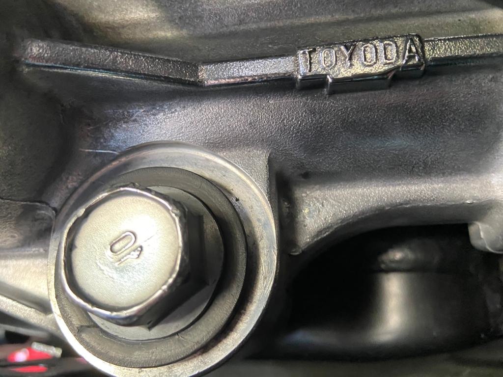

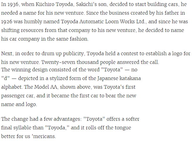

    Bit of Toyota history...
    If you have an original oem power steering rack, you'll see "TOYODA" stamped on the front.

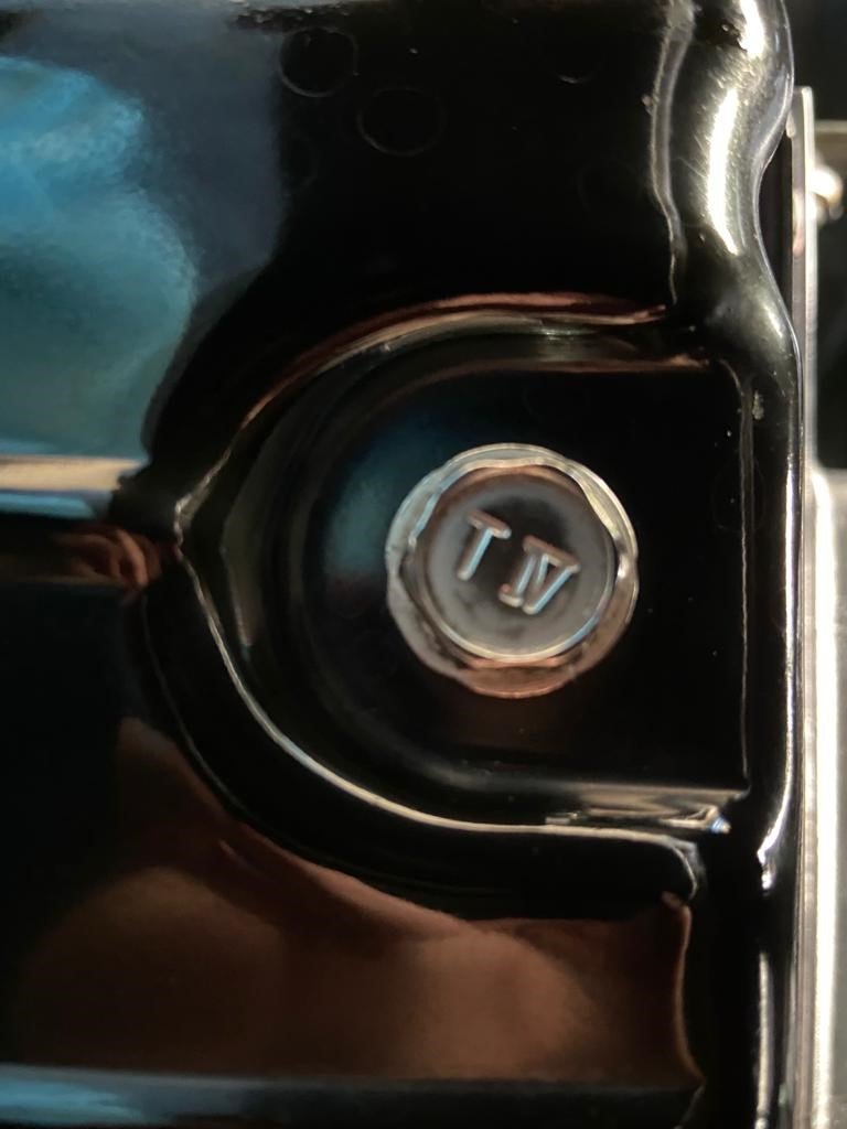

    I told you all in the beginning I'm a Toyota Nerd and in upcoming post my plan is to point out all the identifying numbers, etc., on the motor.
    Not sure if they put the Transmission Type on the transmission drain plug anymore??
    Pic of the drain plug on my '03.
