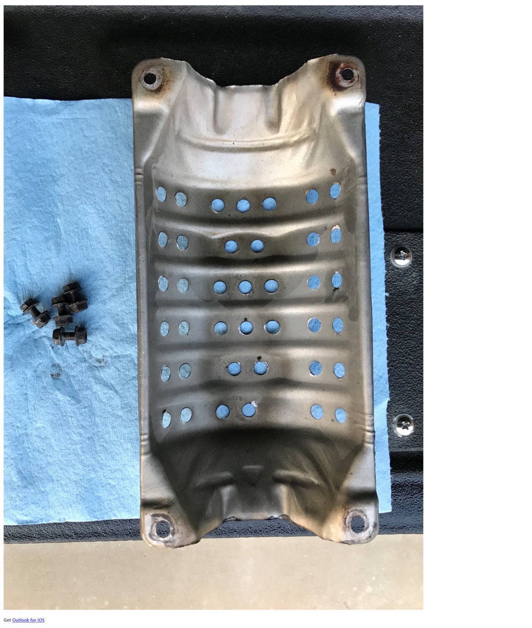

    Decided to remove the cat heat shield located just before the heated oxygen sensor (Bank 1/Sensor 2).
    @GQ7227 You'll appreciate this..........

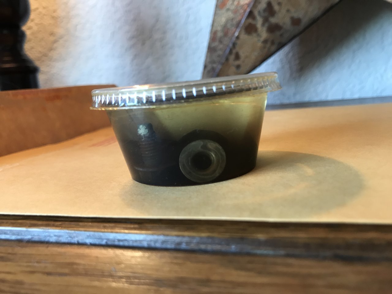

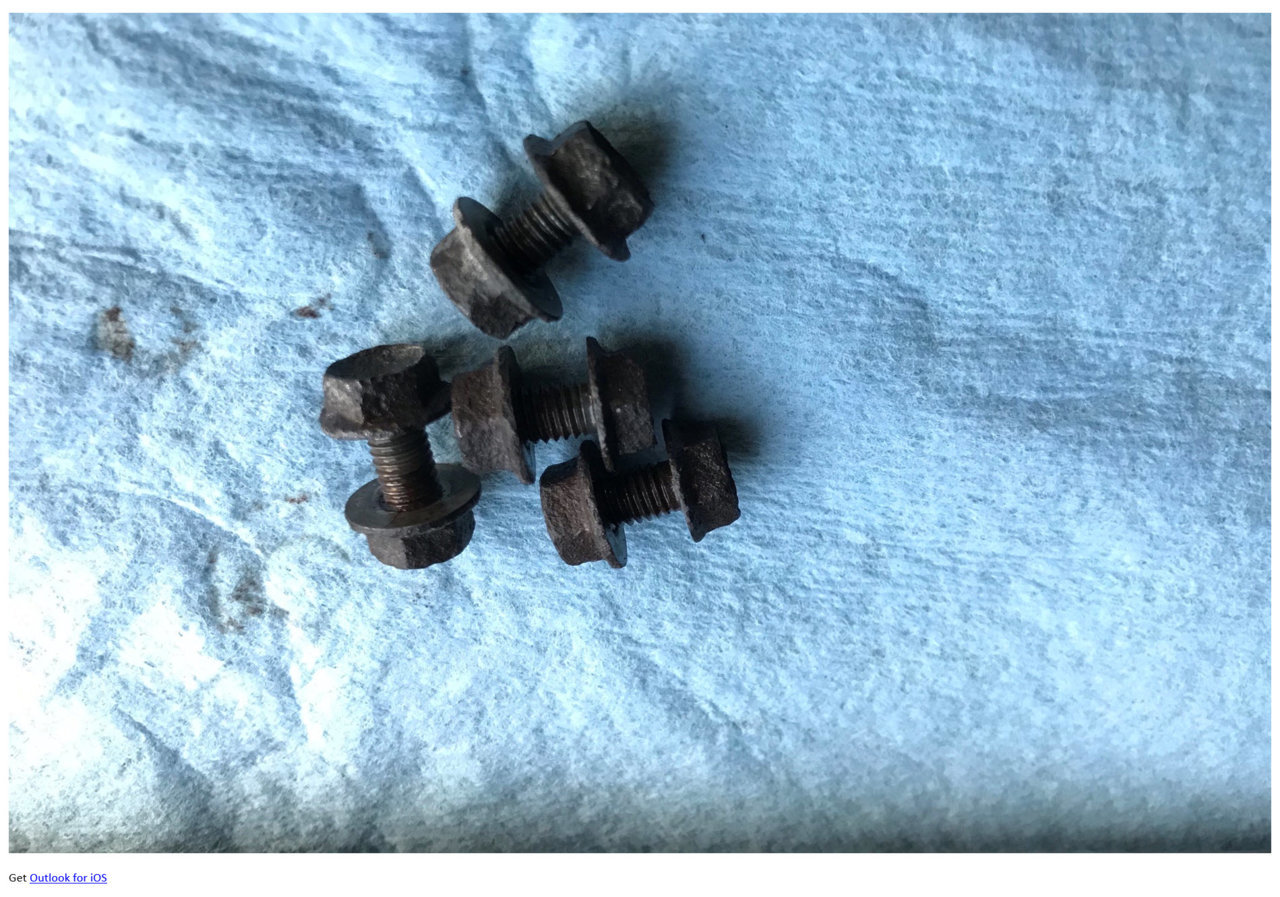

    I knew the bolts would be difficult to remove so I sprayed them with PB Blaster for three days.
    I already told myself I wasn't going to force them and risk breaking the head off a bolt. Surprisingly, they all came off with little drama.
    I put the bolts in a cup of Evapo-Rust last night. I'll post a picture of what they look like afterwards. I may just go to Lowe's and purchase new stainless steel bolts/nuts to replace them.
    I reached out to TW Member @JonathanH (Great Guy to contact for hard to find parts) to see if I could get the part number for the bolts, but they are no longer available.
    https://www.amazon.com/Evapo-Rust-O...ld=1&keywords=evaporust&qid=1602082545&sr=8-4
    I'll post some pics once it's all cleaned up.
    Secured by 4 10mm bolts

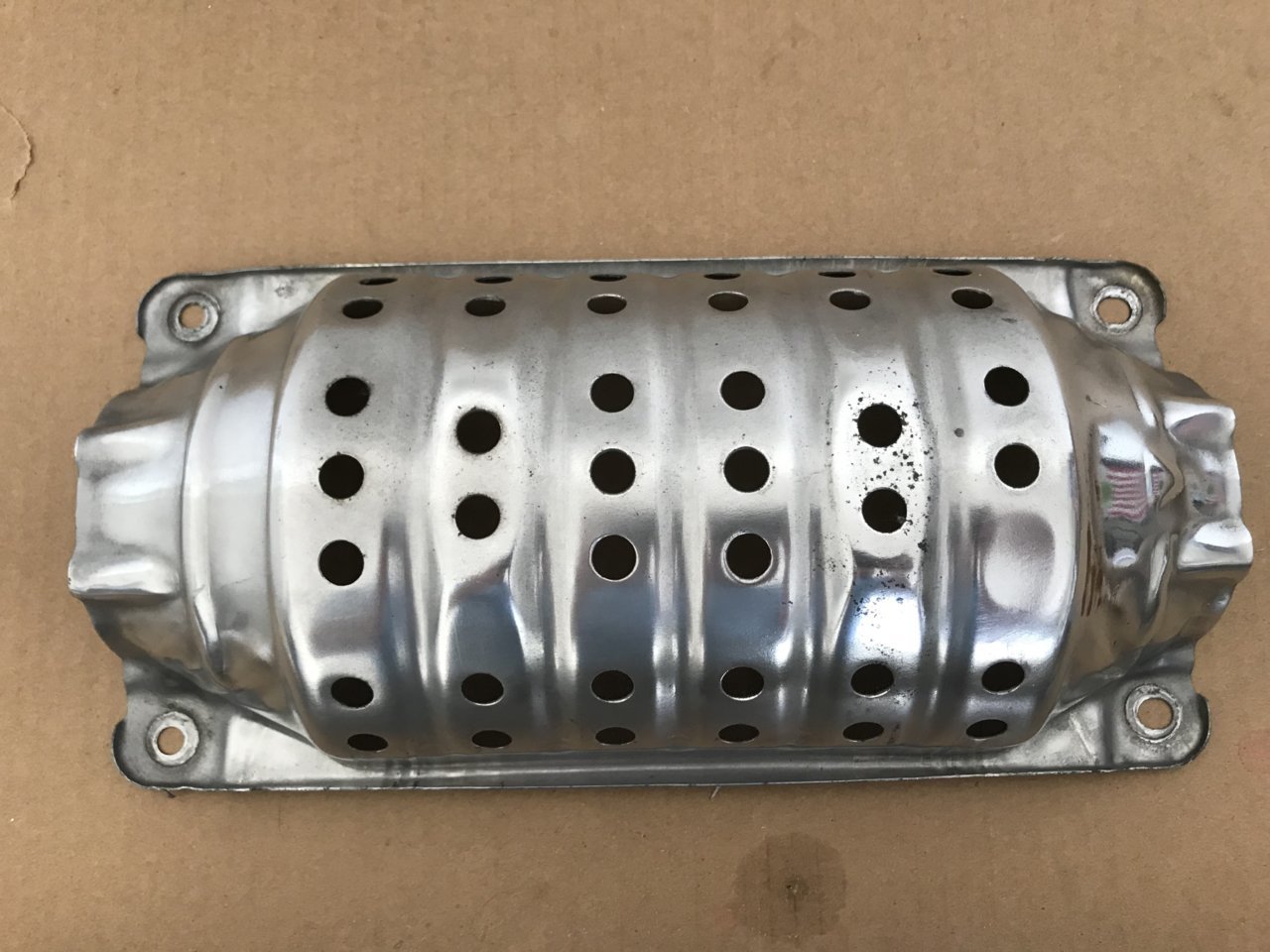

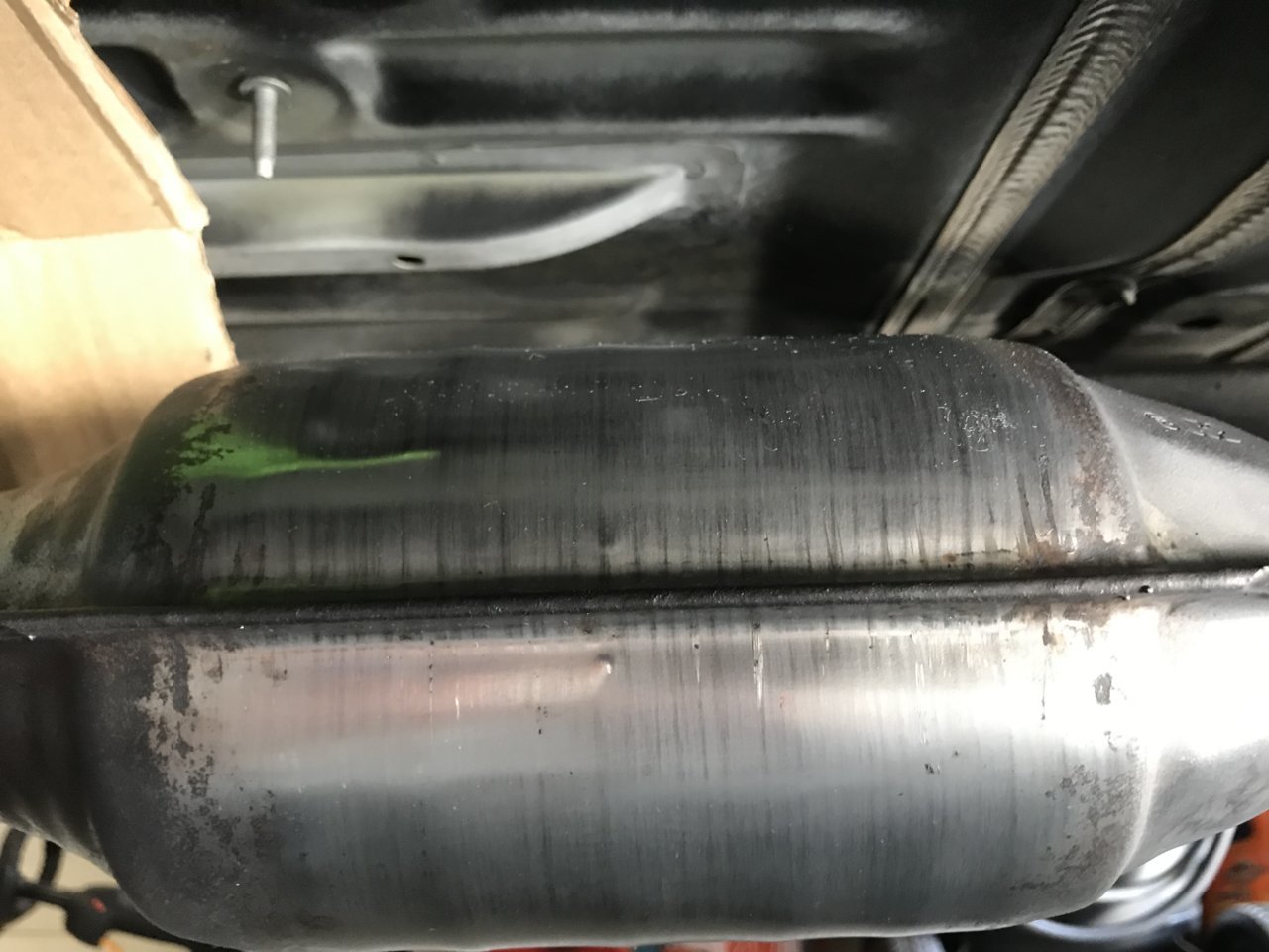

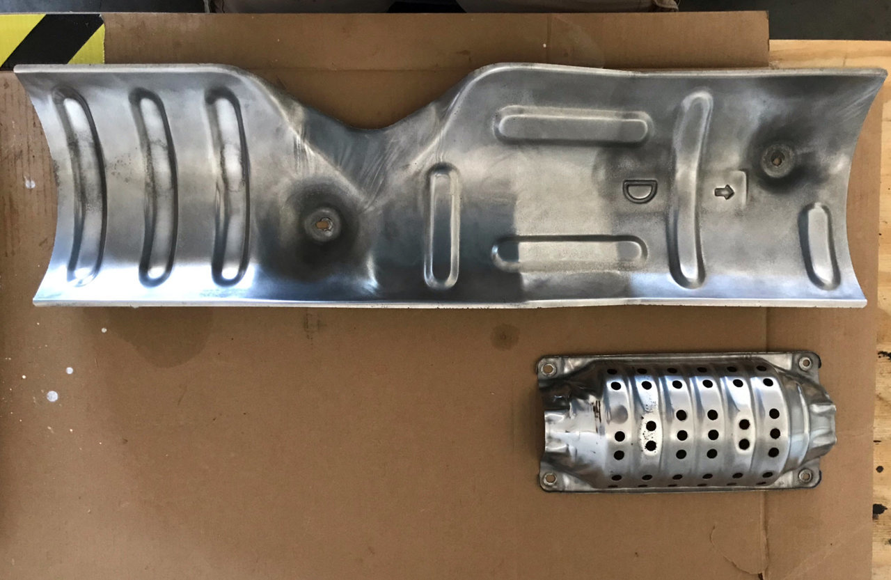

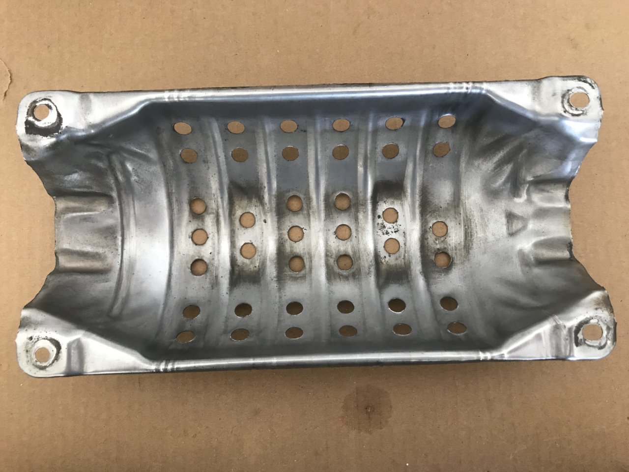

    Got the Cat Shield cleaned / polished up best I could. In order to clean the top of the cat converter I had to remove the long heat shield that's secured by two 10mm bolts.
    If you ever remove any of these heat shields wear gloves!!! Man, the edges of those are like tin cans and will cut the crap out of you. My hands and arms look like I got into a fight with a bob cat.
    Bolts are still in the Evapo-Rust. I could not find any M6-1.0 flange bolts/nuts so I ordered a set of 20 stainless steel ones off of Amazon.
    More to come..................

    If you’ve never used it, evapo-rust is pretty awesome. I know it’s sold at AutoZone.
    Once again, I experienced a J A Y moment tonight. I removed the cat shield (oxygen sensor 1) but not without breaking 3 of 4 of the 10mm bolts. They snapped like pretzels when trying to remove. That was even letting them all soak with PB Blaster days in advance.
    Good thing I ordered the 20 pack of replacements.
    I’ll post pictures of all that tomorrow.

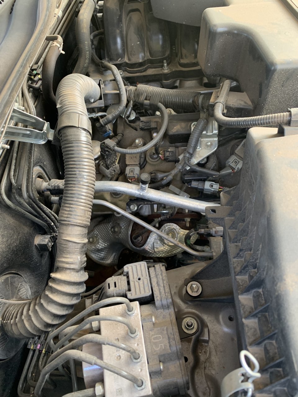

    My 2017....My 2001 isn't near this bad. I guess I could always hit it gently with a pressure washer? That has always scared me.
