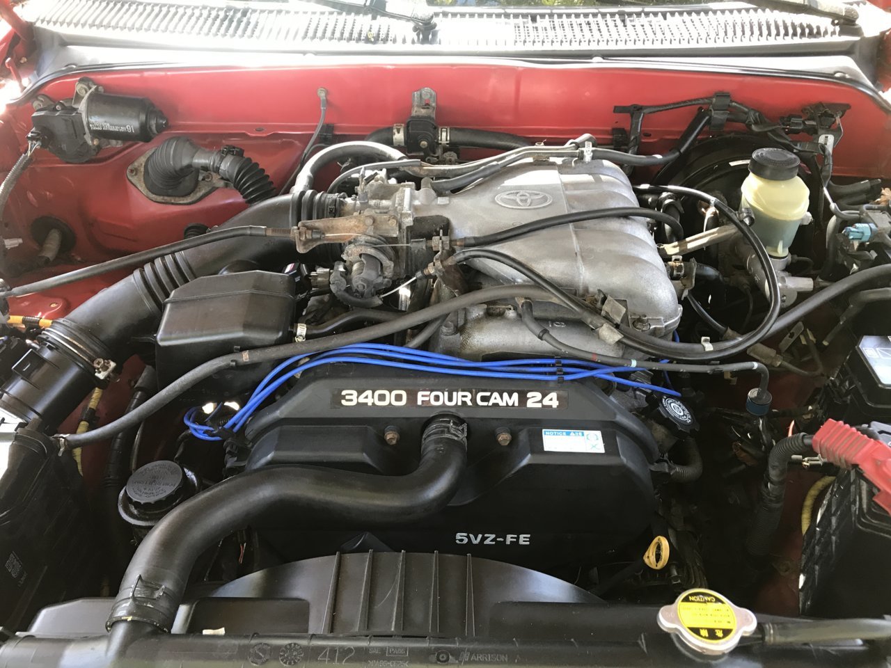

    01 Engine compartment

    lol..Dave your '01 is cleaner than your '17. Very nice '01. That's what I don't like about the new vehicles.....plastic intakes. Looking at your '17 there doesn't appear to be a lot to polish!

    It's not bad.....last time or two out on the trails with the 17 were wet and muddy. I guess the fan blades kicked up most of the mess going through some deeper puddles.

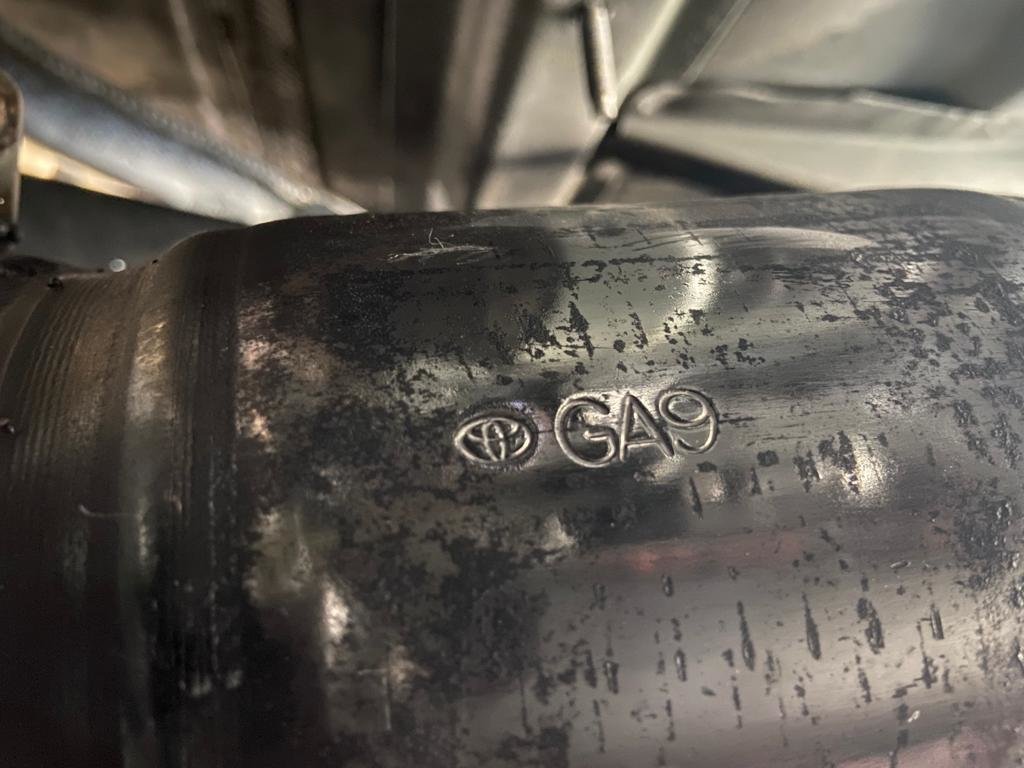

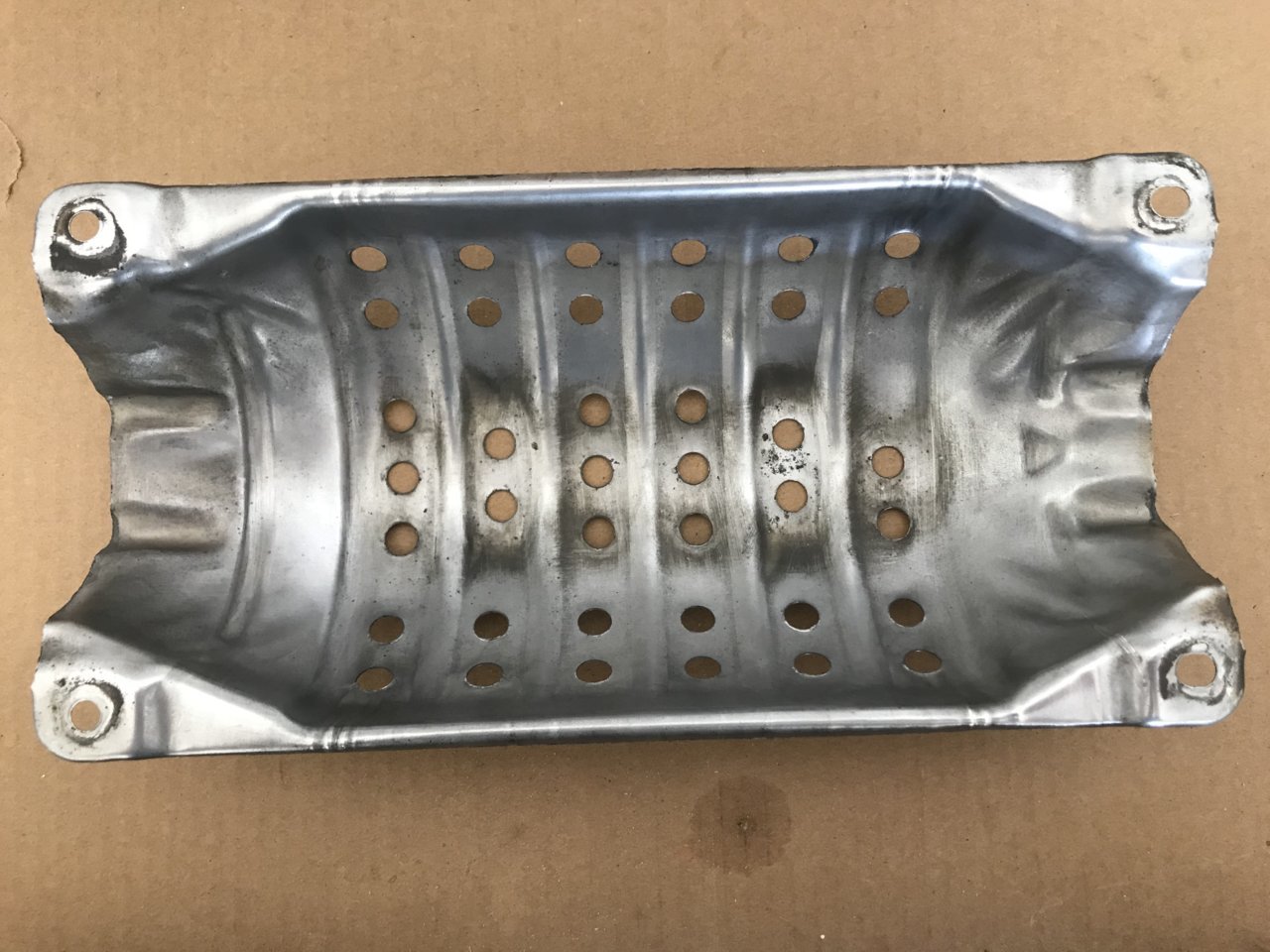

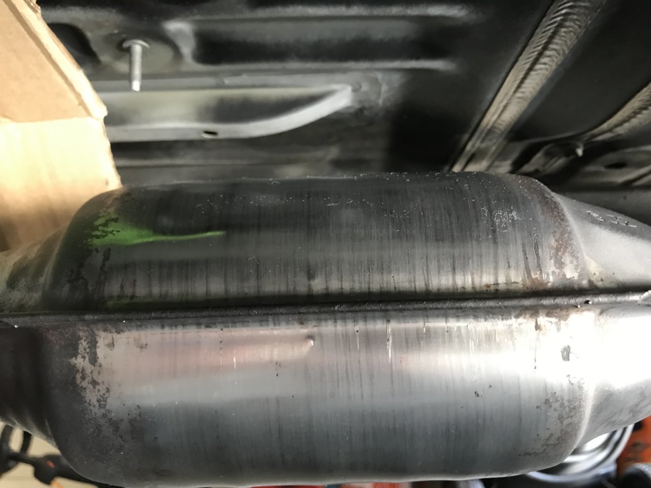

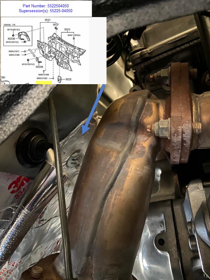

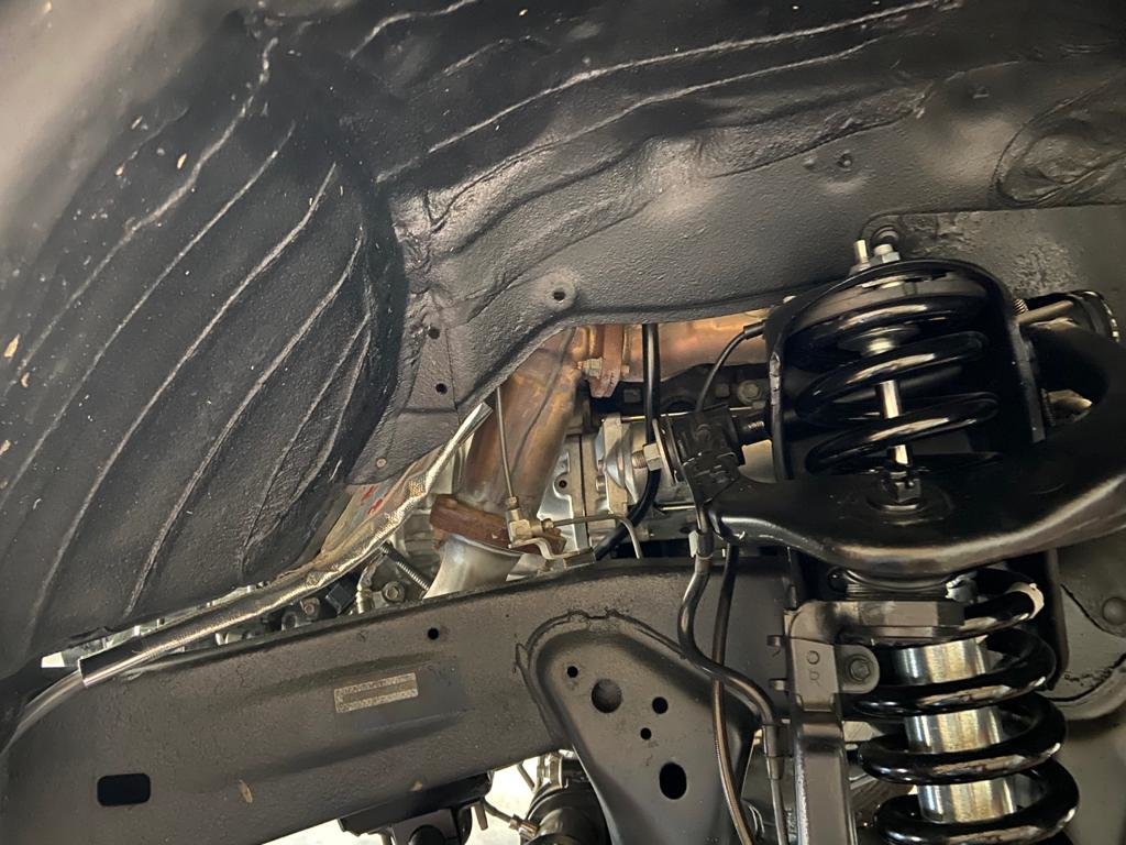

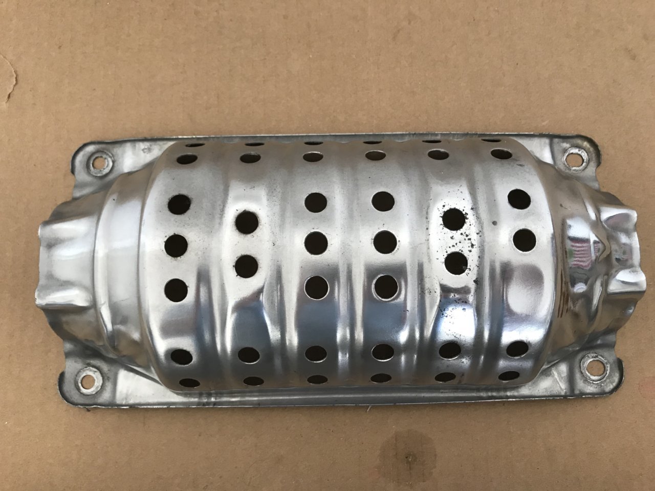

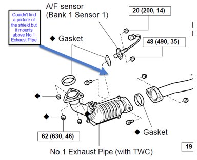

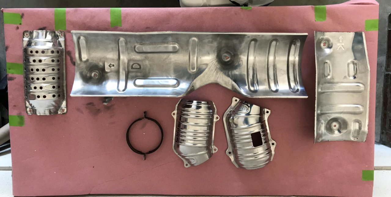

    Update to exhaust shields.
    New stainless flange bolts/nuts should be arriving tomorrow. Below are some pics of all but two of the heat shields cleaned up.
    Did not remove the down stream O2 sensor shield or the rear shield that's mounted above the main muffler.
    While they are off, I painted the exhaust where some rust was coming through. Did not paint the center exhaust or cat.
    I'll post a final picture once it's all back installed.

    Back side of down stream O2 sensor shield

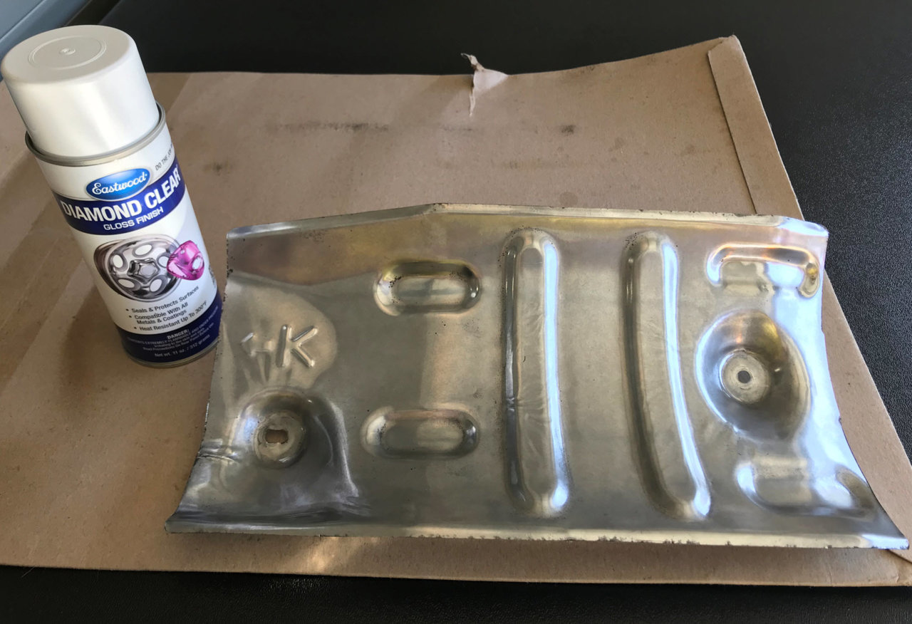

    Since I had a small amount of the Eastwood Diamond Clear left, I decided to try it on the shield that's located above the No. 1 Exhaust Pipe. Only had enough to put 4 good coats on the side facing down.
    Turned out really nice. I just wonder how it will hold up?? I did go ahead and order more the clear coat so I can do the longer shield.

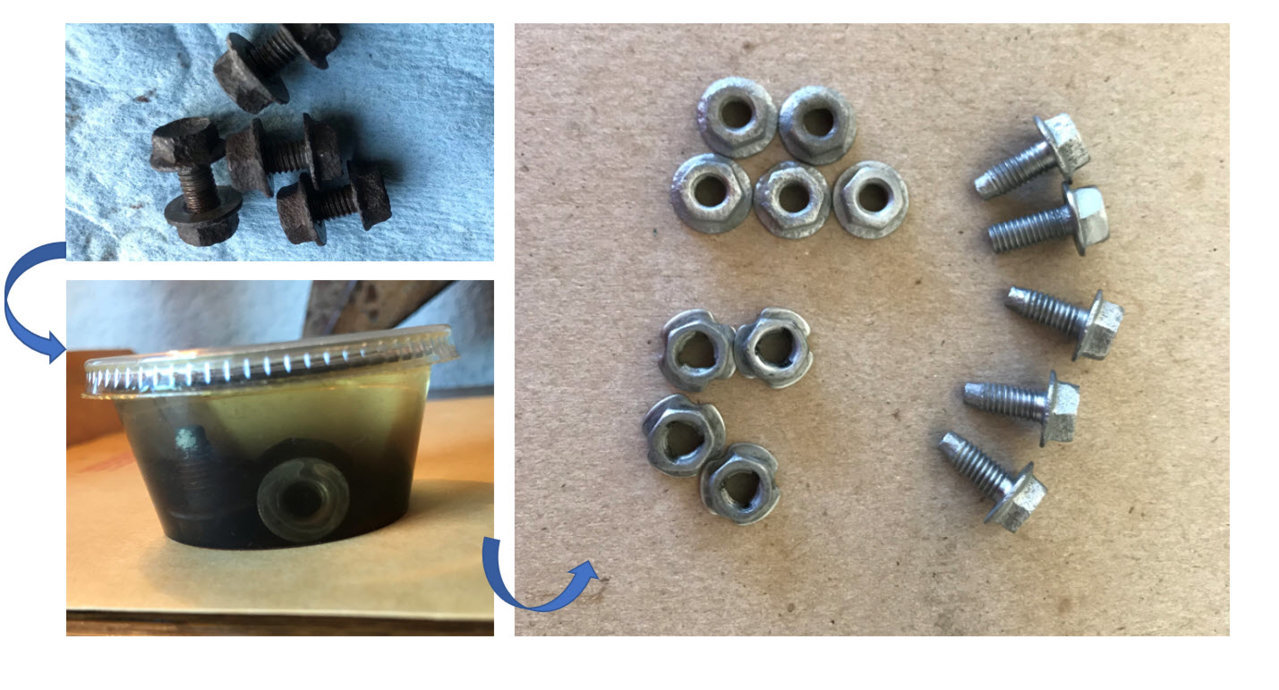

    New stainless flange bolts/nuts arrived!
    Also below is an update on the bolts that I put in the Evapo-Rust. They turned out better than expected.
    Rust removal from start to finish

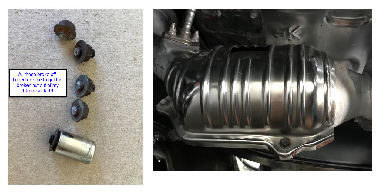

    Anyone know a trick to removing that broken nut from my socket??
    Carnage from removing the bolts that attach the shield right after the 1st O2 sensor
    SwampYota, GQ7227 and DarthPow like this.

    other than using a vice, and some pliers to pry it straight out, or grabbing them and twisting in the "loosening" direction (or opposite the direction you twisted it to get it stuck), my only solutions would be to either PB Blast it and try it again, or heat up the socket with a torch while its in the vice and keep tension on the bolt head until the socket heats up enough to expand, being careful to heat it slowly.
