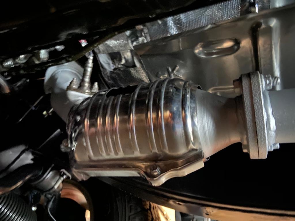

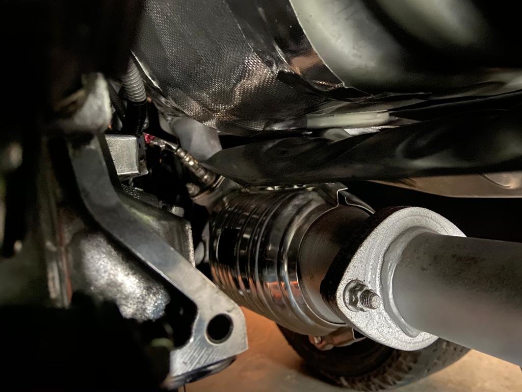

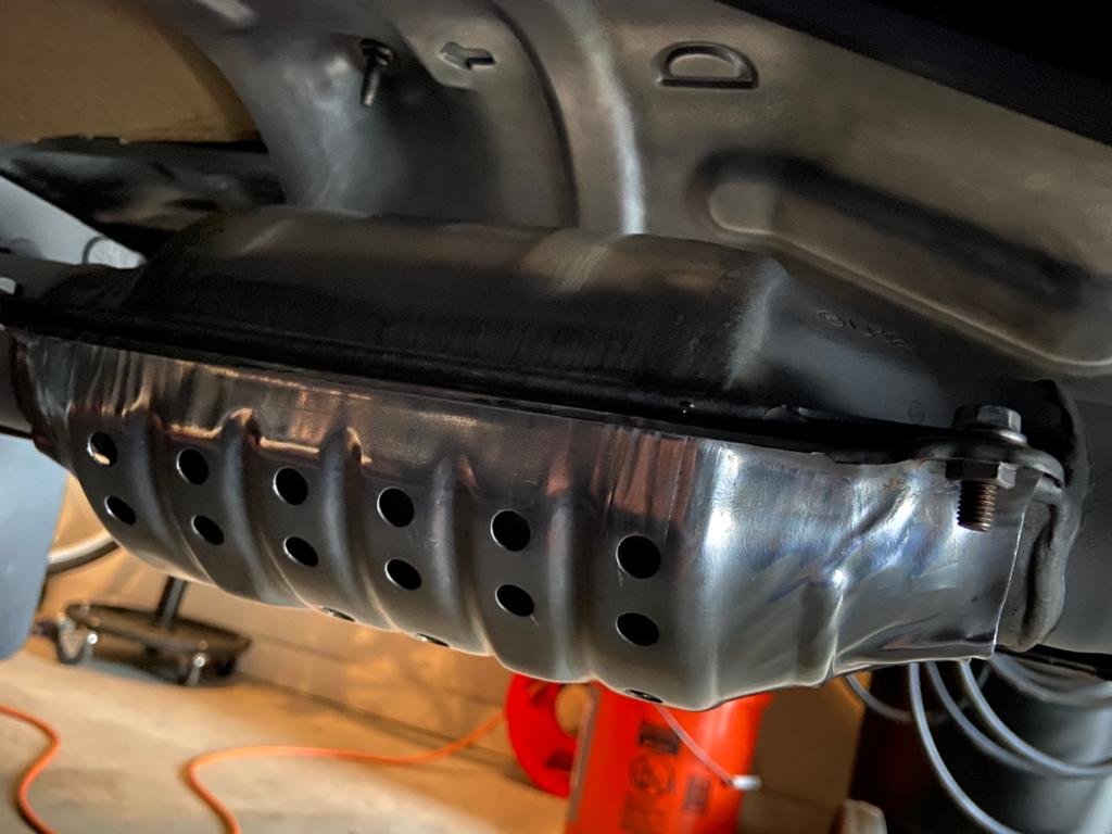

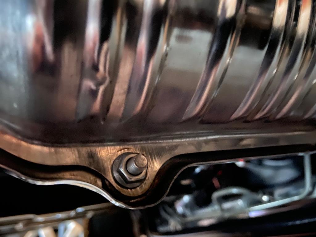

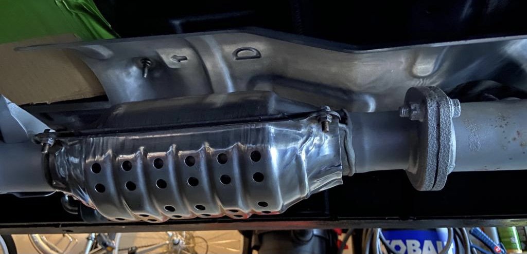

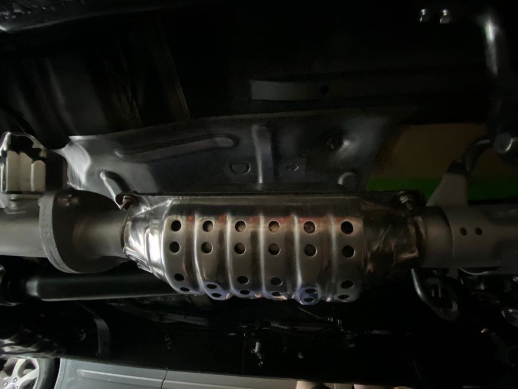

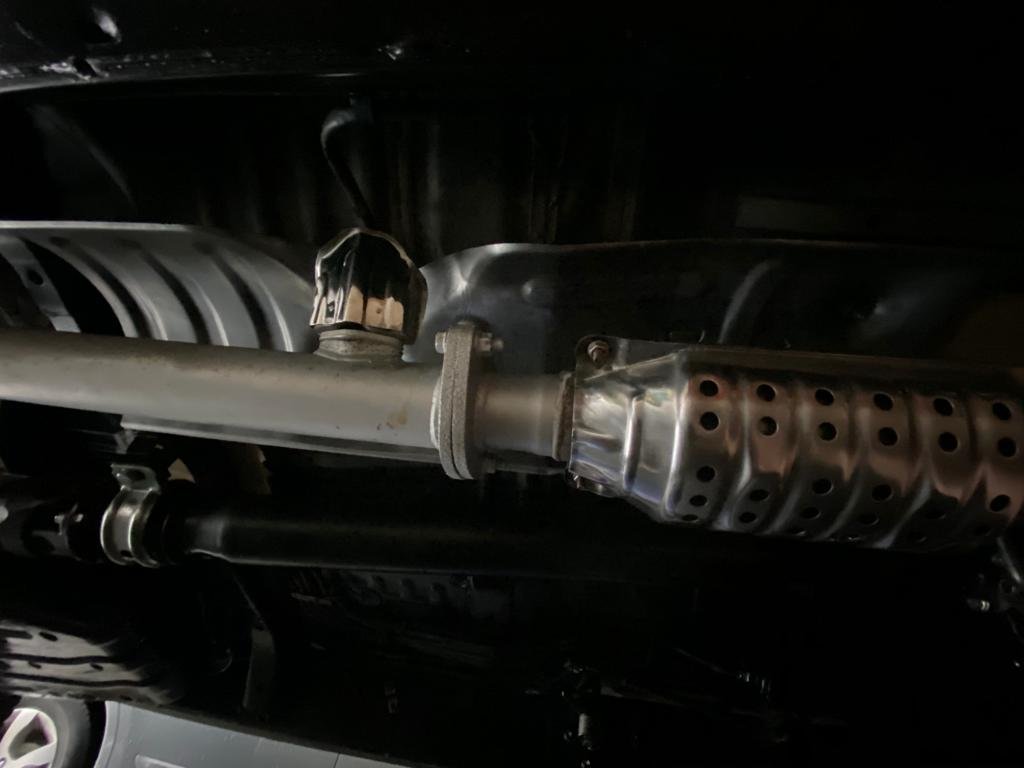

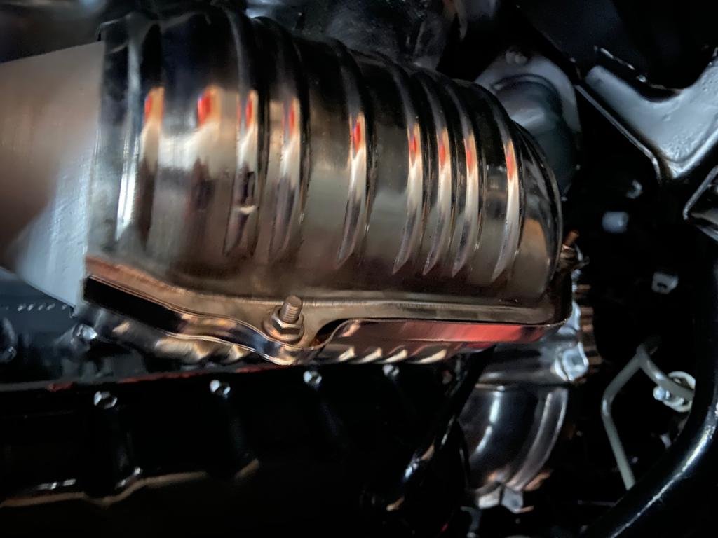

    Pics of the exhaust shields reinstalled with new stainless hardware.
    Applied copper antiseize to all bolts.
    Applied clear coat to the two shields that mount above the exhaust.

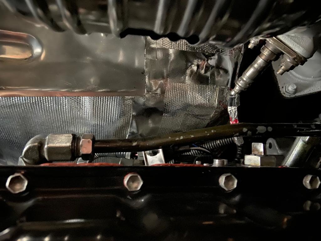

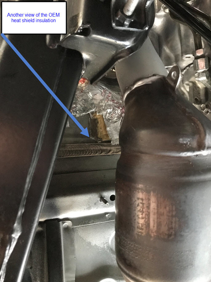

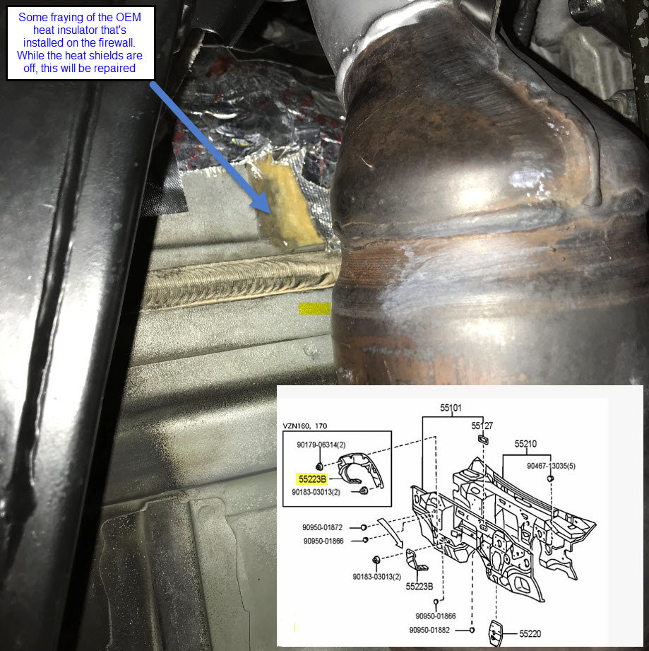

    Before reinstalling the exhaust shields, I did a minor repair to the heat shield barrier that goes up against the firewall. I believe this is on the automatics only.
    Much easier to do this with the shields off.
    Used Thermo-Tec 13575 Adhesive Backed Aluminized Heat Barrier and heat reflective tape to put over where the oem barrier was fraying.
    I cleaned the area with brake cleaner and lastly used rubbing alcohol before applying.
    I would definitely use again. Great product.
    https://www.amazon.com/gp/product/B00029KC2K/ref=ppx_yo_dt_b_asin_title_o05_s00?ie=UTF8&psc=1
    https://www.amazon.com/gp/product/B000E283S0/ref=ppx_yo_dt_b_asin_title_o08_s00?ie=UTF8&psc=1
    SwampYota and Bigdaddy4760 like this.
