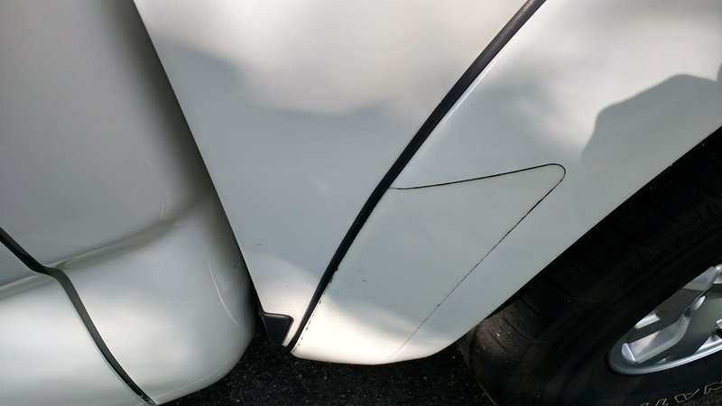

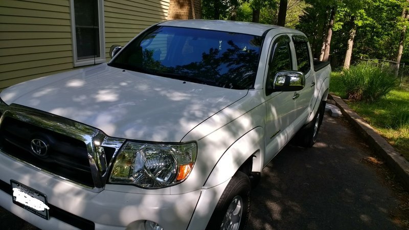

    Just got finished doing it a second time, it was mostly to hit the little spots I missed. I think it turned out good, looks as good as most peoples 5 year old vehicles.
    As you can see I have some areas I want to touch up, etc.
    I'm going to get a load of shit for this but I think most people simply go overboard with the whole "detailing" thing. What many people consider detailing I just considered a good cleaning. As a highschool kid I gave peoples vehicles a good cleaning for $50 and quite a few people told me I did a better job that the guy that charged them over $100, guess I sold myself short but hey I was just a kid and happy to make $50.
    I have a 1979 Buick LeSabre with original paint that looks as good as new and all I ever did to it was wash and wax with cheap walmart wax. It use to be my grandmothers car, she got it brand new.

    Put it in the sun and then let's talk. It's easy to do pictures in the shade. As others stated it is nearly impossible to get same results as a machine by hand. I don't doubt you saw some improvement but I suspect it's only temporary.
