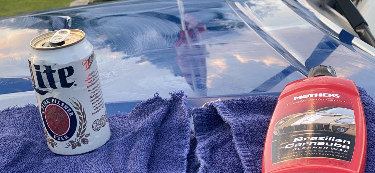

    As a friendly tip. Banana wax (yellow liquid wax) always comes off easy on cool temperature paint. Also 3m paint sealant works well for polishing.
    mothers is a cheap wax and leaves a great shine. 3CD3D225-2502-4E98-95C6-0DE9FC86A610.jpg It’s getting warm. Stay hydrated!
    1st I recommend a clay bar. It will Clean the surface of most things that are on the paint. A cleaner wax is also affective.

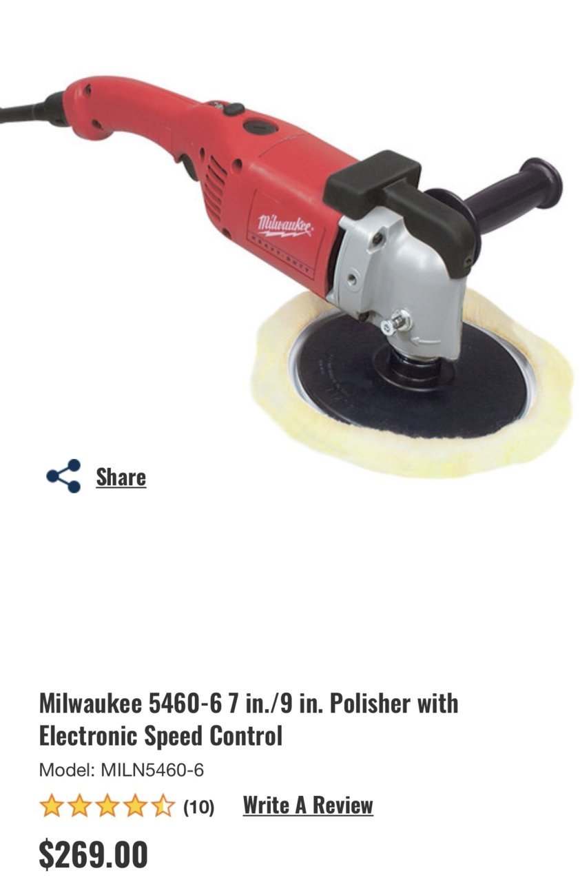

    scratches? Yep it’s time to break out the good old fashioned High speed buffer. Variable speed!!!
    When I was younger I worked at a few dealers and learned how to buff cars. We had Milwaukee variable speed buffers. The Velcro backing for easy changing pads. Caution on anything. Even a orbital buffer can burn paint with abrasive cutting product. On edges keep ‘er movin....
    Practice on the wife/Girlfriends car. Hell even your parents car. They will think you are so nice to clean their car. They don’t know you didn’t want to ruin your truck. Keep it moving on edges where paint is thin!!!! Also light pressure on those areas ... Burn once , learn once.

    Sorry, but I can't recommend a high speed rotary buffer to just about anybody these days. The first reason is that you can get into a whole lot of trouble a whole lot quicker using a rotary than any other machine. There is simply no quicker way to create a Delorean out of an average car than a rotary in the wrong hands. In the hands of a professional, a rotary is a good tool, but I try not to bring an F-16 to a knife fight.
    The second reason is weight. I have a DeWalt rotary but have used a Milwaukee many, many times. After a few hours of using it, my knuckles are dragging on the ground. No thanks.
    The final reason is that there are a really good number of reasonably powerful dual action machines out there these days and for 90% of the population, they are more than powerful enough.
    Sure, a rotary is inexpensive - even a really good one. But the damage one can create with just one slip up will more than wipe out those savings. I use my Flex 3401 on an daily basis at a Toyota dealership and feel absolutely no need for a rotary. Just my 2 cents.
