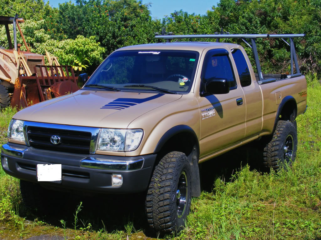

    I'm about to (hopefully) get a set of hood decals to put on my truck. The ones pictured here on Konaborne's
    I was wondering what do I do about it when it comes time to polish and wax the hood? For the record I am going to buy a Porter Cable DA random orbital kit.
