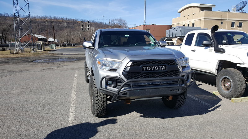

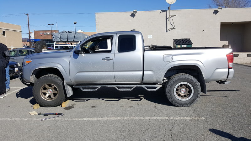

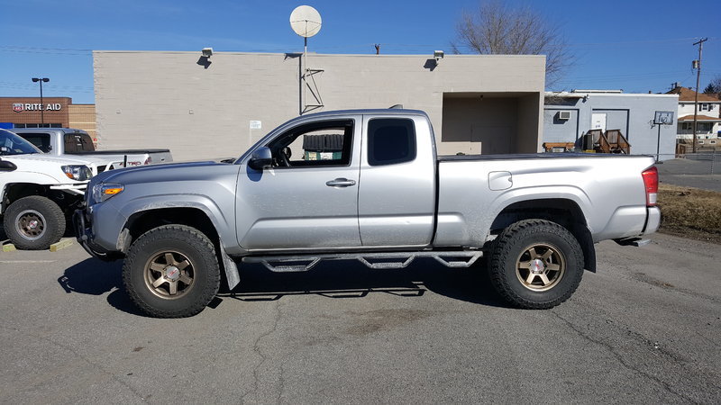

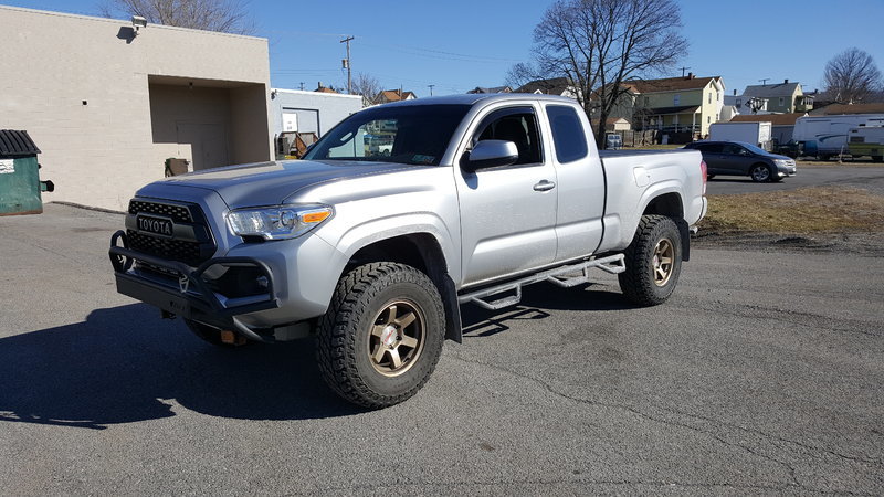

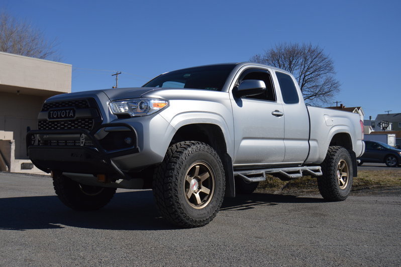

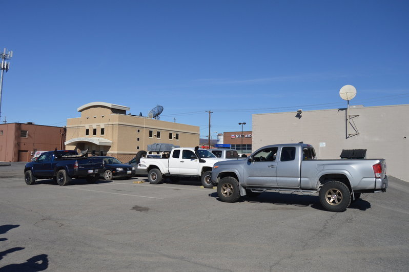

    Did you have to do anything other than a lift for the 255's to fit? That is a sharp looking truck, I have 265 75 16's now with an Icon lift. I didn't go crazy and basically stuck with the lift straight out of the box other than the left front I extended a tad to get the lean out. I would like to go 255 85 16 if I don't need to do a cmc or upper control arms.

    Ya you'll need a lot of plastic trimming and mud flaps wont fit on the truck and also you need to do a cab mount chop!

    Did you do new upper control arms or just stuck with the stock ones? Also, how big of a hit on gas mpg's did you take? Mine is my DD..

    I'm running Light Racing Upper Control arms from @HeadStrong Off-Road. Didn't loose too much on the gas mileage. I average about 18 ish city and 21 ish highway. Mine is a SR 4x4 4 cylinder 5 speed!
