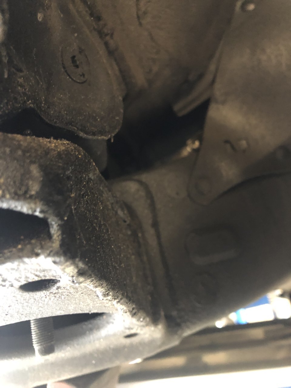

    IMG_2103[1].jpg I do have a Pro and I do run 285/75/16 duratrac's they are 33.1" I did have to do the CMC and I have done a little heat gun to the liners, I have not needed to flatten the pinch weld yet, I may in the future. Yes I do take the truck off road and I don't baby it
