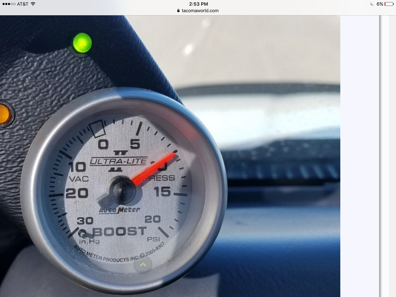

    How does that equation work with 10 pounds of boost I'm curious what the difference would be

    At 10 psi boost the cfm intake for a 3.5 L engine at 6000 rpm would be approximately 45% higher--510 cfm or so--about the same as an n/a 4.6 L engine at 6500 rpm (something I am intimately familiar with):

    Excellent to know, my motor is a 3.4 so pretty close then to that number, 45 percent more air! that's actually ALOT more than I thought, thanks
