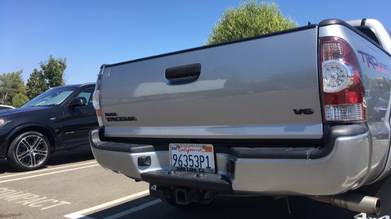

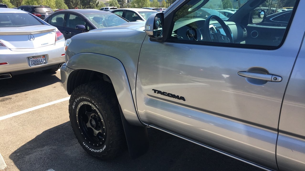

    1. Taped them off
    2. Flossed them off with fishing line. Rubbed off the goo from the truck and back of the badges. Sanded the badges (and also the back of the badges to get rid of any inconsistency in the surface from leftover goo)
    3. Automotive Goo Gone for the leftover residue on the truck
    4. Sprayed 3 coats of flat black paint (metal/plastic/etc 2-in-1 paint + primer spray paint)
    5. 3M double sided tape on the back of the emblems
    6. Re-apply using the tape for reference
    I got my TRD badge and sanded it & sprayed it a few times and stuck it where the V6 badge was. The V6 badge looked pretty much exactly the same after 2-3 coats of satin clear coat, so soon i will be removing all of them again and clear coating them with the satin clear coat before I stick them back on. They look good now, but they will fade faster and get scuffed more easily without the clearcoat so I am gonna just do the work and clear coat them in the next few weeks.
    I recommend a heavier fishing line like 20lb ocean line. It's gonna snap sometimes but it's honestly not bad.
