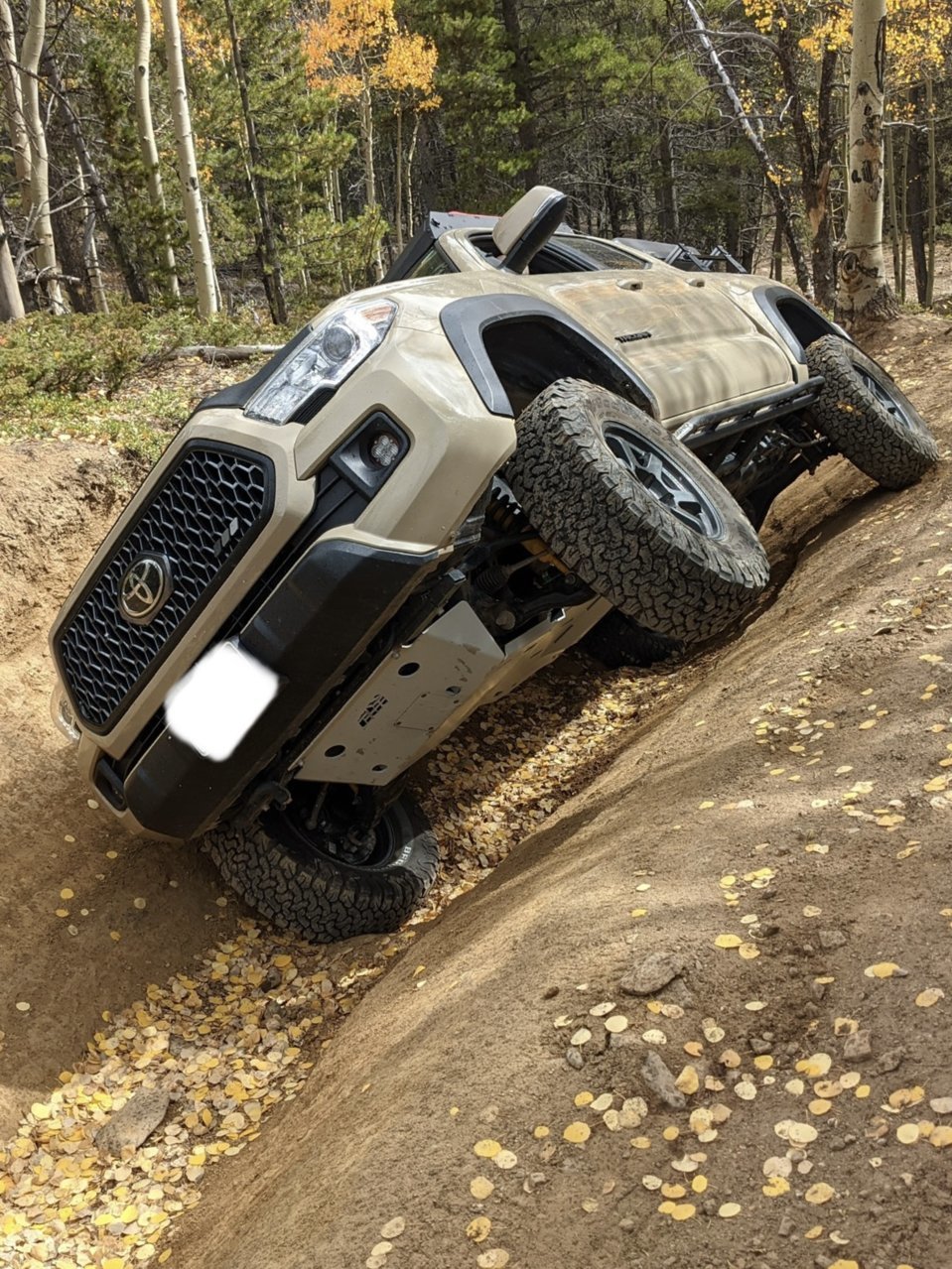

    Roof racks will substantially increase your risk of rollover.
    I ditched mine after a close call and just LineXed the roof instead and added tie downs to the bolt holes. Also got a winch, lol.

    So does taking bad lines.

    Indeed. That’s assuming you can see the line. In this case, I couldn’t see the drop off to my left, which was the juncture with another trail. I was going uphill not knowing another, lower trail was joining from my left, and I slid into it. The picture only shows the lower joining trail, not the higher one I was on, which is out of frame on the right of the pic.
    This means the truck had actually slid laterally about ten feet from out of frame on the right. The picture really doesn’t show how steep it was. This is sloping downhill away from the camera quite a bit.
    Right after the rescue, a Jeep Rubicon did the exact same thing here. Sometimes the bad line picks you.
    Edit, here it is corrected vertically against the trees.

    100 lbs on the roof is a lot, FWIW, and could dramatically increase rollover chances.
    I go off-road a lot in mountainous areas of the west and have been for over a decade. It’s not always possible to be be perfect. Nor is it possible to know every trail. Point is, if you prioritize off road, especially in new unfamiliar places, think twice about roof weight.
    Oopsies happen if you do this long enough. In this pic I screwed up, but it was a very deceptive geometry going on. In this situation it was through my actions that I prevented a rollover. There was zero damage to my truck thanks to the slider, which caught the ground.

    Please read the follow up. That’s not a chosen line. The truck slid down from a different trail out of frame.
