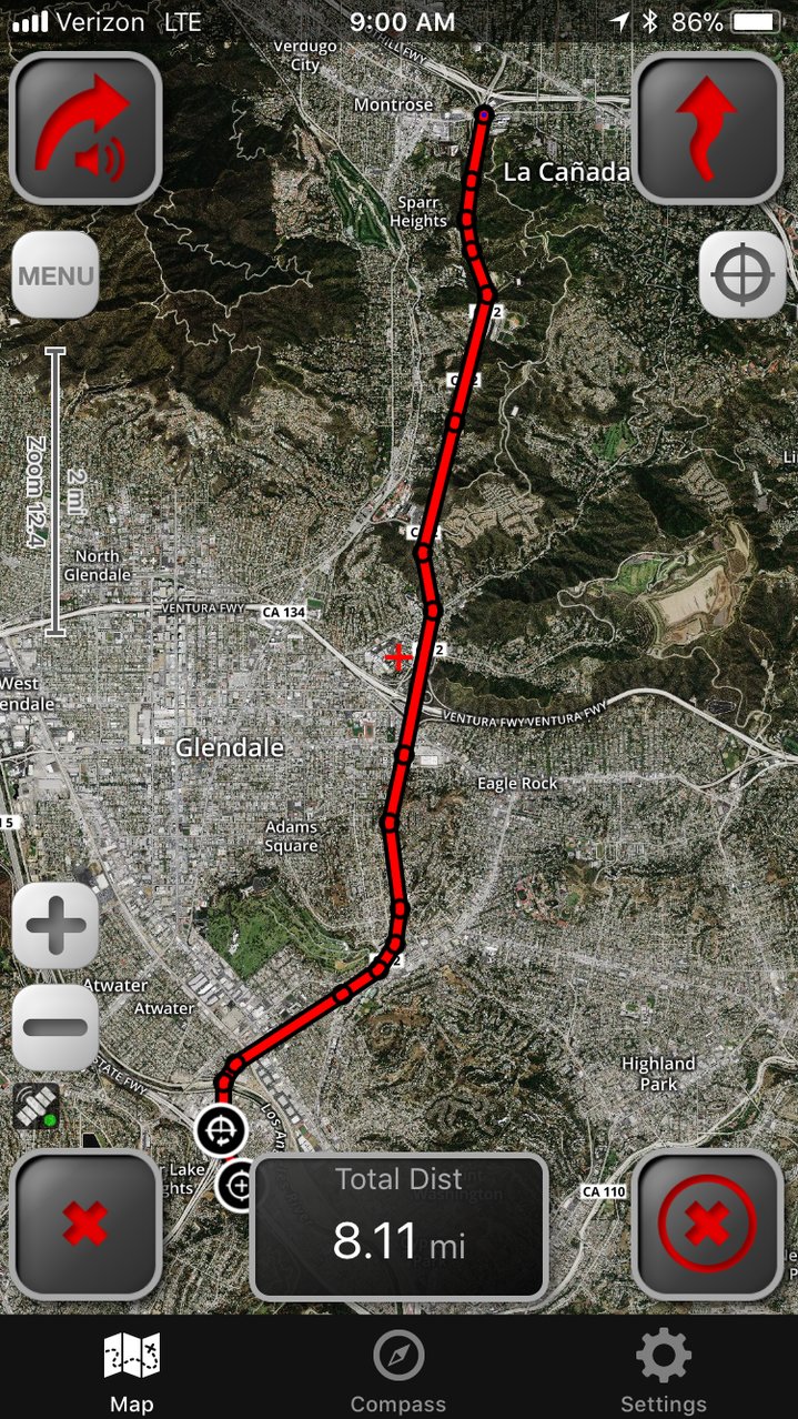

    2 to 4000 miles stock
    4,000 to 34,000 Shift sence pro
    34,000 to 45,800 102c shift A mix of 91 and 87
    45,800 to 46,359 103 87 octane

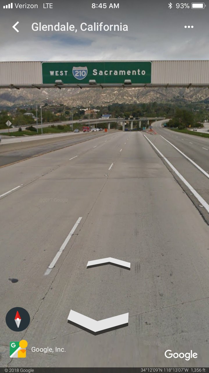

    I’m just going to give an example of a climb out of LA north bound on the 2 freeway. It’s about a 1000 ft climb in 8 miles.
    Stock in D with ECT OFF the truck would go though around 12 downshift/upshift cycles 4th to 6th.
    SSP I would use S4 and climb the hill and shift to D at the top.
    102c D ECT ON intitialy would hold 4th gear all the way to the top with one down/upshift cycle. After a few weeks of learning it resumed the multiple down/upshift cycle forcing me to use S4.
    103 D ECT off held 5th gear to the top. I was able to vary speed by 5 or more mph using my foot without it shifting. This was the best the truck has ever done climbing the hill. Power felt great without having to drop to 4th to make the climb.
    Only time will tell if the learning has been killed, but it feels like it has. Truck is starting to be predictable for pedal position and anticipated engine power output and gear selection. Needs a few more weeks of testing.
    Mileage of the climb.
    Start of climb with EL-373ft.
    Top of climb EL-1353ft.

    NICE! Good to see this result on a good highway climb with REGULAR 87 fuel too as know many are looking to tune but don't want to commit to an extra $10-20 with each fill-up!
