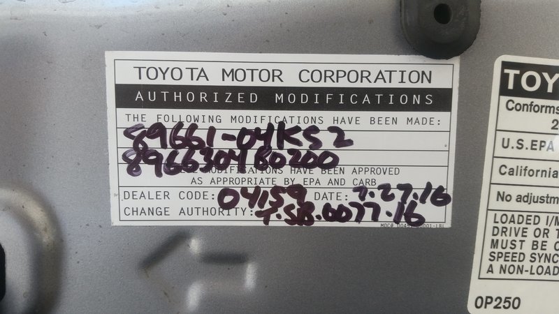

    A bit off topic. However, do your stickers only have 2 codes on it? My service representative had gone home when I picked up the truck the only thing I was left with was a sticker and the keys. I want to make sure all tasks were performed. I know there were 3 issues but only have 2 codes on the sticker. Anyone else have a picture of their sticker? Does it look similar to this?
    REDNECKTEX and taco 16 like this.

    I didn't even get the sticker but can promise you my trans was updated. It's one software update not 3 separate ones.

    Awh! I gotcha.. I thought they had an update to address each issue. So it was just one that covered all three bases is what you are saying?
