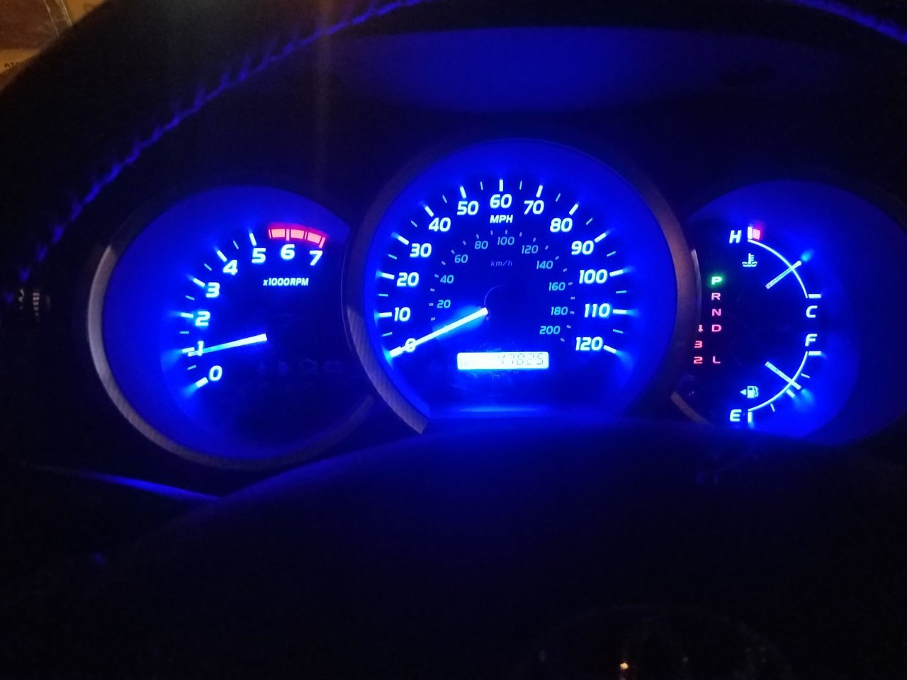

    It's up to you but I did blue, let me tell you this is a pain in the ass to do. But the end product is rewarding. I know this is a first gen section but am sure it's the same deal.20170307_210444.jpg

    The hardest part was finding out which way each led goes in on because if one led is on wrong then 3 or four less won't work. And when you install them they will automatically work with your dimmer.

    How can you look at that? My eyes hurt looking at that blue

    The brightness was all the way in that pic usually don't have it that high. Plus the blue is nice on the eyes of was better than the bright orange that was originally in there.

    1st gen is just twist on bulbs
    2nd & 3rd gen are Leds on the boards that require soldering
