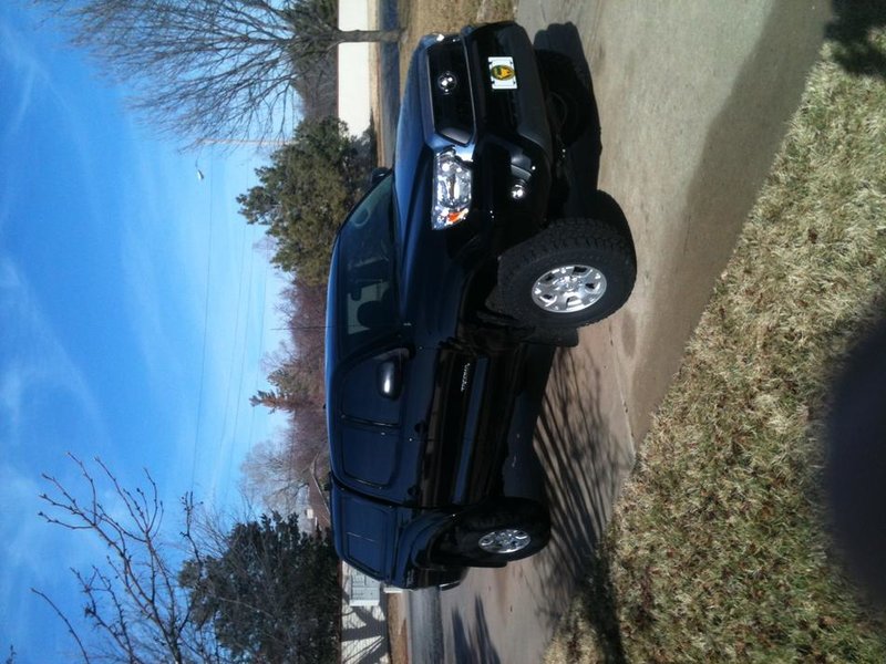

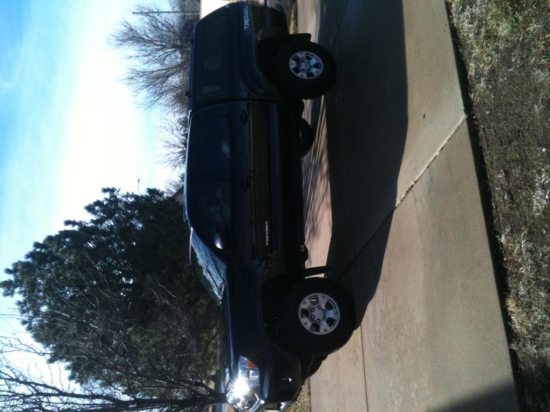

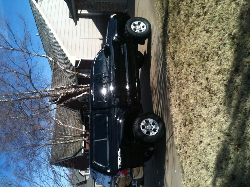

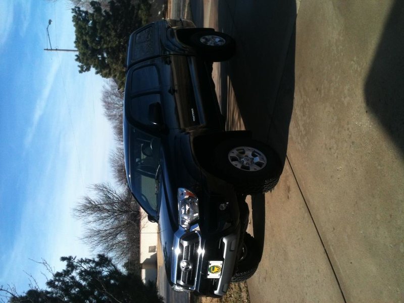

    Finished the lift along with new tires and an alignment this morning. I will point out, unless you use spacers (I am opposed to using) or buy aftermarket wheels, 285's will not fit without rubbing the spindle, there is about a 1/2" with a 265. Seeing how I recently added a cap, complete lift with leafs and UCA's, new wheels are not in my near future. I think the truck looks better with the meaty Cooper ST Maxx 265/75/16's which are an inch larger in diameter but the same with as a 265/70/16. In a couple of years when these are shot, I'll likely go 285's with wheels.
    And why my pics are all sideways I don't know!

    Lookin good OP :thumbsup:
