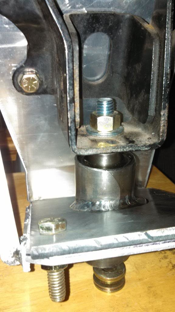

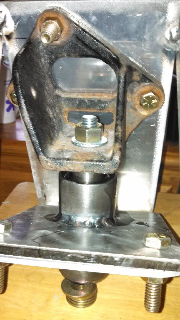

    Motor mounts are in the test vehicle!
    Only ran into one small issue which I seen coming and was already planning on fixing anyways. Since the metal was so smooth the poly didn't have a good grip and seperated.
    so a couple groves cut into the mounts will take care of that. And give it a nice bite.
    The first thoughts are promicing.
    Little noticeable difference in vibration and noise
    Throttle response seem to improve
    Shifter doesn't "flop" around so much
    So far troy (test subject) likes them and says its def an improvement
    He will write a full write up on them in a few days after he drives the truck some more.
