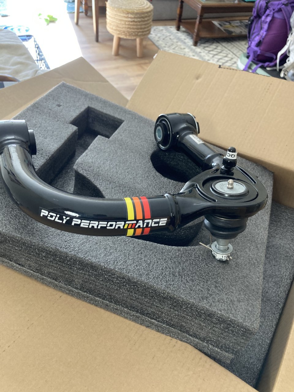

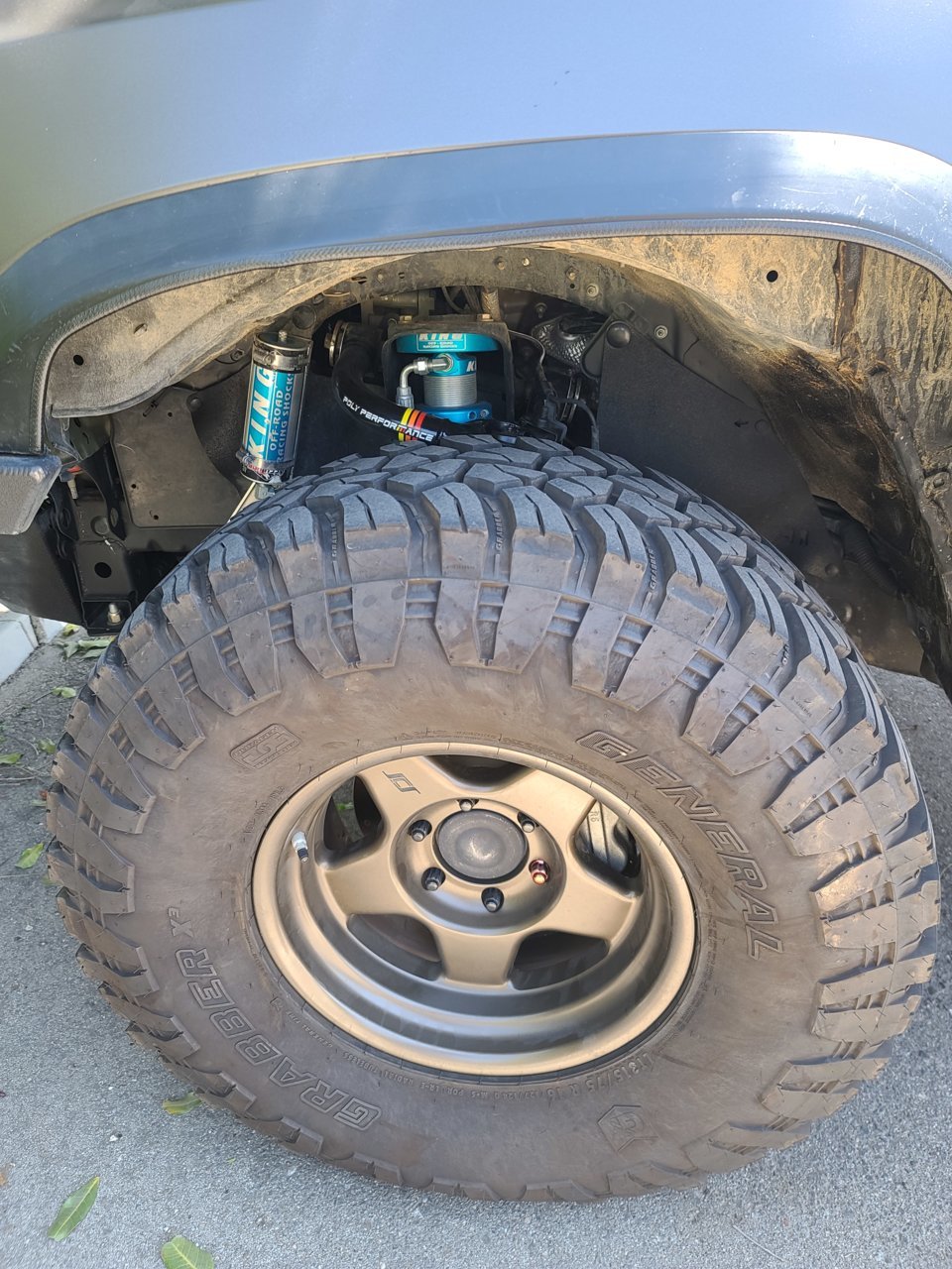

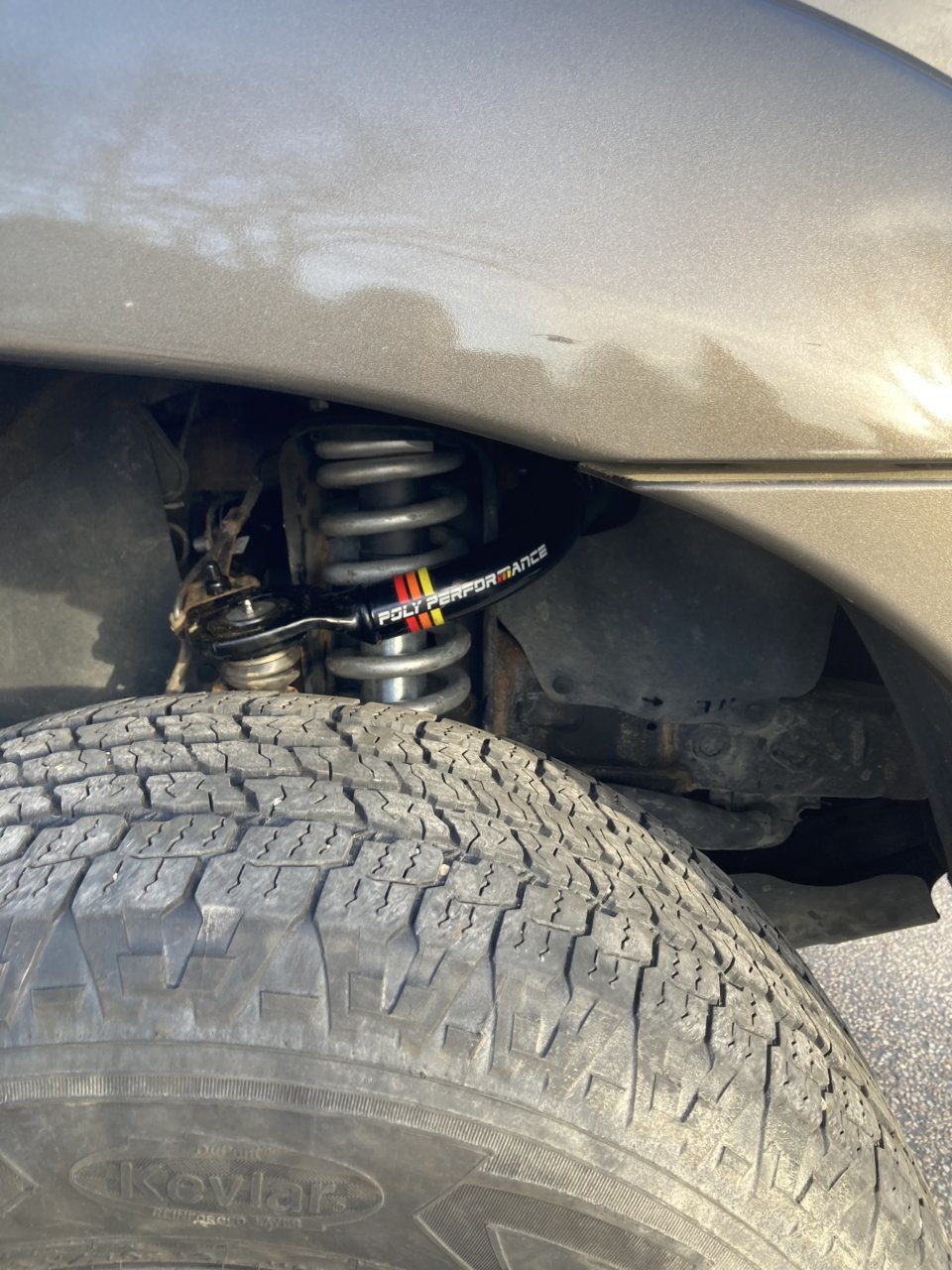

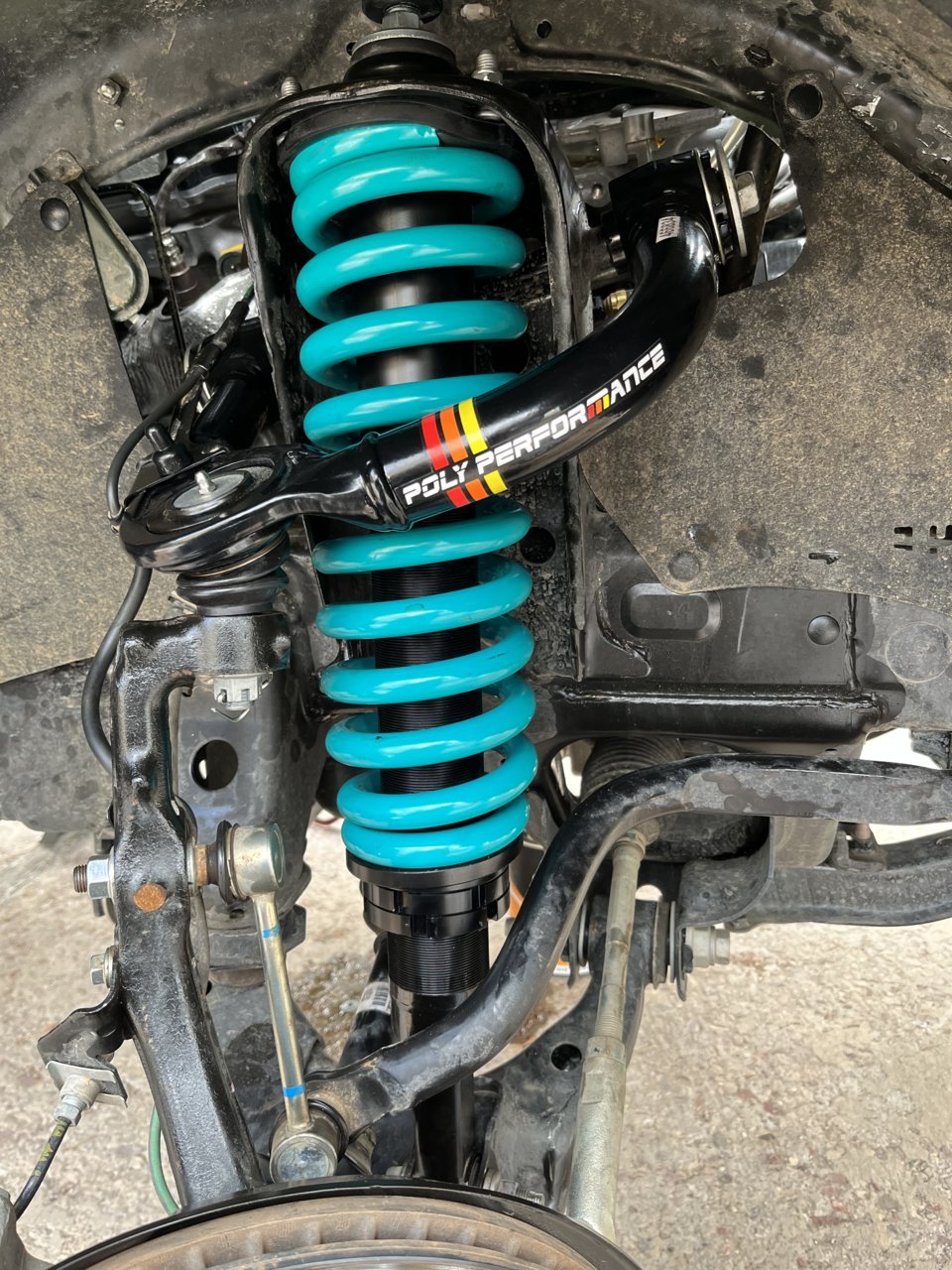

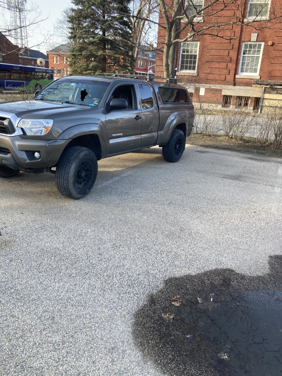

    963E3DD0-9D70-45A7-9229-206ECF420A56.jpg D14CF1D7-9CA7-47D2-BE98-EA1077F08E30.jpg 3BC4FA0E-3CD3-41FD-881A-95D2A15C9E33.jpg 3E6A49DB-02F3-4480-8CF0-EC85BD34B623.jpg Just installed mine yesterday, getting it aligned this afternoon, I'll update after that is done.
    I went with the Polyperformace vs. other brands because I don't need crazy off roading ability or tons of adjustability. I go down some pretty bumpy class 4 roads to get out to rock climbing and hiking, but no real wheeling. I don't plan to get bigger tires than what I have (265/75/16), so rubbing shouldn’t be an issue. I got these UCAs for $420 shipped after applying a first responder discount code. I was on the fence between these and the JBA, but the $80 difference swayed me.
    Install was fairly straight forward, there are tons of good write ups on here which helped a lot. Getting the long UCA bolts out was the biggest pain in the ass. I didn't have to remove the battery, but did have to remove a 10mm bolt holding a wiring harness on the driver side. The passenger side I couldn't bend the pinch weld enough so had to tap it out using a punch and scrape the bolt head over the metal. It took a while but it went. I bought new bolts for the UCAs, but not washers so I reused my old ones. In retrospect, I should have gotten new washers too, just to make everything new and shiny. All in all took 5 hours, probably could have gone faster but had to put things away and take the dog for a walk after hour 2.
    The new UCAs are pretty sweet looking, quite beefy. I installed them with 5100s and the toytec 2.5" coilovers. I was in a hurry to get the job done before the rain so didn't take pre-install pictures. I currently have a Headstrong AAL in the rear, with the overload removed. Going to install the Dakars next sunny day we have. Im looking to get it level, maybe a slight rake. Right now its a little squatted looking, hopefully it'll settle in the front.
    im psyched to get it aligned and see how it drives!
    banditcamp and 3TMaverick like this.

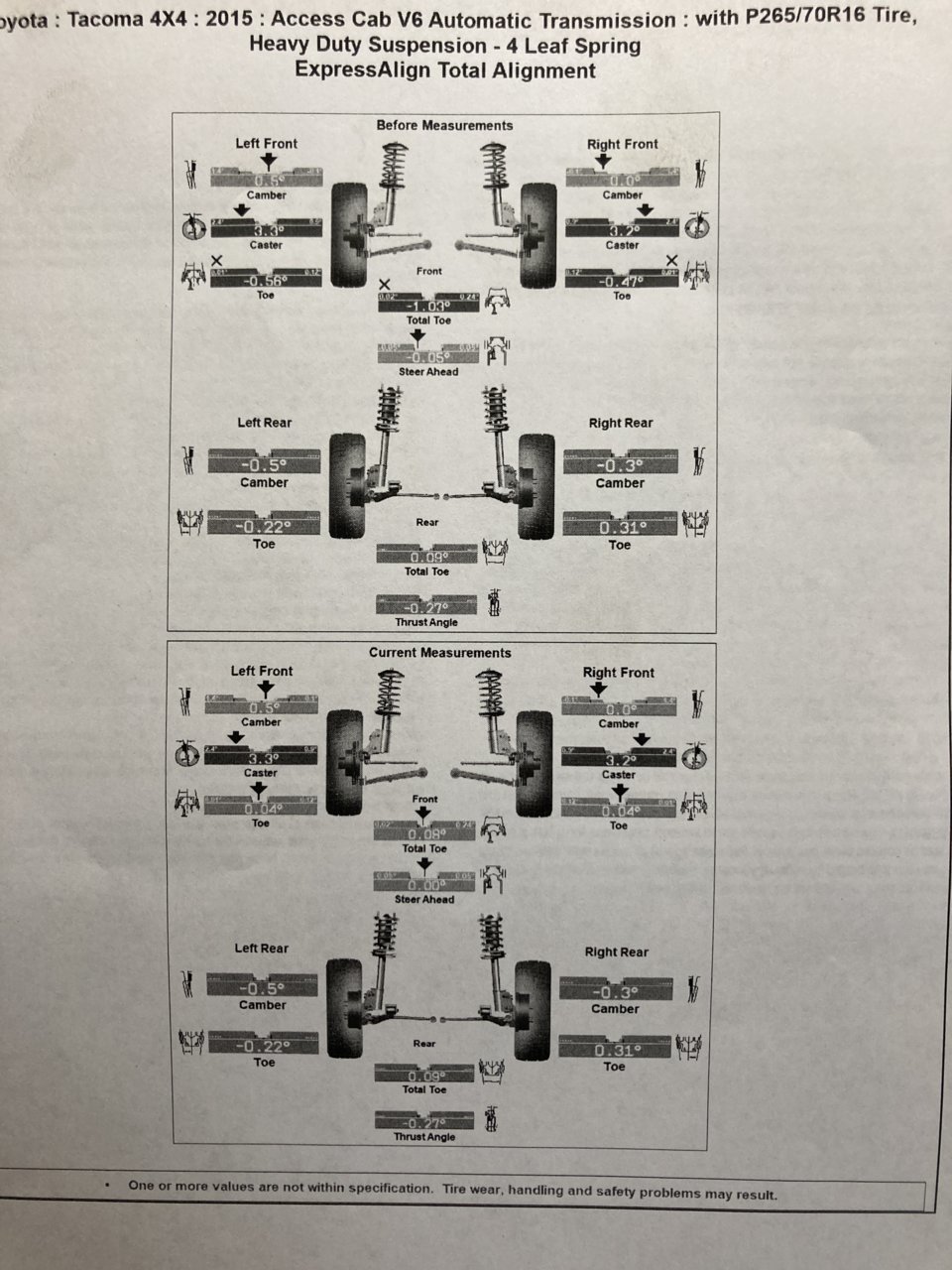

    Alignment numbers with thr new set up. Pretty nice that it landed right at 3.2 of caster. B8AF090A-12A1-44E2-80A2-7698901A1135.jpg

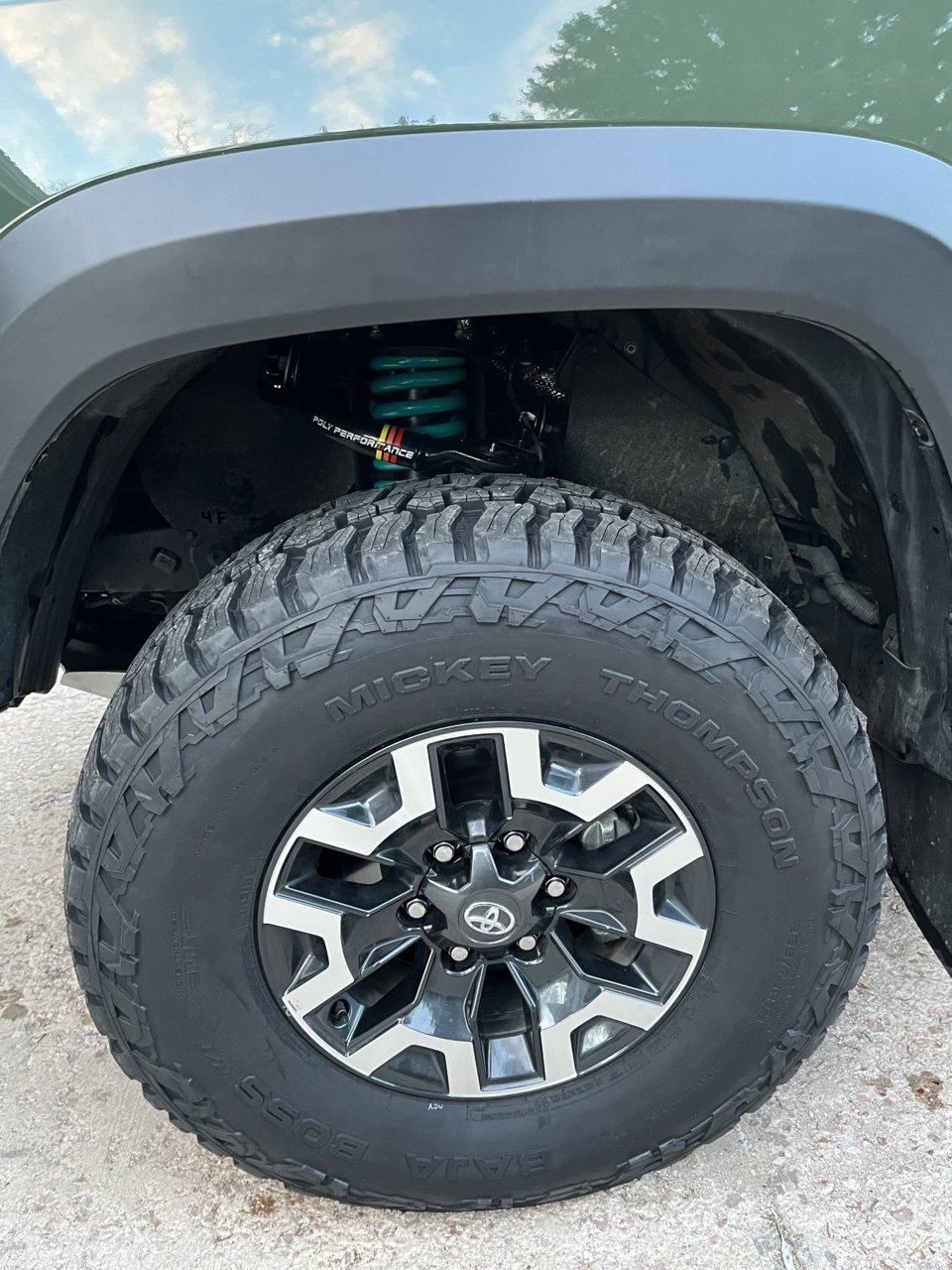

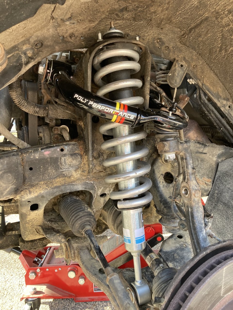

    went with these because they were such a good deal with the promo code
    6621DDD0-0885-4E79-ACCA-0322BEB287D6.jpg 3A1FBAA8-D6F7-4295-9DDE-1D0AA2BF806E.jpg
