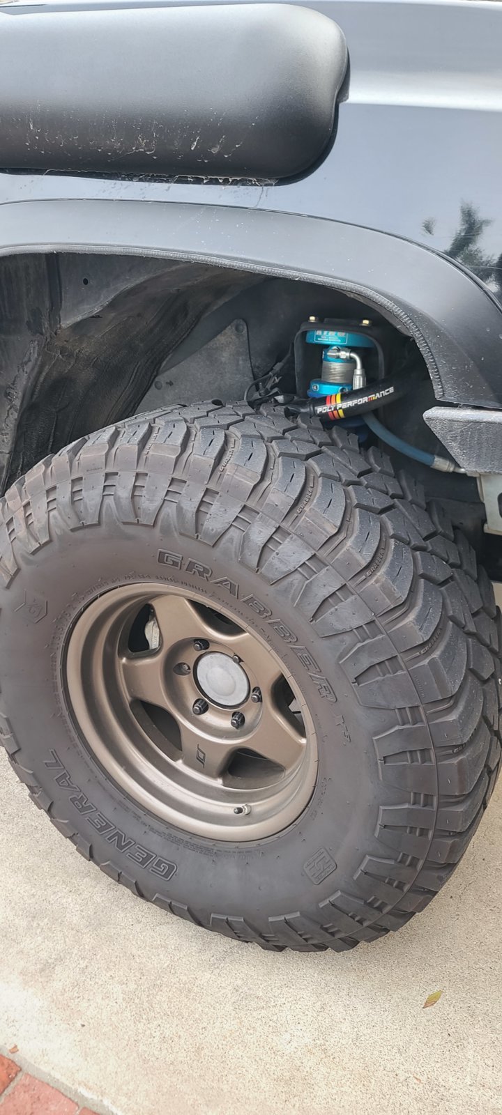

    I have -25 wheels and 315/75/16 tires with a bmc still rub at full lock when I hit a big dip. I recommend a BMC before a UCA if clearance is the main issue.

    Any reports of tires rubbing the UCA running 285/70-17s w/ 17x8.5s 4.75 BS? Had to use wheel spacers with the JBAs.

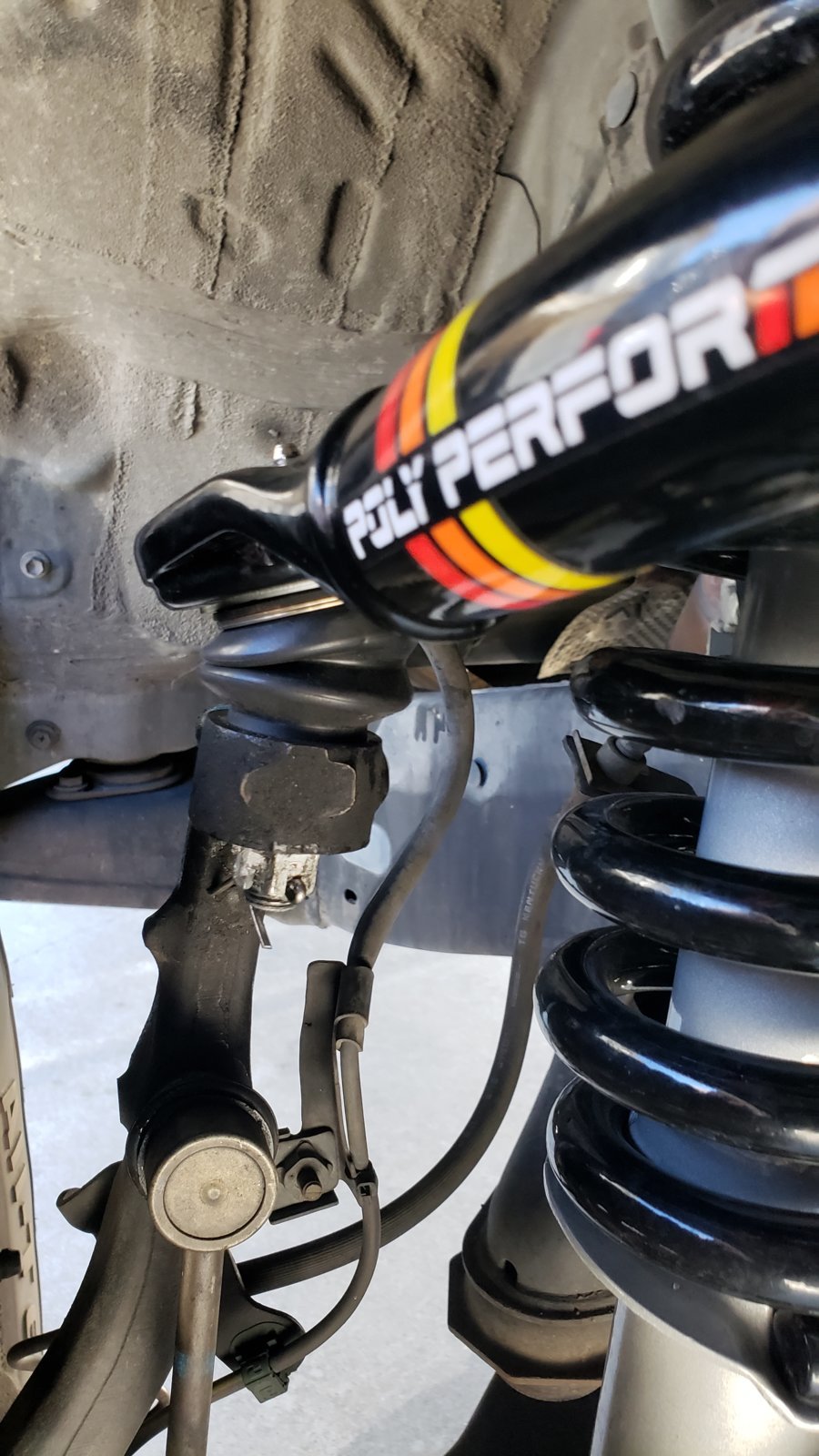

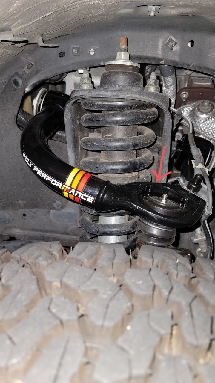

    Does anyone know if there's slightly different models or different generations of these arms? I ask because the pics dsp 8 and Puga posted, have arms where the ball joint appears to be at a more exaggerated angle than the arms in the photos of Taco Hungry and Jack Bates. Puga and Dsp's photos appear to match the pics currently on Poly performances website...

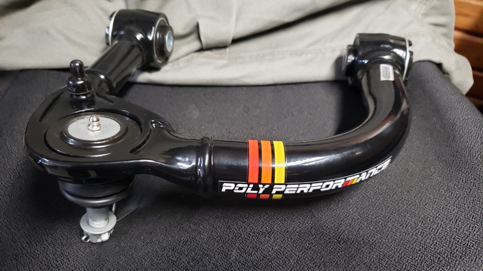

    I found these currently 30% off a few days ago and they shipped and delivered in about 48 hours. I was feeling pretty excited except the box they are in says "2 inch lift" where the website says 1-3" of lift. When I unboxed them, I found they have the less angle on the ball joint, similar to taco hungry and Jack bates' arms.

    To clarify what it is I'm referencing that raised the question, see the pics below and the difference between DSP's uca vs. Mine. Dsp's has measurable amount of steel above the ball joint on the spring side where mine appears to sit more flush in the cup. To me, it seems like Dsp's ball joint is at a better angle to sit level on the knuckle, maximizing ball joint articulation. Maybe I'm way over analyzing it though...

    I was actually referring to how the balljoint sits in the UCA before its installed... I finally got around to installing them and the good news is that they gave me about 2 degrees of caster so my alignment is much better but as expected, the angle in which the ball joint is pressed into the arm is not significant enough to offset the droop at ride height associated with a 3" lift and therefore leave my balljoint well past vertical, yielding limited downtravel.
    These also hit my coil when going over speed bumps.
    I dont mean to sound like I'm bashing the product because they do seem extremely well built and accomplished my alignment correction which was my primary concern. However, I feel like they are probably better suited for less than 3" of lift.
