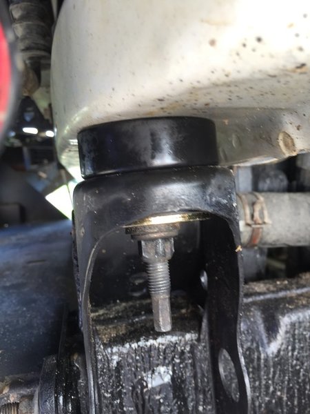

    Finally installed mine right now. Passenger side went in no problem but the driver side was a bitch! The bolt was off center it took a lot of pry bar action and fenagling to get the bushing to seat right. I did big bushing on top. Truck feels real solid now

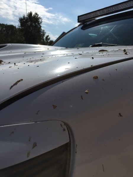

    So I installed these a little while back and just noticed today that my hood flutter seems to be gone.
    I put them in with the thinner bushing on top.
