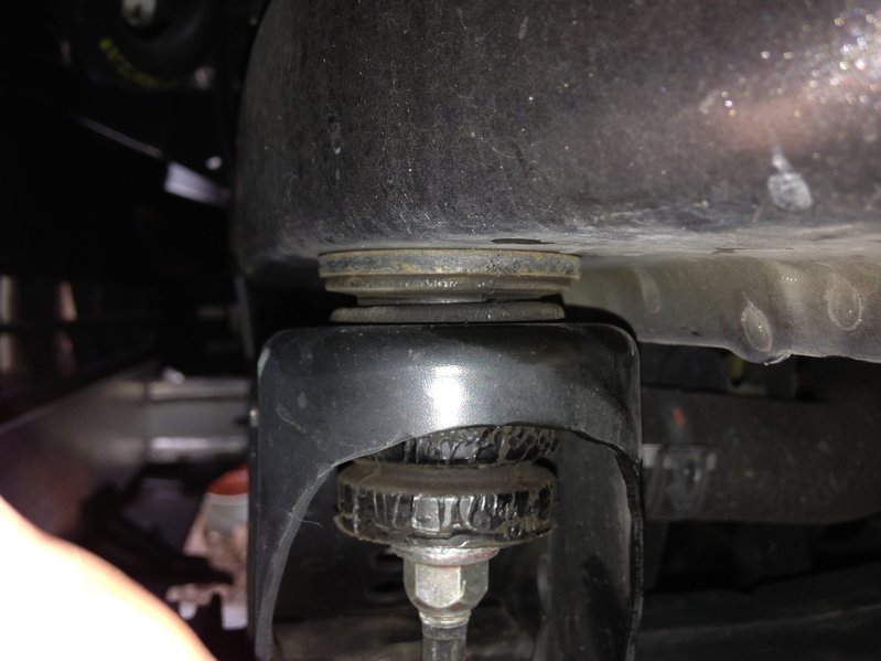

    they didn't look too bad honestly.
    they looked fine on the outside.
    I think there's two things that make them look so bad in everyones pictures.
    1. the top one has a thin piece that goes through the metal hole. I'm sure that's torn within 50 miles of leaving the factory and if it isn't, it's going to tear when you take it out.
    2. the metal sleeve inside gets corrosion and looks bad
    There's definitely a huge difference between what's on there and what these are in material composition alone. You're replacing super soft thin rubber with a much harder solid disk.
    I don't honestly know if that's bad or good. If no movement at that connection point is good, then why a bushing at all? On the other hand, the stock rubber is so soft and flimsy that I can't imagine there being much difference between having it in there or having just the inside metal sleeve.

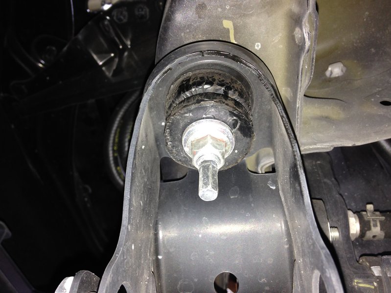

    It's been mentioned many times before. The damage to the soft factory rubber bushing is on the inside. They'll be torn and stretched.
    Toyota stock rubber radiator bushings are garbage.

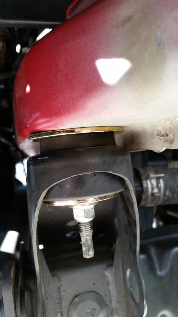

    Mine bushings have been f'ing outstanding since I put the big one on top.
    For those that like the smaller bushing on top, I like what @AaronArf did with his. No extra washer needed.
