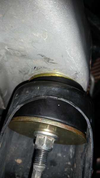

    Doing it this way is one good way of avoiding unnecessary metal to metal contact from the frame to the washer. There's always more than one way to skin a cat right?

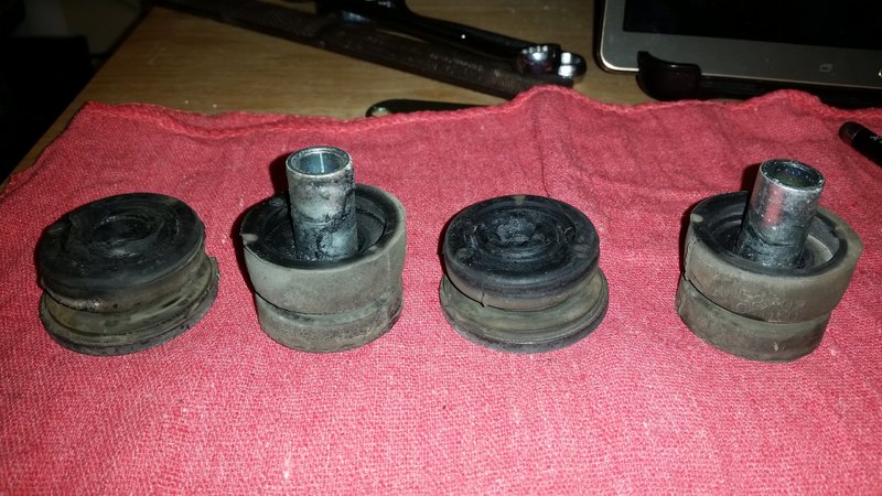

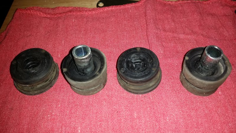

    Got off my ass and got this done tonight.
    OEM bushings were in good shape
    But I like the firmness of the new bushings. No test drive yet.
