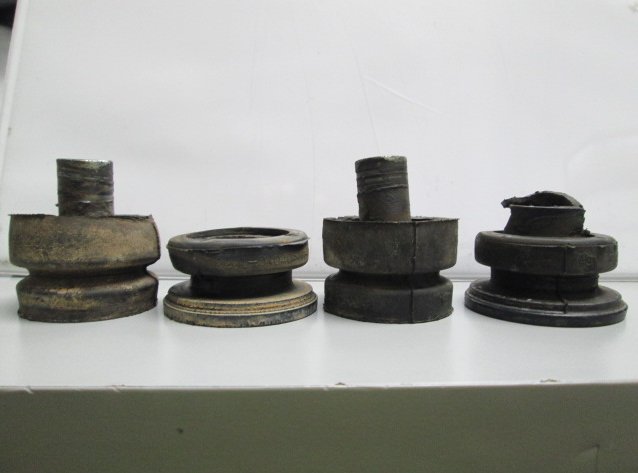

    didn't take photos last night when I had the wheels off, so this is the best I can get right now on the ground. drivers side

    Yeah those bushings are clearly two different sizes, I will post a pic later but my Taco specific ones are equal height. So, the question is if one of those unequal height ones is the same as the OE replacement one.

    the stock ones are also diff sizes

    Edit - look at the OP's #3 post on page 1. He bought the whole kit a week after the universal bushings and you can see in his picture of the kit that the Taco specific core support bushings clearly do not have the drastic size difference in upper and lower bushings.
    I mean this with humor.... But are they ? Or is it just that the top one crushes down so bad ?
    BTW everyone I do not mean to come across argumentative I just want to make sure that someone once and for all actually checks OE specs vs these universal kits to ensure what the correct measurement and fit is. Nothing against the OP but his truck is nothing to judge this off of because his core wall was so blown out and even cracked from jumping his truck. Just want to make sure that everyone understands you very easily tweak your cab if the parts are not correct. Tweaking the cab puts stress on things, misalignment body panels etc.

    not at all, input is welcome. it is hard to tell, since the OE ones are so fubar but the size diff isnt that dramatic, they went in with about as much force and finagling as it took to get the old ones out. I checked and my panel alignment seems the same after install (I did install mine the right way up and with washers as I don't have after market bumper so don't need the extra clearance). Also, I don't wheel nearly as hard as Roberto and look at mine. I don't have all the tearing of the metal core that he does, but my bushings are still fawked. I am optimistic about these universal ones, but if in a few months I don't like what I see I can change them out, they're not that expensive. happy so far

    Jason, Appreciate the dialog. My plan is to get the Tacoma body bushing kit in a few months and compare with the universal kit I already have installed.
    Just for my own edification.
    This thread is interesting in that it chronicles a lot of different people's experiences with trucks of various ages.
    And what was works for one person with their truck doesn't necessarily work for another.
    For example I had to hammer out my driver's side radiator bolt. I could not get it to come free. My experience was seconded by someone else in this thread. I think it was @Incognito
    I'm thinking that my core support has been deformed over time.
    I also noted the same variance in effort when installing just described by @teamhypoxia
    There are certainly issues with the universal kit most of what you already pointed out. I had significant issues with the universal kit and bigger bushing on the bottom. No matter how tight I made the joint that big washer would contact the frame making a knocking noise.
    I then flipped it so the bigger bushing was on top but I ditched the big washer.
    When I did this it tightened up the front end significantly so much so that I never forget it every time I Drive my truck. I'm still very impressed with how snug the front end is.
    I very much feel the same way that most people should probably get the whole kit body and radiator support bushings and just use that.

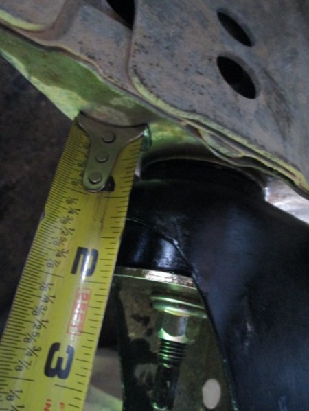

    definitely saw a difference between driver and passenger side, had to struggle more on the driver side and that one is a little worse for wear as well. haven't noticed any knocking yet but its only been a day. seems nice and tight so far
    another angel - driver side on the left
