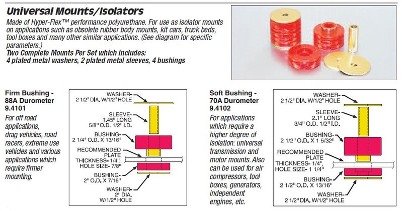

    Did anyone ever report the "new" installed height of the OEM rubber isolator part? The Energy Suspension catalog spec gives the sizes of the "firm" and "soft" versions of their universal mounts. The larger size of the 9.4101 (88A durometer) - turns out to be the smaller size of the 9.4102 (70A durometer). Maybe the smaller size of the softer mount would preload down to be a match.

  5. Dec 22, 2015 at 10:03 AM

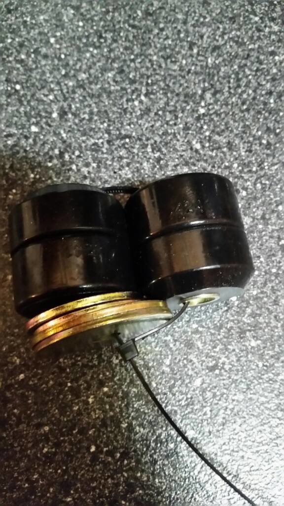

    Well, look what just showed up......
