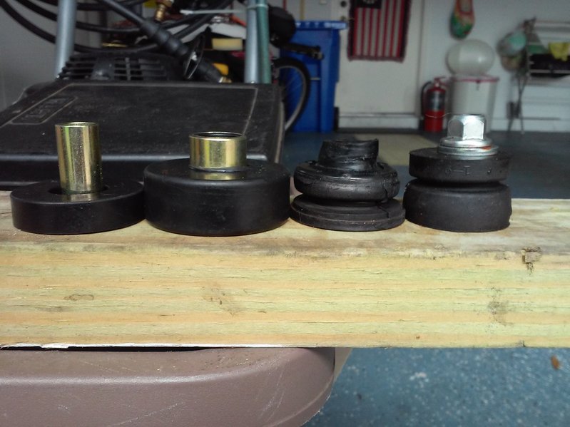

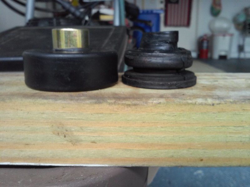

    I did remove one of the old bushings and compared to the new bushings.
    The old bushing installed did not have a washer on top.
    You can see how much bigger the new bushing is in comparison.
    My install is without the top washer on the larger bushing.
    Soul Surfer, 12TRDTacoma[OP] and Crom like this.

    Love the pictures! Thank you. If I recall correctly, the older bushing (I assume you mean the factory top one), had an integrated washer that was built into (fused) into the bushing.
    My ES bushings are installed the same way and I love what they have done for the truck.

    This. Install the washers up top @fla_sun the aftermarket bushings do not have fused washers integrated into the assembly like stock does.
