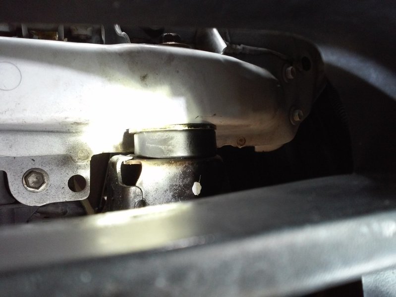

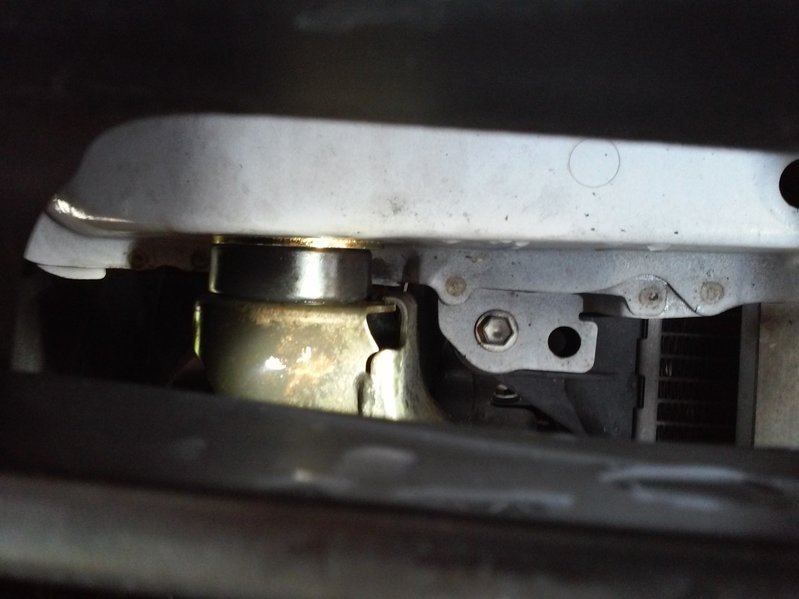

    OK washer on top.
    Something got bent it seems as the left side bolt went in at an angle and had to be slowly pounded in while I kept pushing the inner metal bushing up as it traveled down with the bolt. Anyway it is done.
    I thought I noticed the hood slightly higher than before but have decided could be my imagination.
    UPDATE: Just a word to the wise, I bent the radiator bracket when installing these. The left side bolt was not bent before I started. It is now.
    Proceed with caution.
    Crom likes this.

    Your radiator support is bent. Don't worry, everyone's is including my own. That's why your left side bolt went in at an angle. You can thank your heavy battery for that.
    If your hood is indeed sitting slightly higher than it originally was, just adjust the rubber stoppers one turn in. It should alleviate the height issue.

    Both bolts slid down easily before I started. Guess I bent the support when jacking up.
    The stopper adjustment worked for the hood.
    The creak I used to hear when backing out the driveway has gone. No other difference noticed.
    I was thinking of removing the upper washer but probably dont want to deal with the left side bolt.
