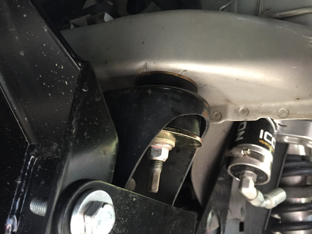

    Per Roberto @12TRDTacoma, I reinstalled my polys with the fat one on top. No change to hood fitment. Used a 2x4 and my bottle jack to gain enough clearance to insert the bushings. Simple.

    I see you used the smaller diameter washer on top of the larger bushing?
  11. Jan 10, 2016 at 4:24 PM
    #531
    Bman4X5
    Bman4X5 There is no substitute for square inches.
    Jan 4, 2015
    #145616
    1,072
    Bruce
    Upland CA
    '15 AC/OR
    Bilstein, Dakar/Icon, Prinsu, CBI, Pelfreybilt, Tepui
    Yes, and not sure why. In retrospect, the other way 'round would have been better.

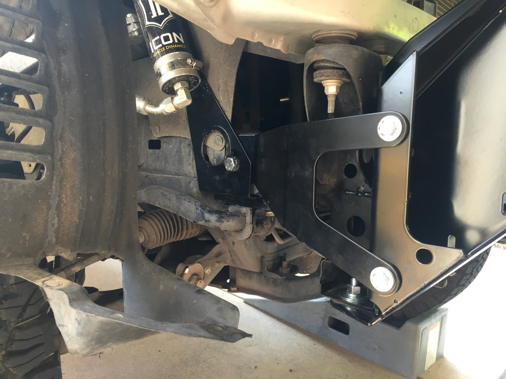

    Just installed mine. Starting with smaller bushing on top. Will swap if needed later. Also checked for sheet metal cracks like @12TRDTacoma, none noted. Mine is a 2005 with 136k miles. Done my share of off-road beatings on stock TRD suspension but not enough to cause that much damage.
    Used a crowbar to lift up and pull the old ones out. The ARB bumper bracket almost gets in the way but you can still slide an extension in there. It's a tight fit.

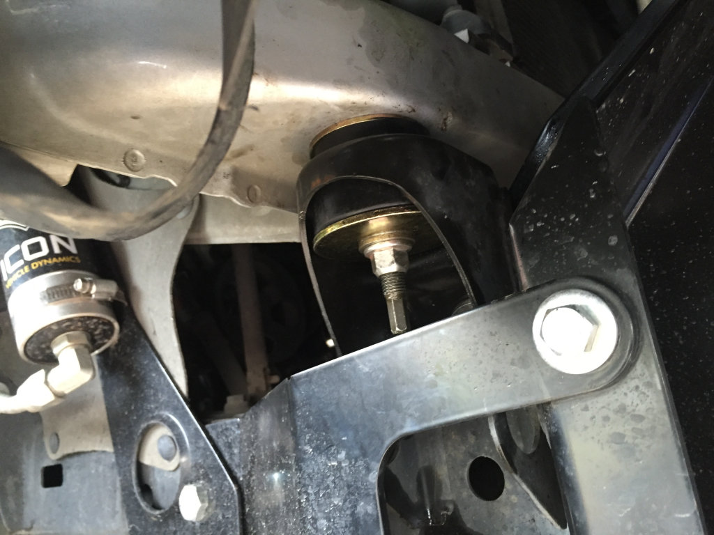

    Just installed the poly bushings on my 2012 today. Went with the bigger bushings on top without the washer , passenger side of the hood is ever so slightly higher than the driver side but managed to adjust the hood buffers to get it very close. The driver side bushing was a royal PITA, the bolt holes on the radiator support would not line up with the bushings. Turned a 30 min project into 3 hours with quite a bit of profanity. Any idea why the bolt would not line up? It was about 1/2" off but managed to pry it into place. My truck has 18K on it and has not been abused offroad or driven hard at all...

    Sounds like you worked way too hard to get it to fit.
    As I previously stated. It is because your support is bent, you may not have offroaded the vehicle or beat on it, but that battery nevertheless weighs 50lbs on the drivers side and you most likely have had to drive the truck some bumpy roads even if still on and not off road.

    The bolt still wouldn't line up with the smaller bushing on top, tried it a couple different ways but ended up muscling the damn thing into place. Had to tap the bolt through the engine bay to get threads showing on the bottom of the bushings. Next on my list is battery relocation ASAP, would free up some room for an OBA setup down the road.

    I also had to tap in the bolt through the engine bay side down with a hammer as well to make it all fit flush in there to get it to line up. Trust me, you and I are not the only one's who have had to do that upon replacing these bushings.

    I want to see better pictures of your overall support. Get in there with your camera and take pictures, if you can, behind the grille also right under the upper support crossbar. I found more cracking under my upper crossbar that I never saw before as I was about to install a new intake and it required I cut out some of the area that was already cracked.
    Also, do yourself a favor and install those washers. Those are really important to rest under the support crossbar, as without them, they can potentially warp over time with the movement the bushings allow.
