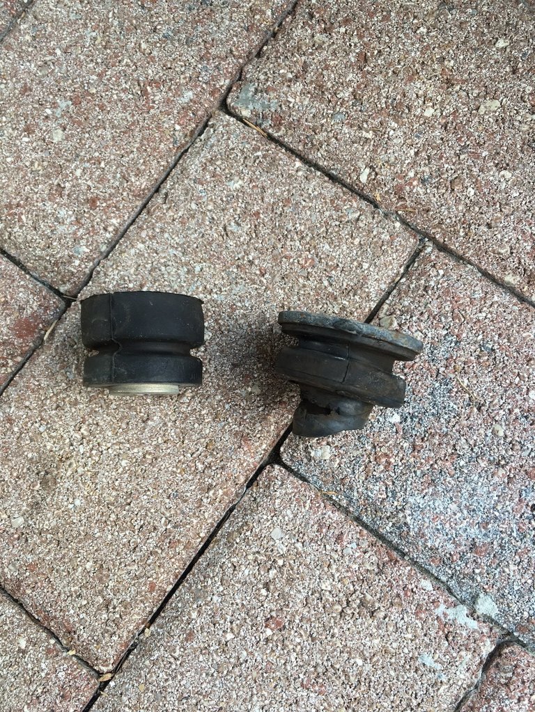

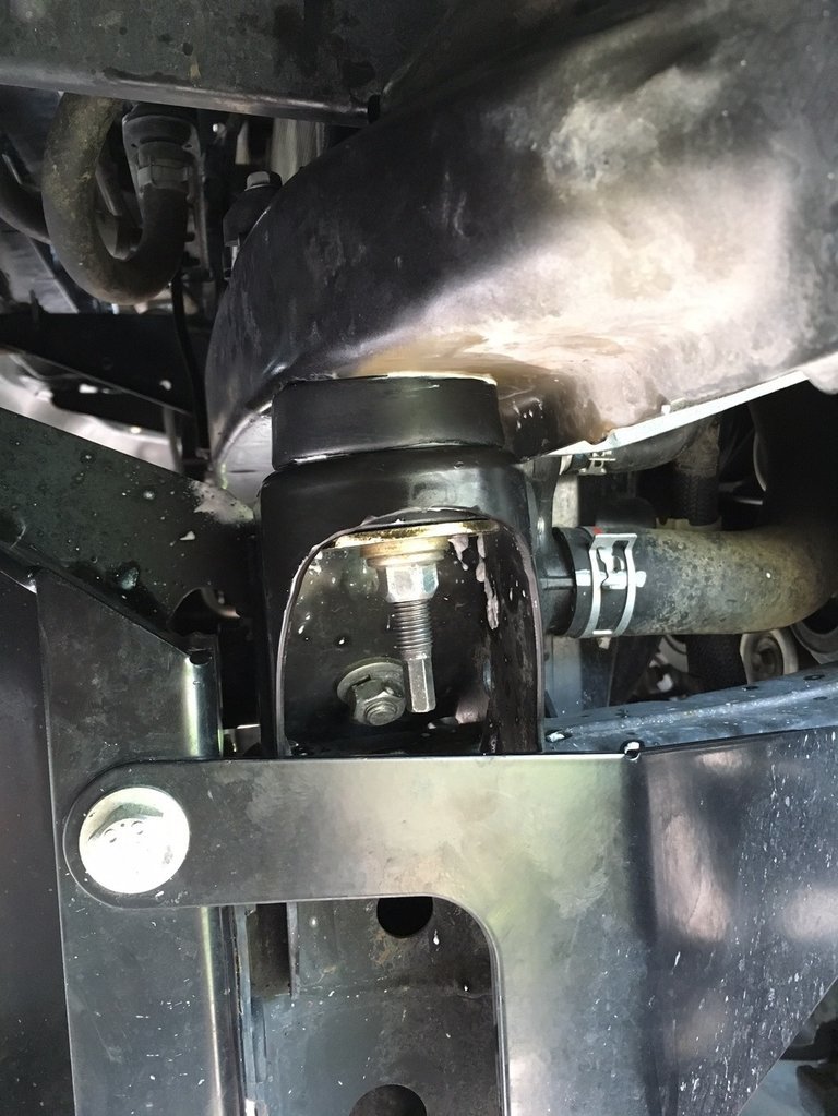

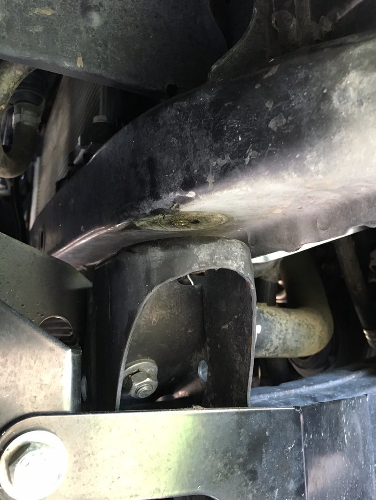

    Just installed the 9.4101G kit, very easy and fits nice and snug. Only thing is that I used White Lithium Grease, and they squeak like crazy. Any ideas on what I should do...? Should I have not used any Grease...? Here are some pictures, I installed the larger bushing up top and no washer as recommended.

    Do not grease the bushings. I confirmed this with both ES, and Prothane. Same goes for the body mounts.

    @Crom Ok, got you thanks my friend. What do you suggest, removed them and clean them with what...?

    Call ES support tech line at 949.361.3935 (7am-5pm PST Monday-Friday). and ask them what to clean them off with.
    Hard for me to remember what I did with mine, I originally used super lube synthetic grease. I know I took them out wiped them down real good with paper towels and maybe just put them back in. Don't remember using any chemicals.
