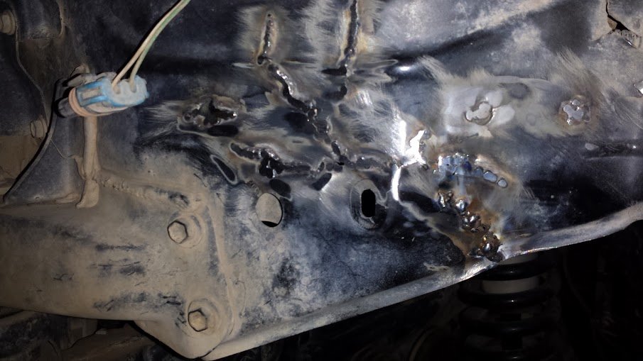

    Yup...above and below the "plug" (Really the cable clip, if you look where my finger is pointing on the pic I put up)
    I don't offroad as much as I'd like to but whenever I do, its all out. From crawling to bombing down fast sections...I also smash the gas at every speed bump I see at the mall. :bikewhoops:

  2. Apr 11, 2016 at 8:52 PM
    #642
    HBMurphy
    HBMurphy Ban Pending
    Jun 27, 2009
    #18993
    6,580
    Paul
    So California Coast
    09 Off Road Delete Model
    None
    MTopp and Crom like this.
  3. Apr 11, 2016 at 8:53 PM
    #643
    hoarder23
    hoarder23 Truck fell over
    Aug 14, 2012
    #84787
    12,884
    Shay
    NJ
    15 Pyrite Mica DCSB Sport
    Scratches
    The instructions that come with the 8.4109G kit are good enough, I did it myself this weekend alone in about 3 hours. Some lessons learned are to unearth the top of the body mount bolts first and don't put the cab back together until the very end. I did the drivers side first and put the rear seat storage back and then had to take it back out to do the passenger side. With a second body and doing it a second time I could probably do it in just over an hour. You could probably do it without taking apart the back seat as the bolt has tabs on it to lock it in place but I didn't want to lift that cab that far to clear the bolt.
    We still stop drill cracks on Navy airplanes
  4. Apr 11, 2016 at 8:54 PM
    #644
    12TRDTacoma
    12TRDTacoma [OP] Powered by Ford, GM, VW, and Mercedes
    Aug 20, 2012
    #85133
    16,671
    Rob
    Concordia
    12 TRD Sport DCLB 4x4 Supercharged
    Boosted
    Fuck....
    AaronArf likes this.

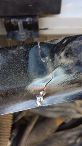

    Yep. But all stitched up and stress has been relieved so I am doubting I will see it again. :)

    Depends on the metal, location and aircraft. A titanium firewall will be left alone after its drilled. Helicopter skin panels will be patched next time it's convenient. Cracks in jets usually require digging. We wouldn't stop drill a crack in a structural piece without an engineer buying off on it, but then most structural pieces are solid titanium.
